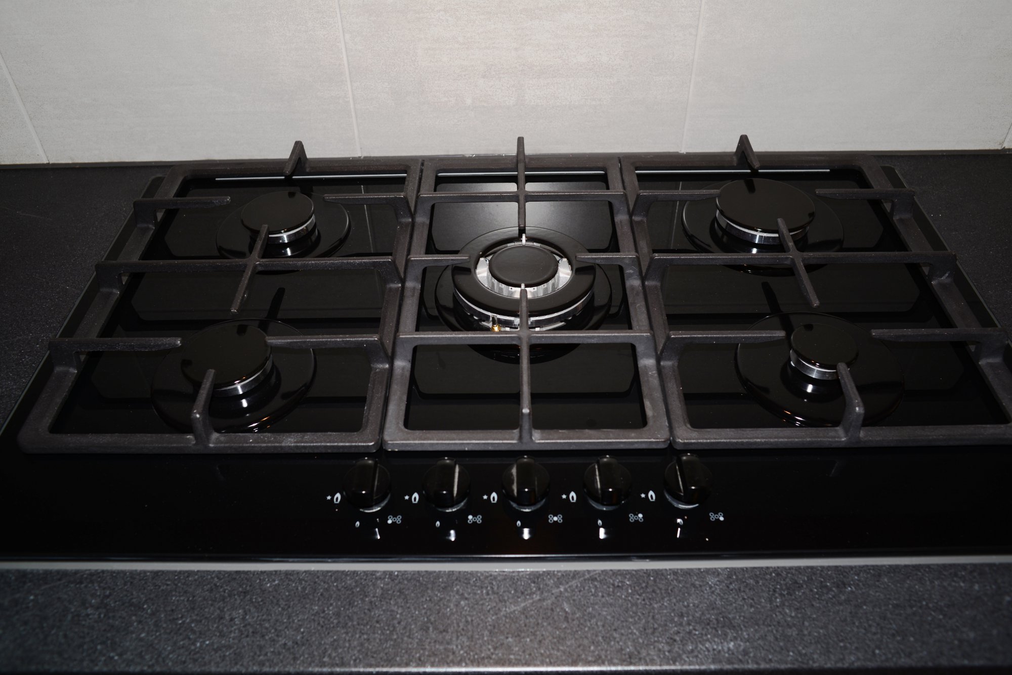

About 9 months ago I bought a gas hob that could run on natural gas or LPG, and took it down to the moeypit in France. It was fitted into the worktop last October and I made the final connections between gas bottle and hob when I was down there last month. The bottle was a 3/4 full one that we'd been using previously on a freestanding cooker and the regulator was similarly a known good one.
Having connected the hob to the bottle, I turned on one of the burners and hit the ignition button. Nothing, rien, zilch, nada. I tested the connection with a hand-held gas leak tester and not only was there no leakage from the hob to bottle joint, there was clearly no gas being emitted from any of the burners.
I disconnected the bottle from the hob, fired up my portable compressor and shoved the blowy nozzle (technical term) up the inlet elbow, switched all the burners to full and gave it a dose of compressed air. No air came out of any of the burners.
I even undid one of the jets, switched all but that burner off and tried again. No disturbance in the Force could be felt.
So - what could be blocking the passage of air/gas from the inlet to the burners? Do new gas hobs come with a blanking plate installed that needs to be removed? Or could it be a malfunction with the flame failure security device that is shutting down the supply at some point? Or is the hob kust plain faulty?
Any suggestions/ideas/hints/tips gratefully received...

Can't check right now, as I'm best part of 1000 miles away, but it's one of the things I'll be checking when i go back.
