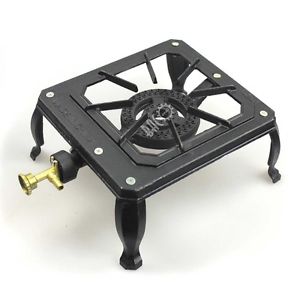

@Parm the only one that looked like that had a camping gaz fitting on it, do you know if the burner has an injector fitted and any air ports or if it does need an all in one unit?
The injector is all in the brass fitting. Air intake is an opening in the cast body of the unit. It’s regulated by a sleeve that rotated around the opening
