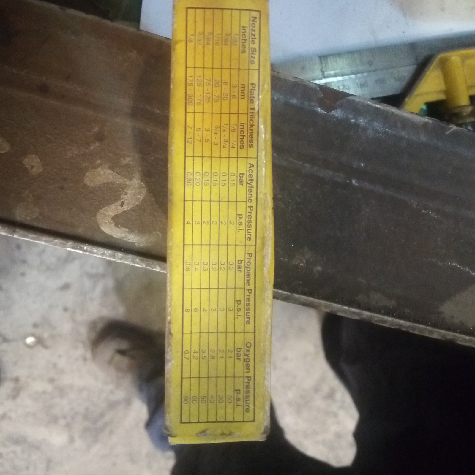

Every one I work with wacks so much oxygen and leaves such deep gouges out of the material don't get me wrong I've had it and done it and not had enough to cut through and left a mess but anything from 30mm to 50 mm thick I can cut quite well and the lad I worked with had this in his box. This is for propane oxygen cutting
