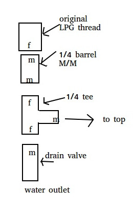

As some of you may know the tap thread is not a standard one, its below 1/2 but bigger than other sizes, so my plan will be to simply re-thread that brass valve with a 1/4 thread. a question about this, what kind of drill bit I have to use before I apply the 1/4 tap? I have a threader set and already did other threads but never a 1/4. In my threader set I got the drill bit for M12, which is 10.5mm, is that any good for the purpose? alternatively I have an 11mm one.

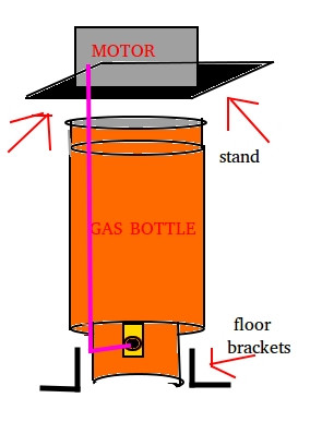

As illustrated on the images I plan to put the bottle upside down, with a tee installed so that I can drain moisture easily.
I wanted to weld 3 brackets on the handle so that I can screw this on the floor, and I would like to weld a sheet on the top on which i could mount the motor. May I weld these items on the specified part without ruining the pressure vessel? I think it won't be a problem because they are not the vessel itself but I'd like to ask anyway.
The pink line will be a copper pipe going from the compressor motor to the bottle, as ideally I would like to simply have a line going there and then have the pressure switch, manometers on the top, but I am not sure if this will give false readings or it can't be done as this items would need to be installed directly on the tank
