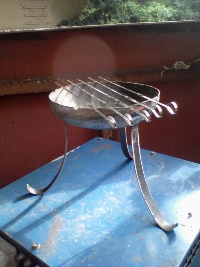

sardine Member Messages 3,721 Location Buckinghamshire Jun 8, 2013 #1 mark one, mark 2 needs to be a bit deeper, say 30 or 40 mm, to get a slower cook. Last edited by a moderator: Jun 8, 2013
sardine Member Messages 3,721 Location Buckinghamshire Jun 15, 2013 #4 you have to burn gas bottles out hard to get rid of the thick galvanising and paint, then you just need a quick polish off, ( not a euphamism ) and whack on the high temp black gloss.
S skut_monkey New Member Messages 10 Aug 3, 2013 #5 Try a disposable helium canister, asda stock them in the party section, I made my bbq from 1,
Lawnmowerboy Member Messages 2,165 Aug 4, 2013 #6 The paint burns off easily and the galv won't really affect it. Just like the galv on garden dustbin incinerators.
