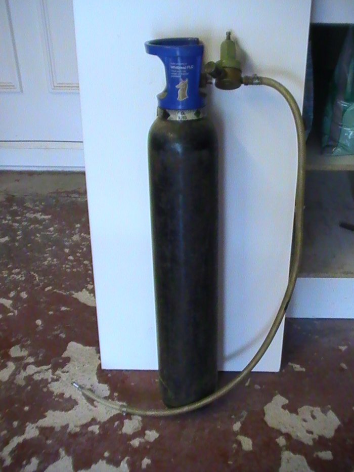

Hi. My local friendly fire extinguisher company will fill a mix of gas as long as the bottle (c02) has been tested
