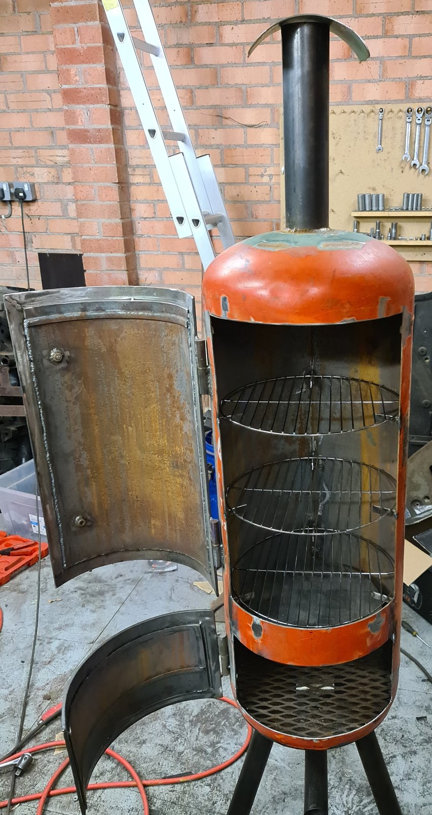

N Nick9one1 Member Messages 67 Location London Jan 25, 2021 #1 I've been building a BBQ smoker from a 47kg gas bottle. someone told me they are galvanised. Is this true? The outside could be, bit there seems to be too much oxide on the inside. 20201031_172010~2.jpg 303.5 KB · Views: 377
gordon stephenson Member Messages 7,430 Location Skelton in Cleveland U.K. Jan 26, 2021 #2 I have always found the outside to be galvanised, the inside is surprisingly filthy, I going the gala off in areas to be welded, then have the whole thing shot basted before painting.
