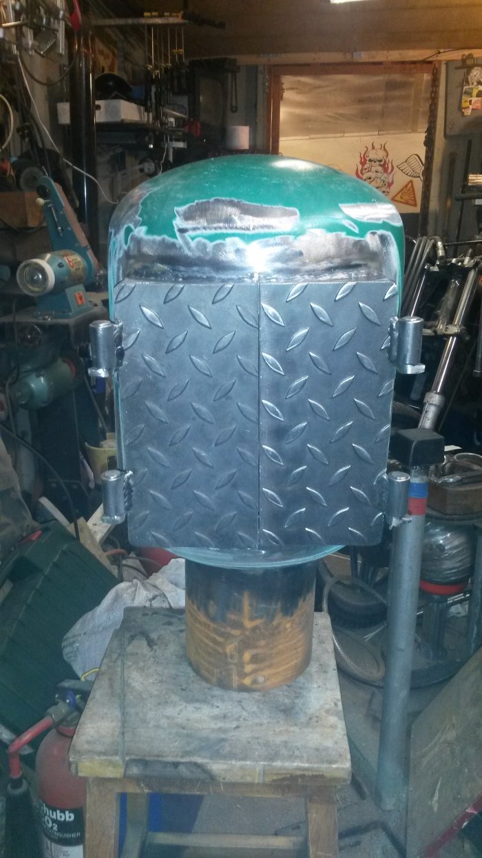

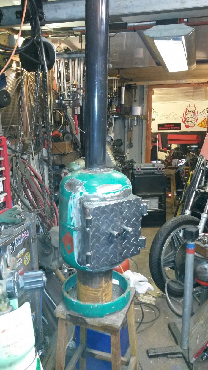

Got asked to make a Chiminea for a mates neighbour, the only specification was that the top of the flue had to be above head height while he's sat down. The doors, the door frame and the tube at the base were out of the scrap skip, the door knobs are stainless and from a scrap curtain tensioner, the flue is a chassis cross member of a wagon at work and of course the main body is the old faithful lpg bottle. I'm going to attach the original base to the tube with 4 short pieces of pipe and use part of the bottle that I cut out for the door to make a rain guard over the flue. Excuse the state of my workshop its about due a muck out
