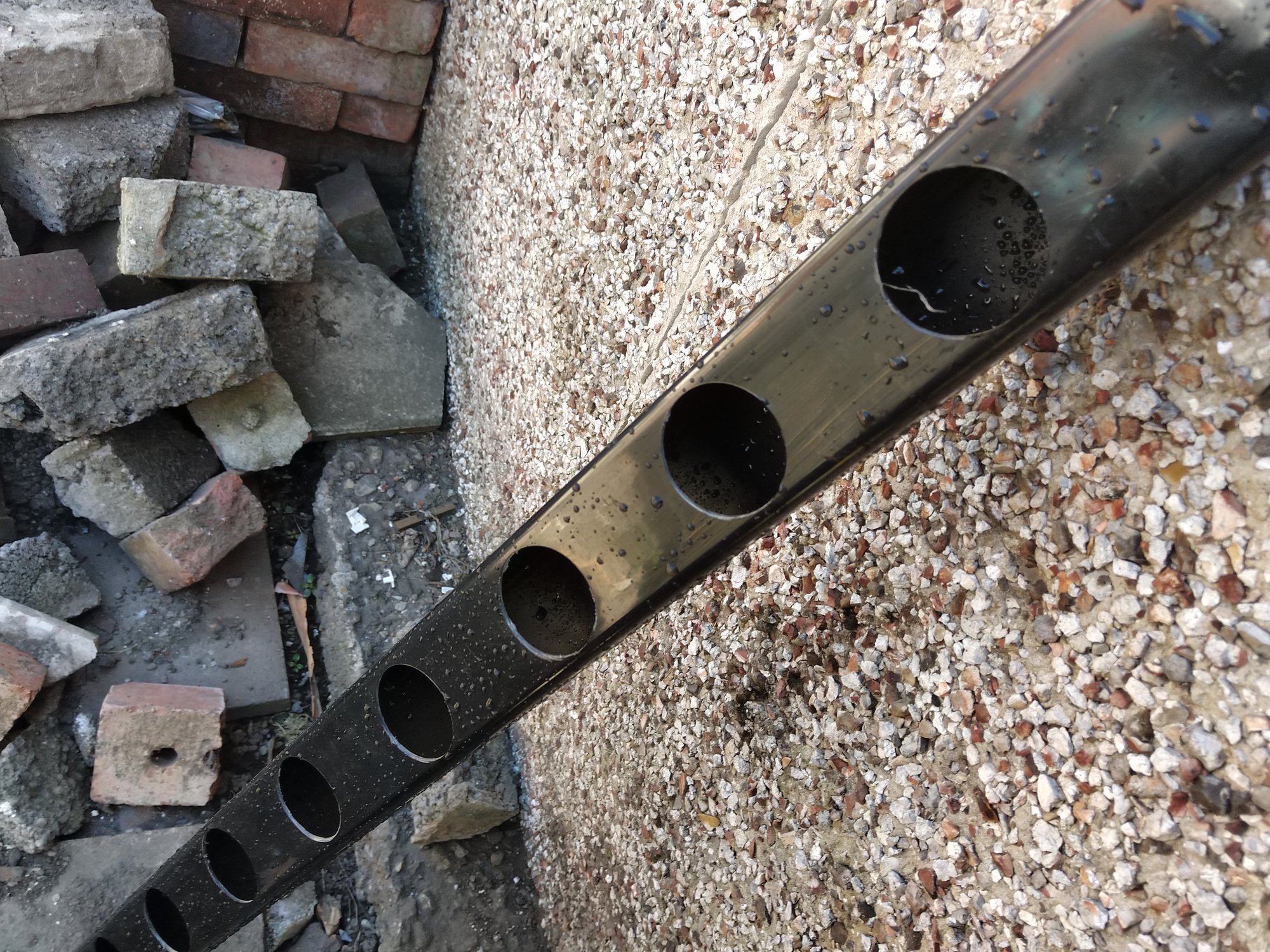

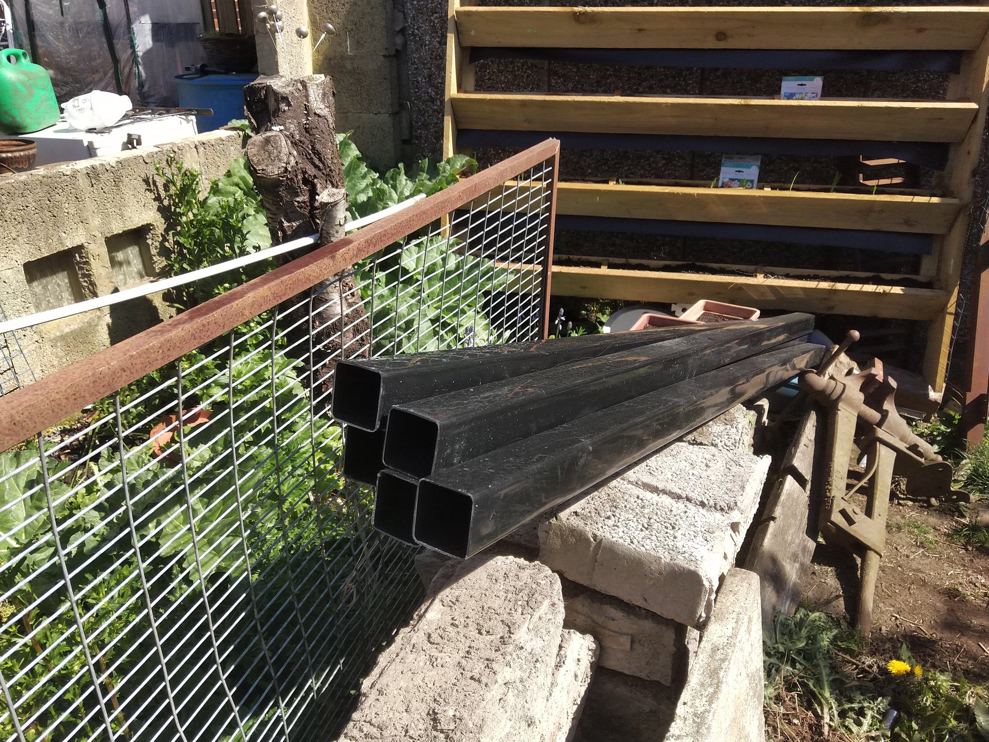

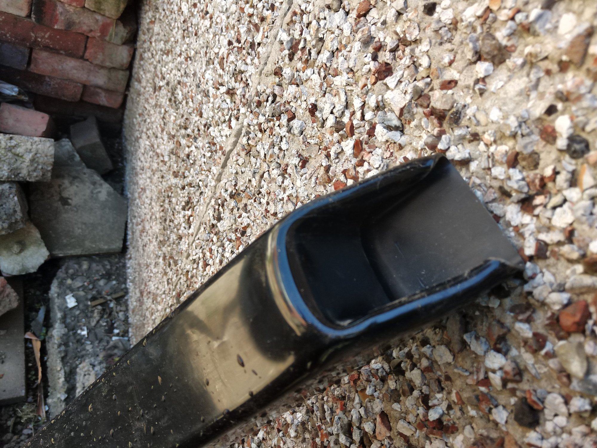

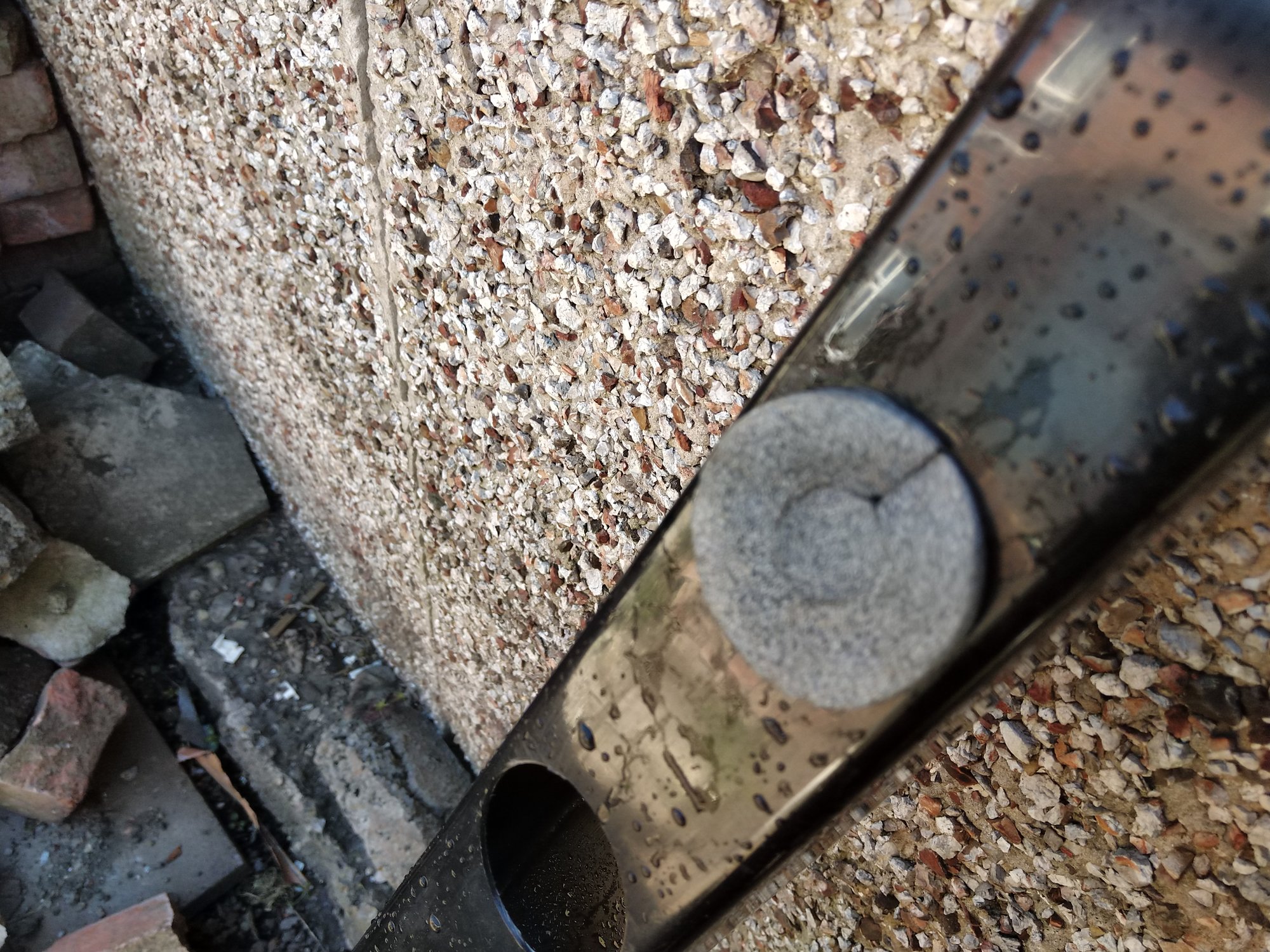

68mm square plastic downspout.
Heat ends and fold to seal ends:

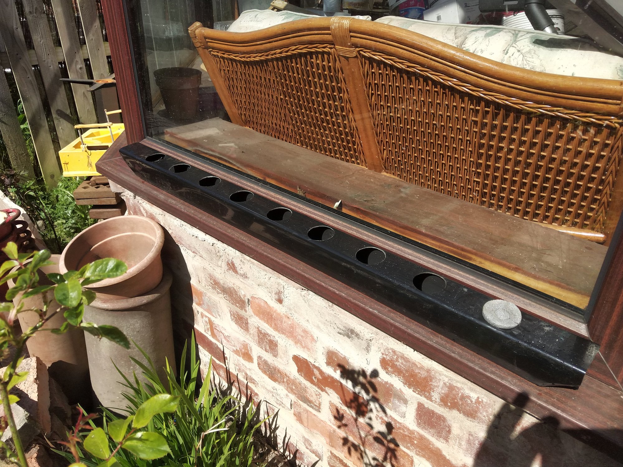

Drill 2" holes @ 4.5" centres

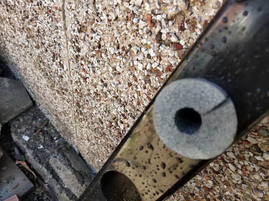

Pipe insulation (22mm x13mm) cut into 1"(ish) discs, and inserted in holes.
Fasten to windowsill:
The idea is that you fill the tube about halfway with water+ (weak) liquid fertilizer.
The foam supports one seedling (which is held in place with a small offcut of foam initially.
Then ignore it except to top up with feed every month or so.
No soil.
No weeding.
Can be done inside/outside depending on what I want to grow.
And because it's "perfect" growing conditions, it's difficult to get wrong.
