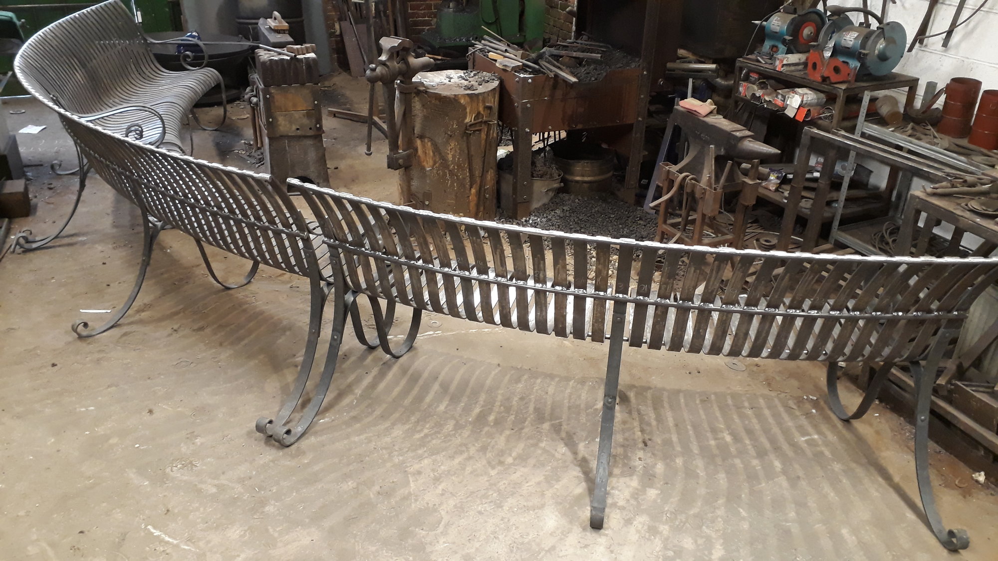

Something I thought might appeal to the fabrication guys & girls here who like looking at forge work...

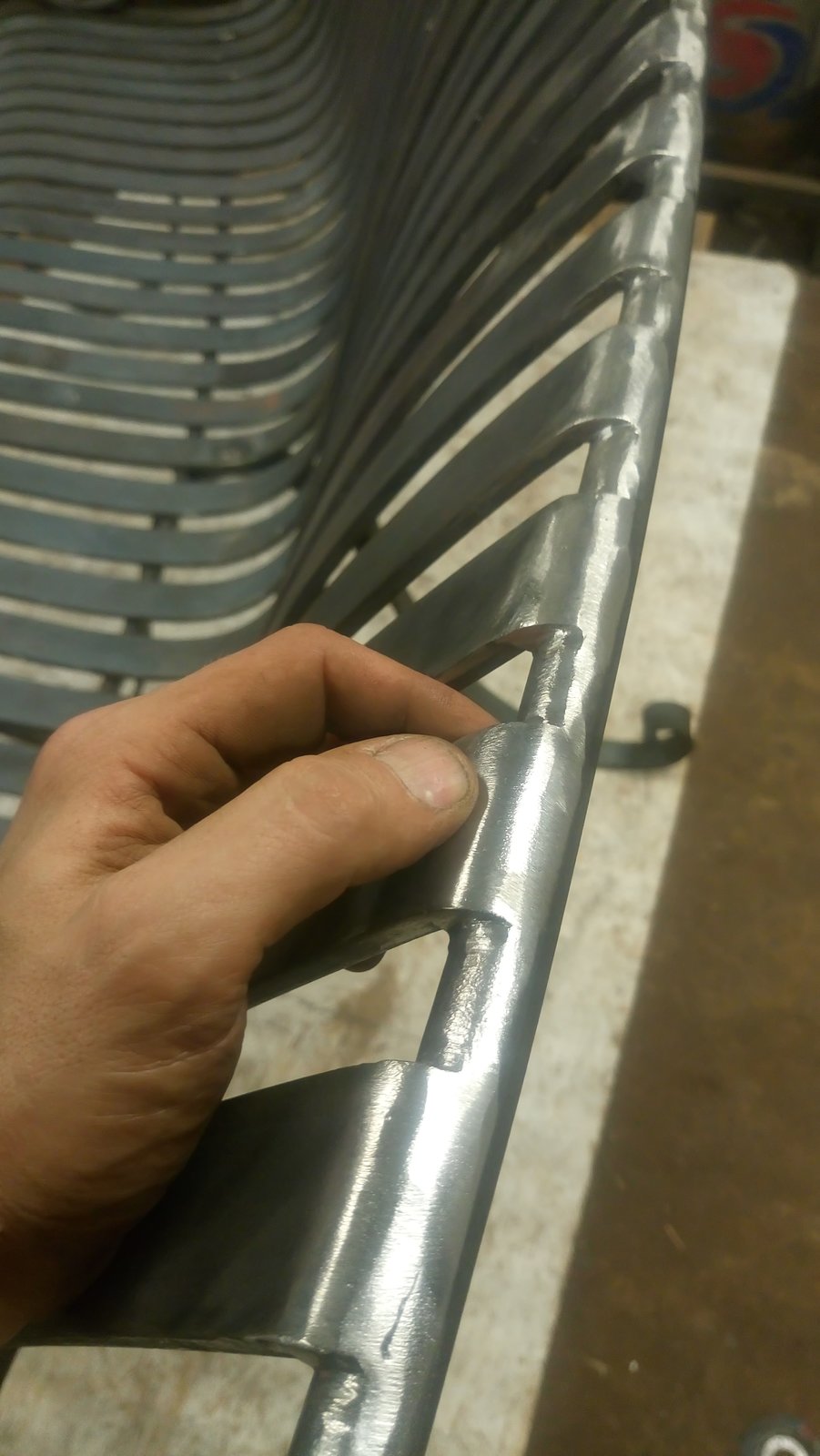

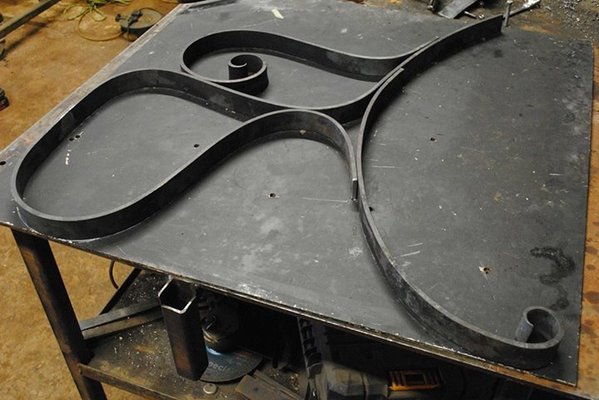

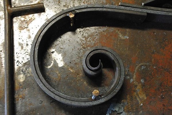

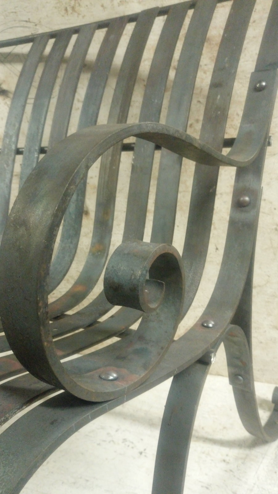

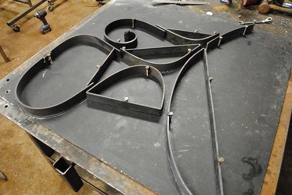

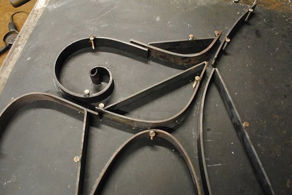

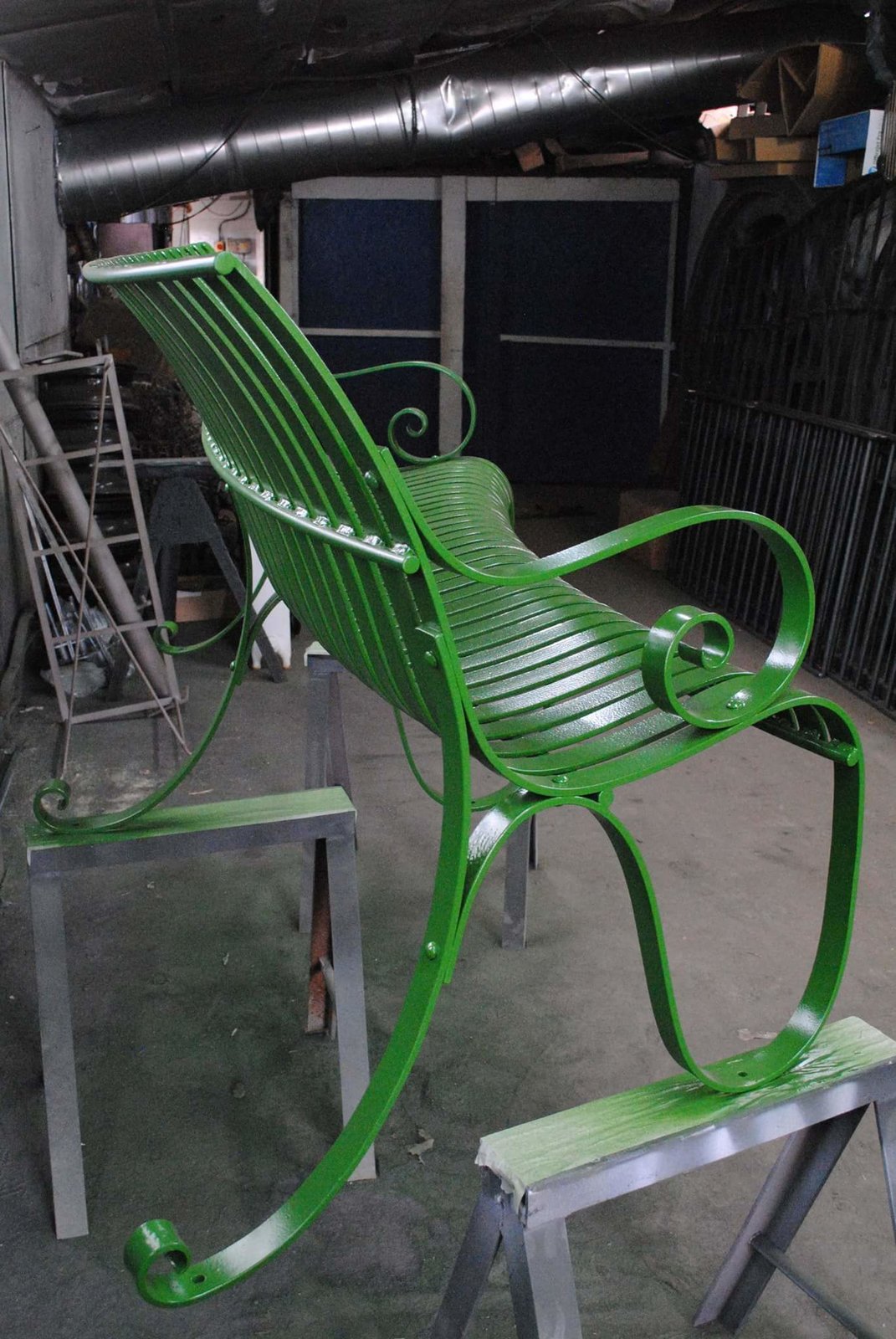

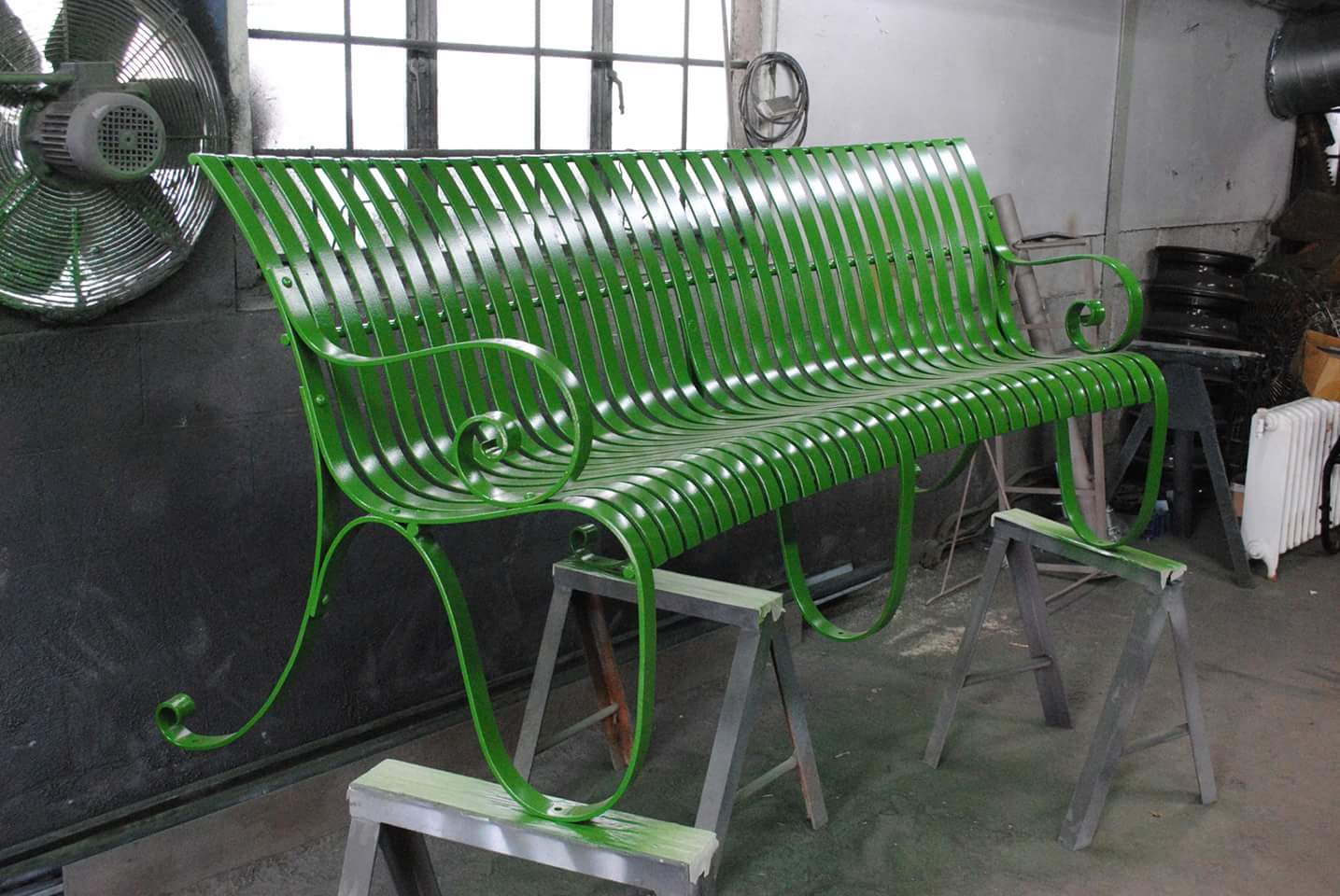

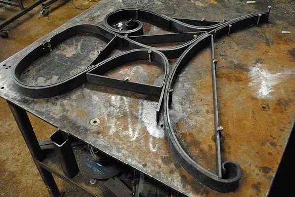

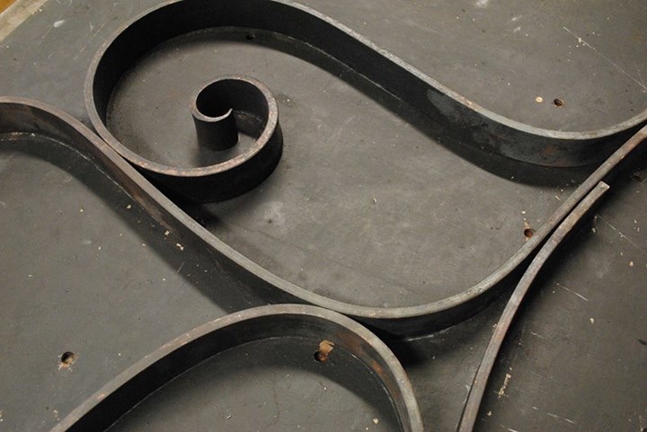

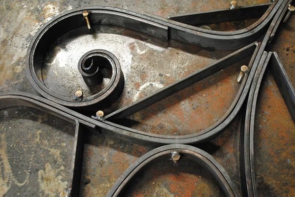

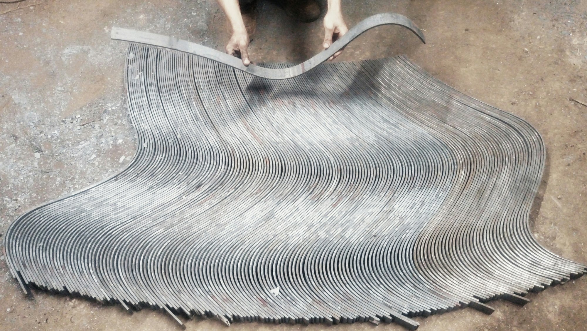

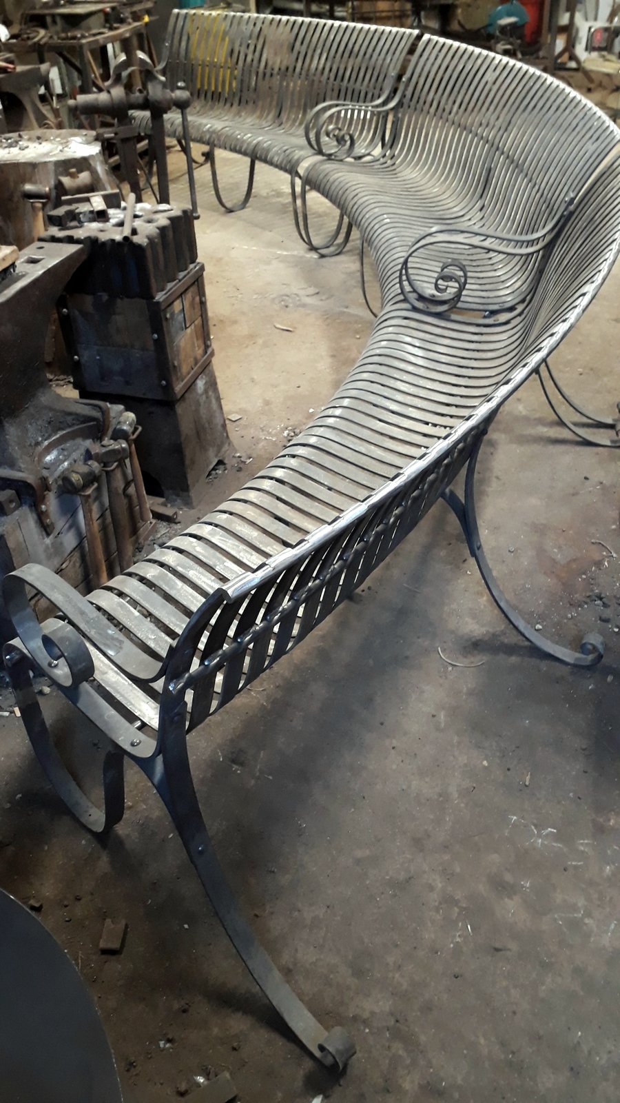

I have a job on at the minute to make 6 curved benches for a local memorial gardens. All the seat & back slats will run front to back using flat bar & following the same contours, so I can use the same jigs to form them. Each section of jig is removeable.
I spent quite a while making the jigs so that if anyone decides they want one for their garden at home, I'm already tooled up. The design is based on the comfortable benches at the local stately home. I traced around them so these should also be comfortable.
