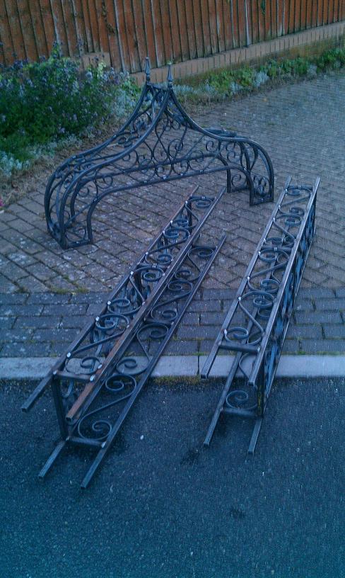

I was shown a similar thing and asked to build another similar one as a display piece.
The original was very light box, and 10x3 flat scrolls.
I upped the frame, 20x20x2 box, and scrolls, i just couldnt face making that many so bought them in, 12x6 flat, with lightly forged ends.
Comes apart into 3 sections, i need to make a couple of joiners for that still.
Top section was fiddly, scrolls ahd to be streched to fit nicely, and also curved sideways to match the curves of the top section.
Overall size, about 1300x2500mm

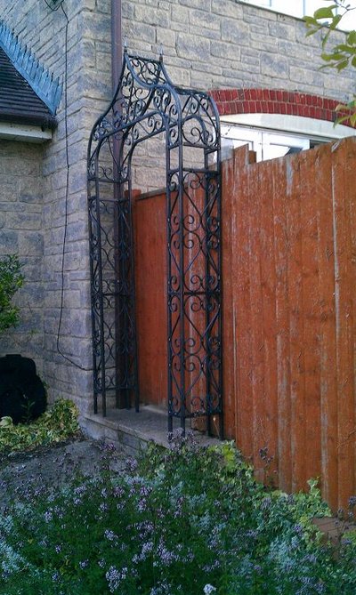

Only pictured there as its the only flat place i could find
