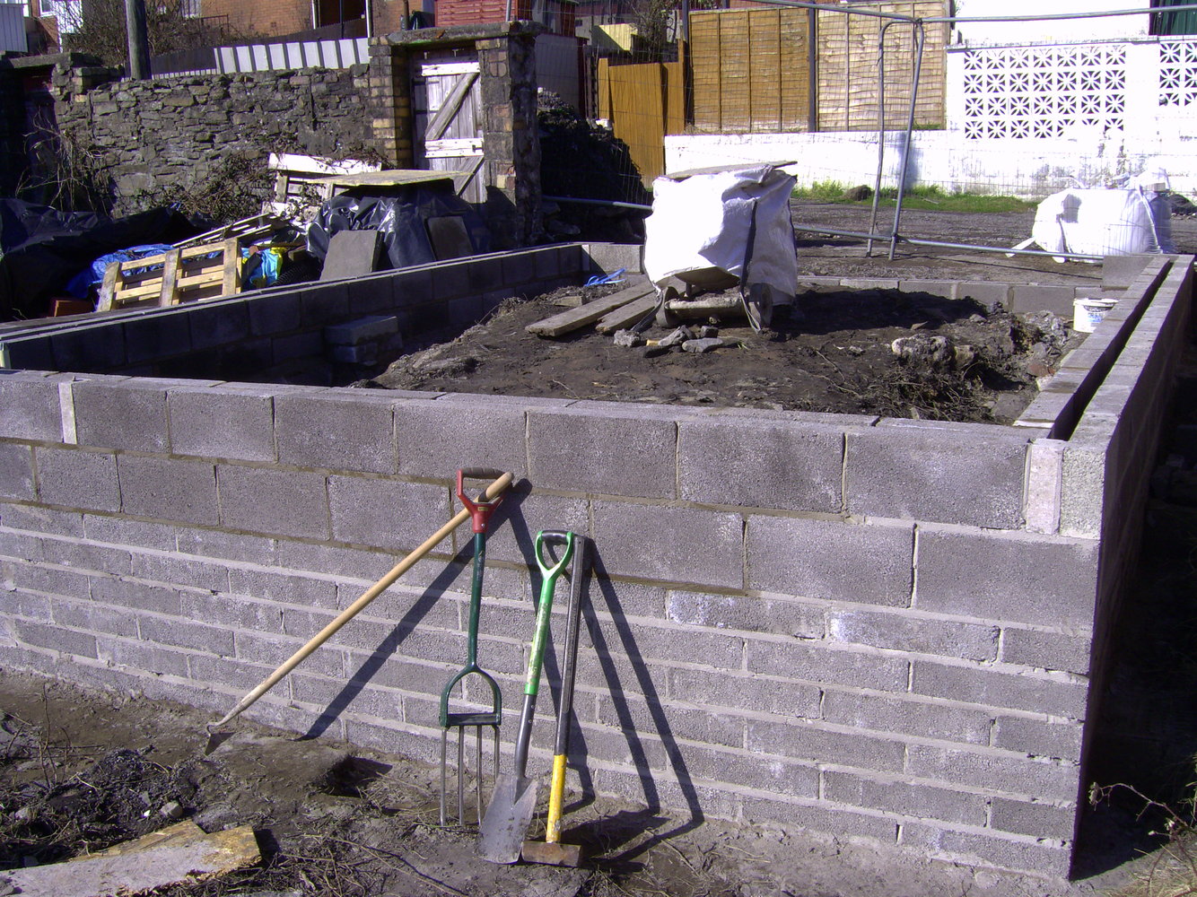

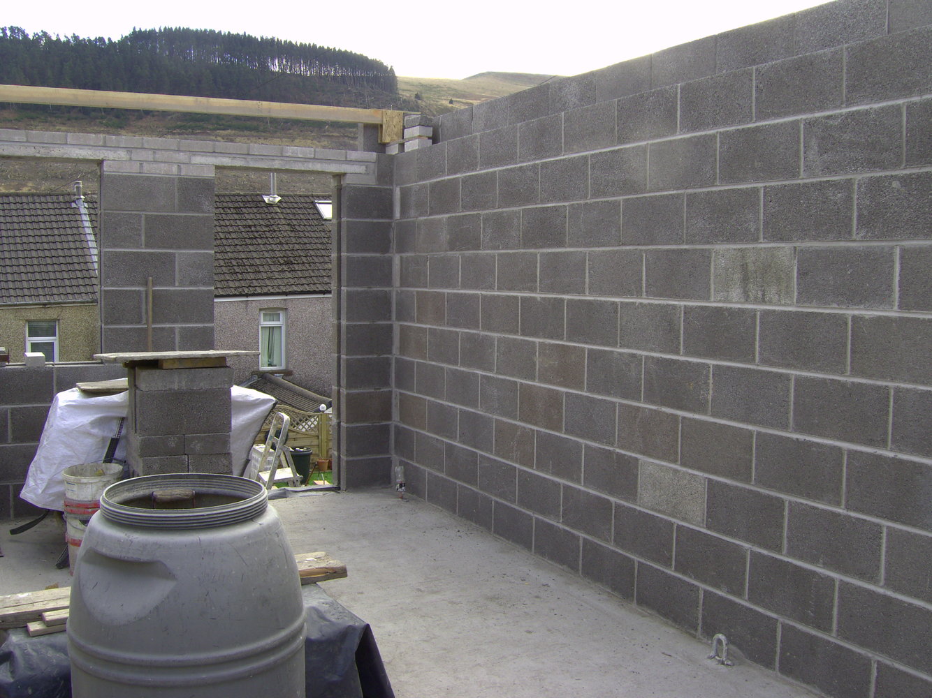

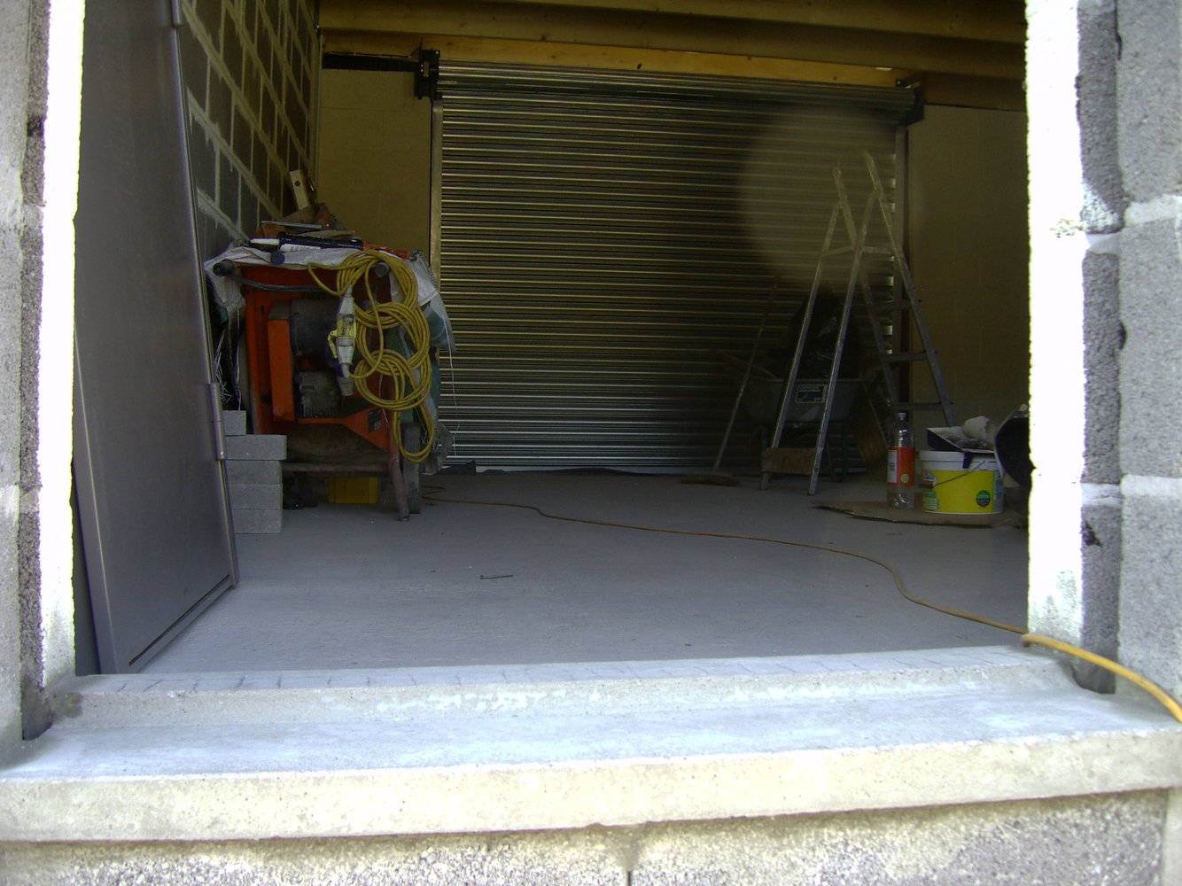

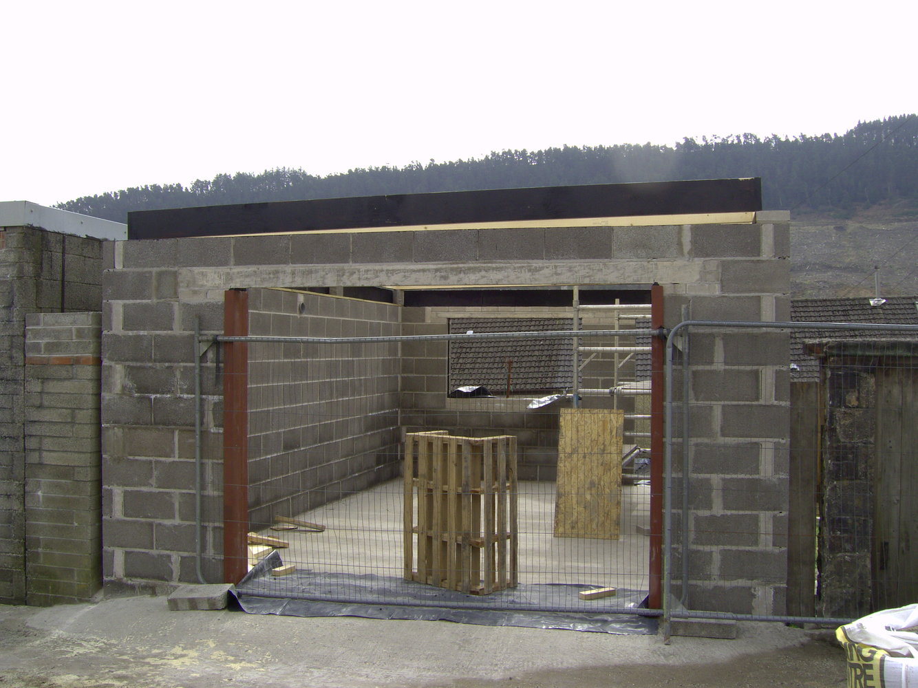

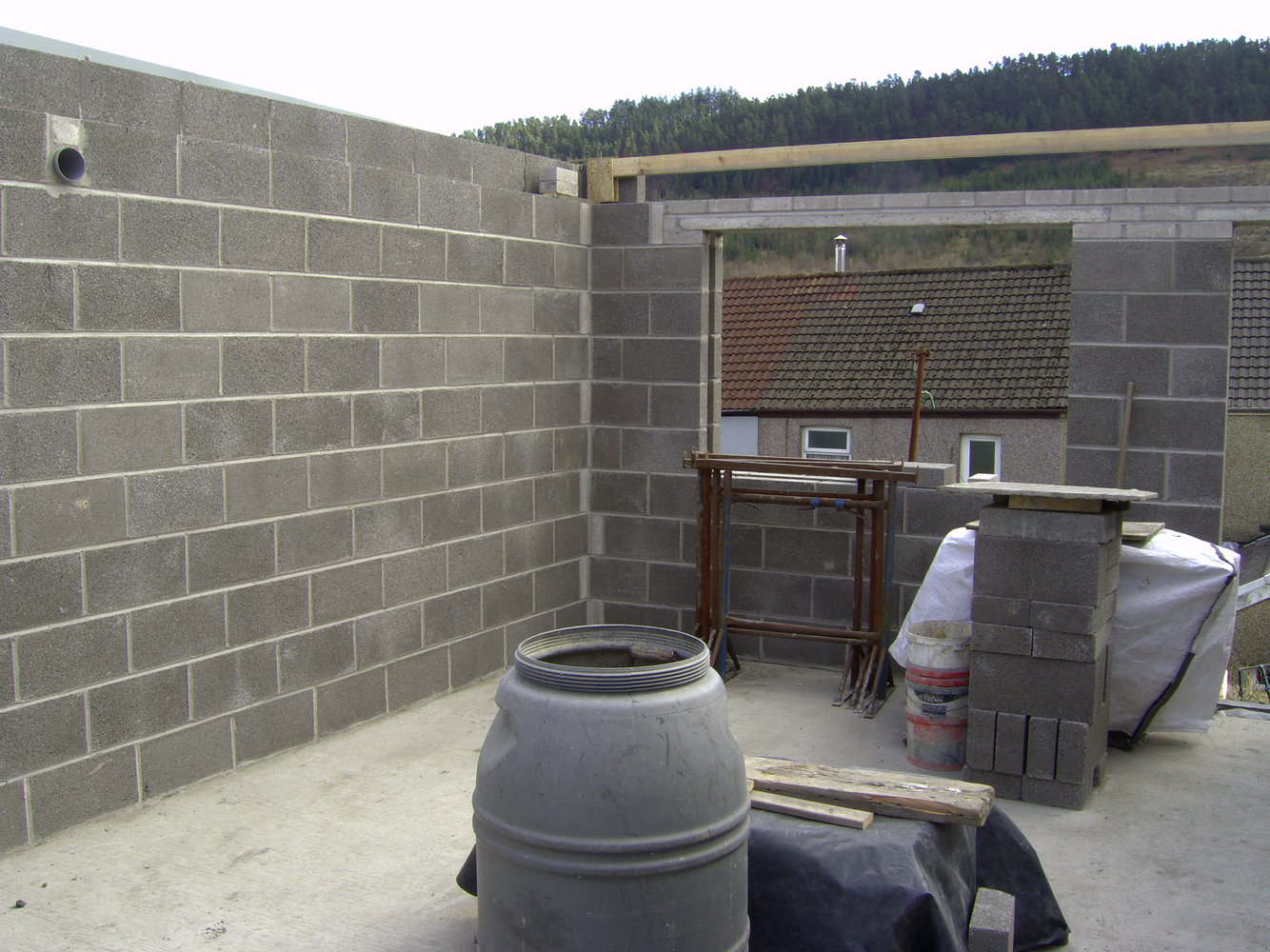

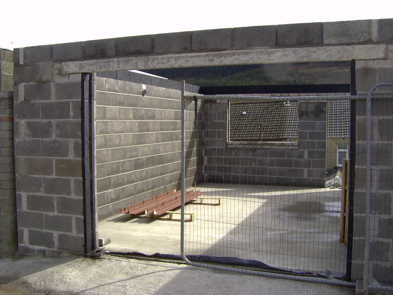

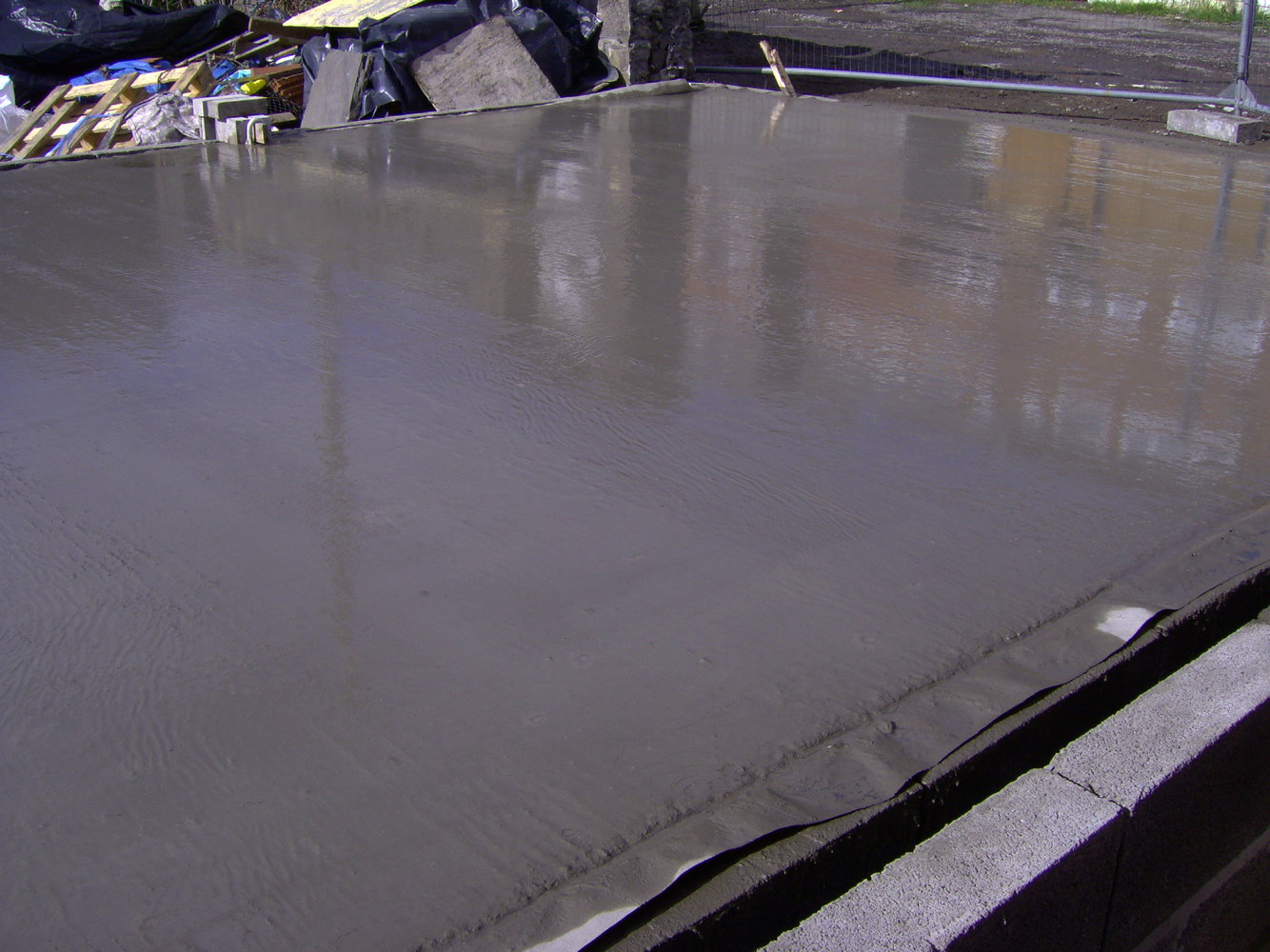

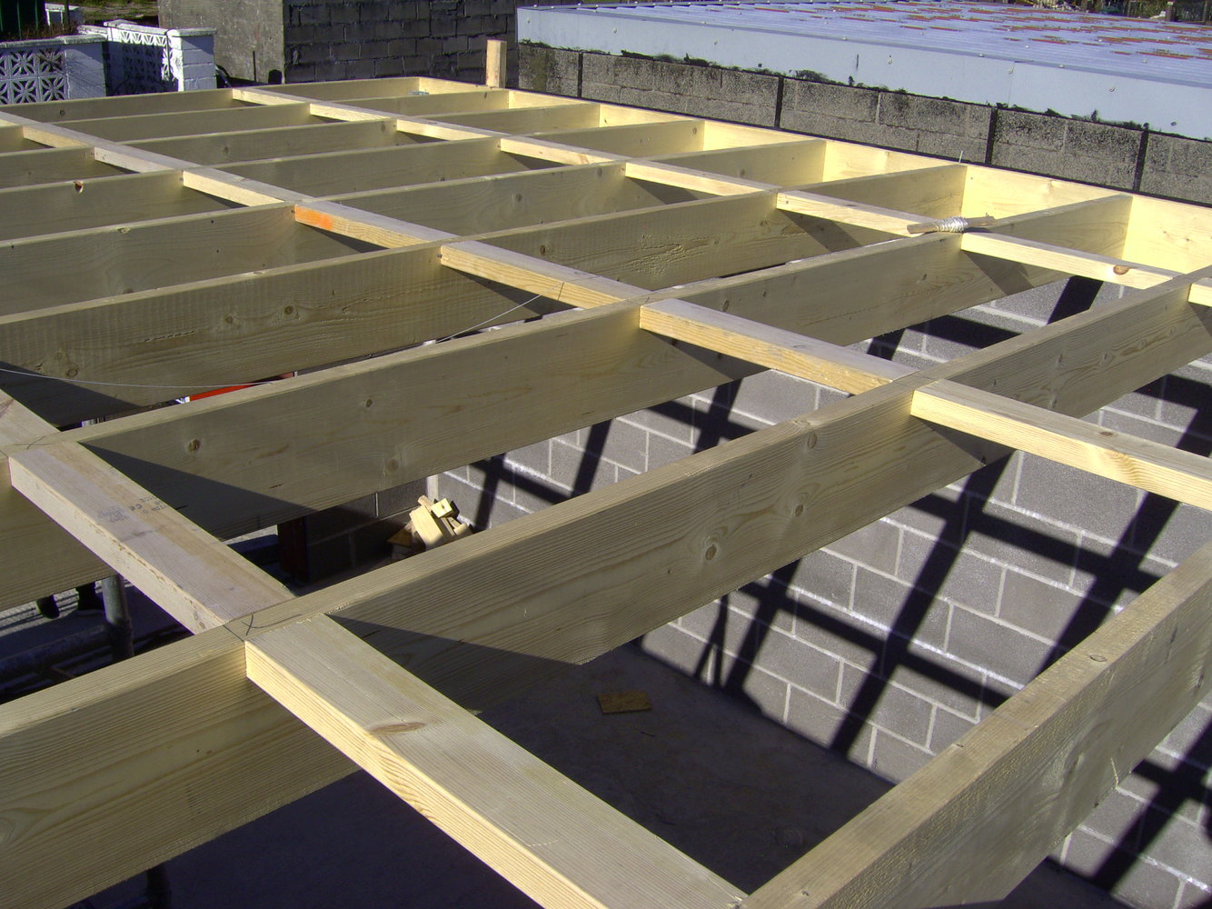

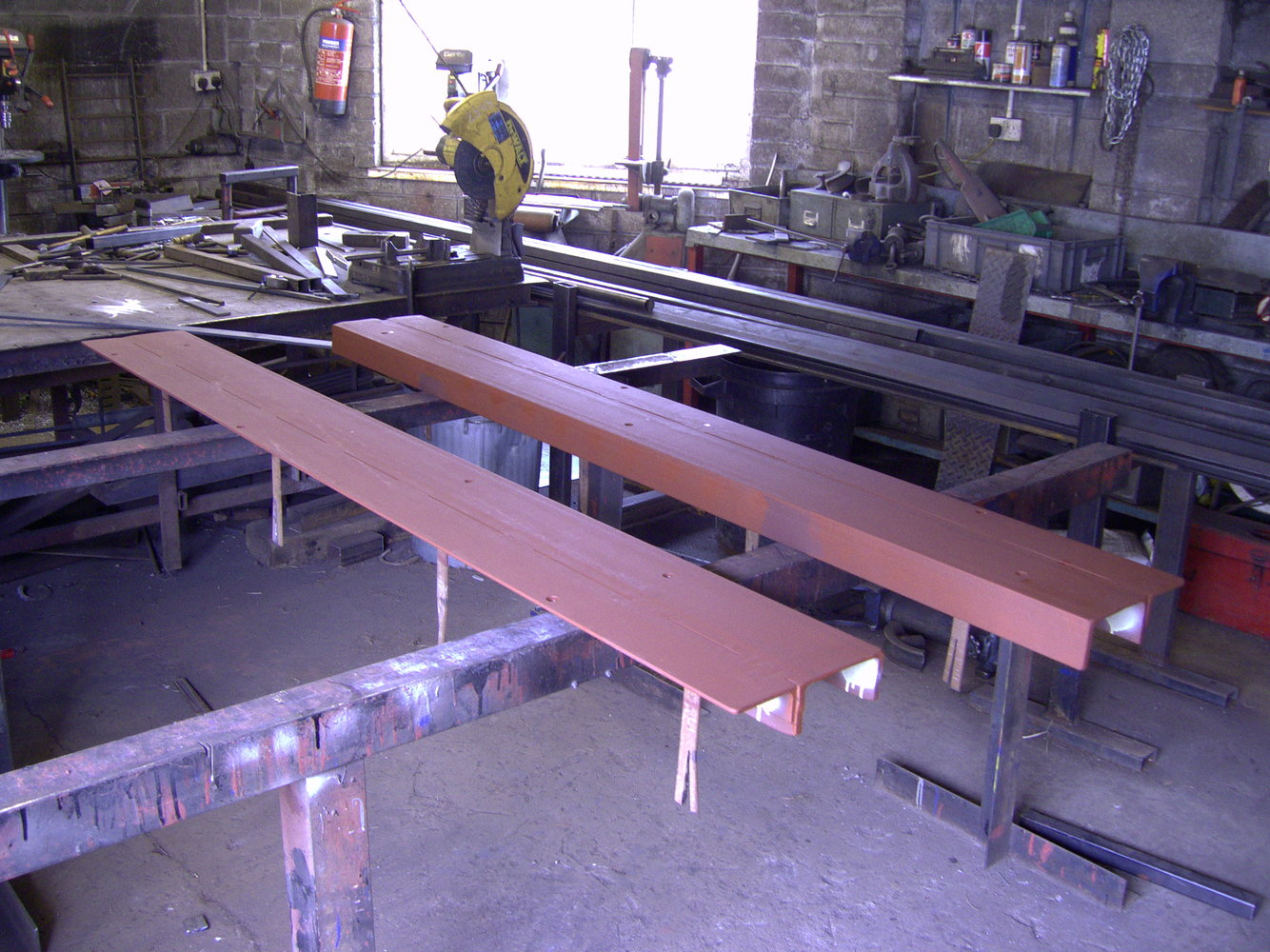

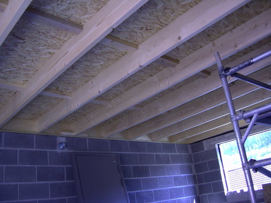

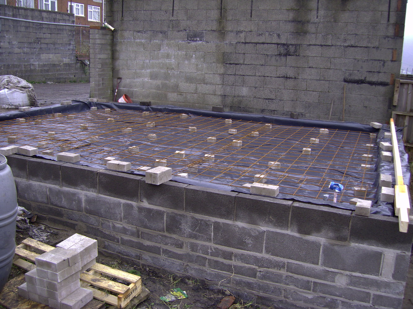

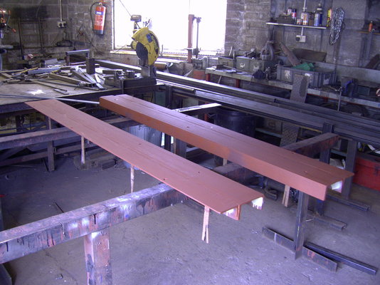

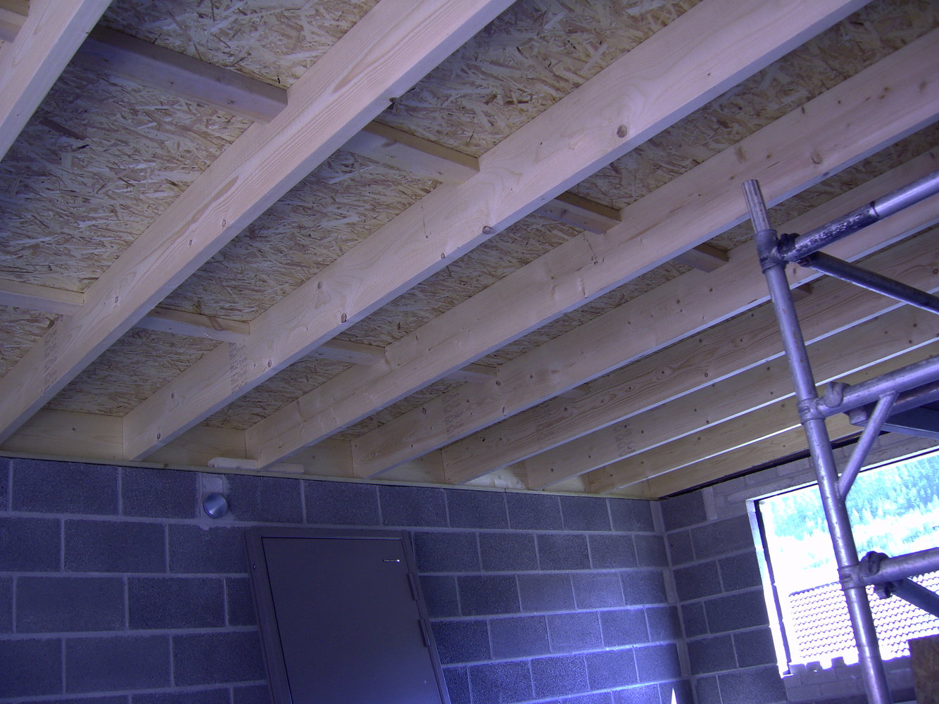

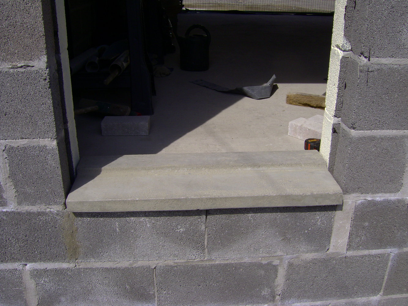

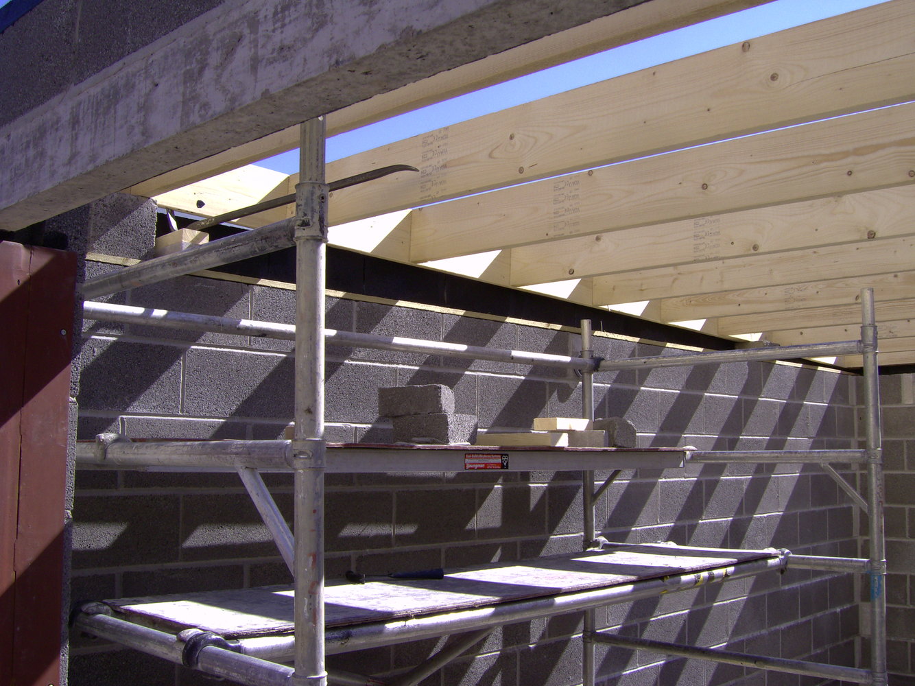

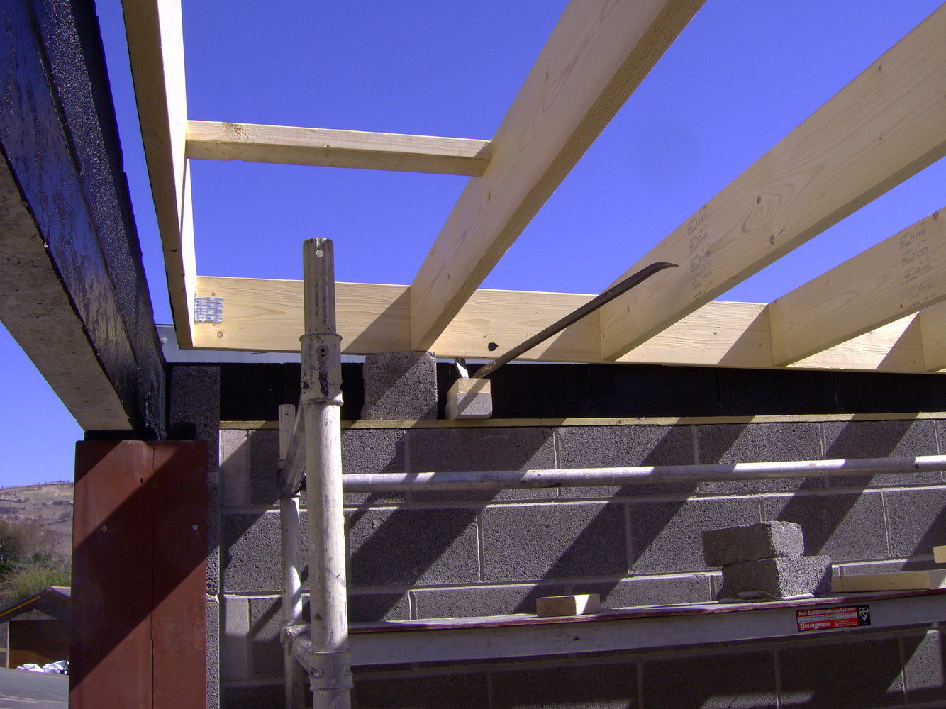

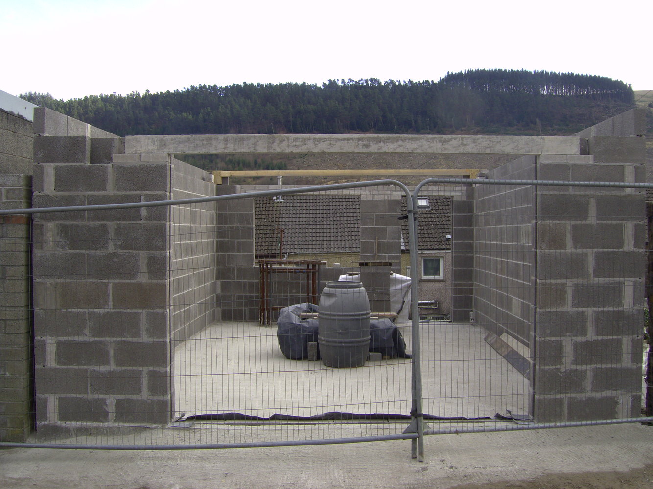

Been busy lately taking advantage of the dry weather. The garage is coming along nicely. A month ago got the footings in and foundation walls up to slab level, wacked in some hardcore, then placed an 8" slab; and this past week we raised the walls up, with just a few more blocks needed to finish up over the lintels. Weather permitting, I should have the roof on by the end of next week.

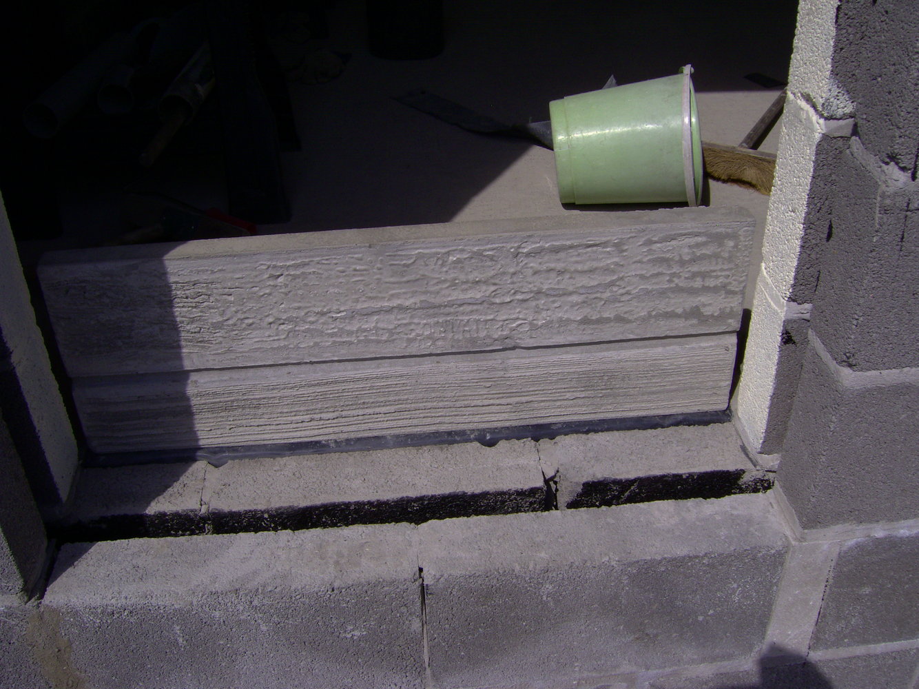

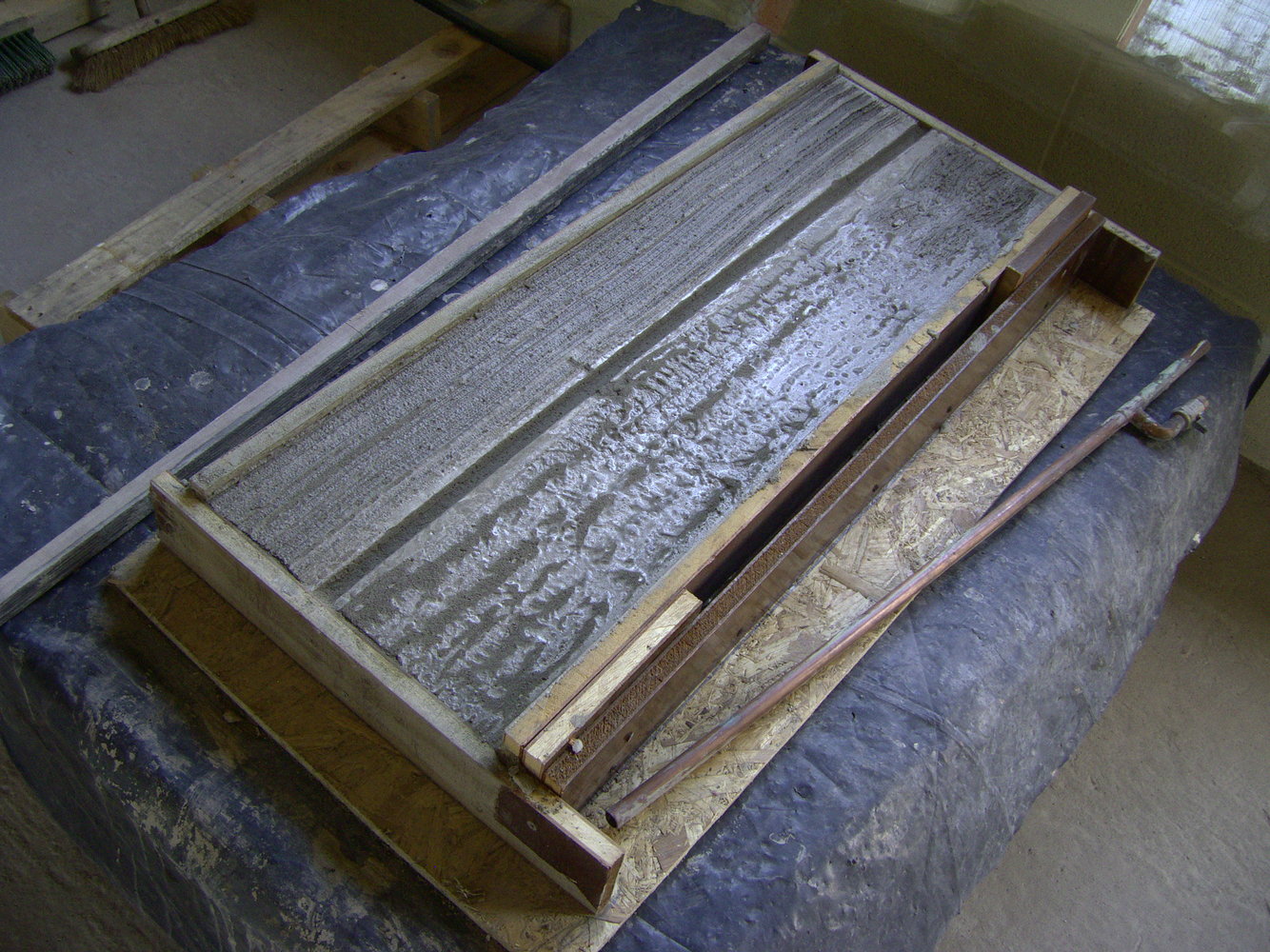

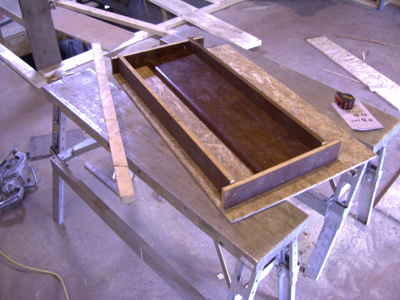

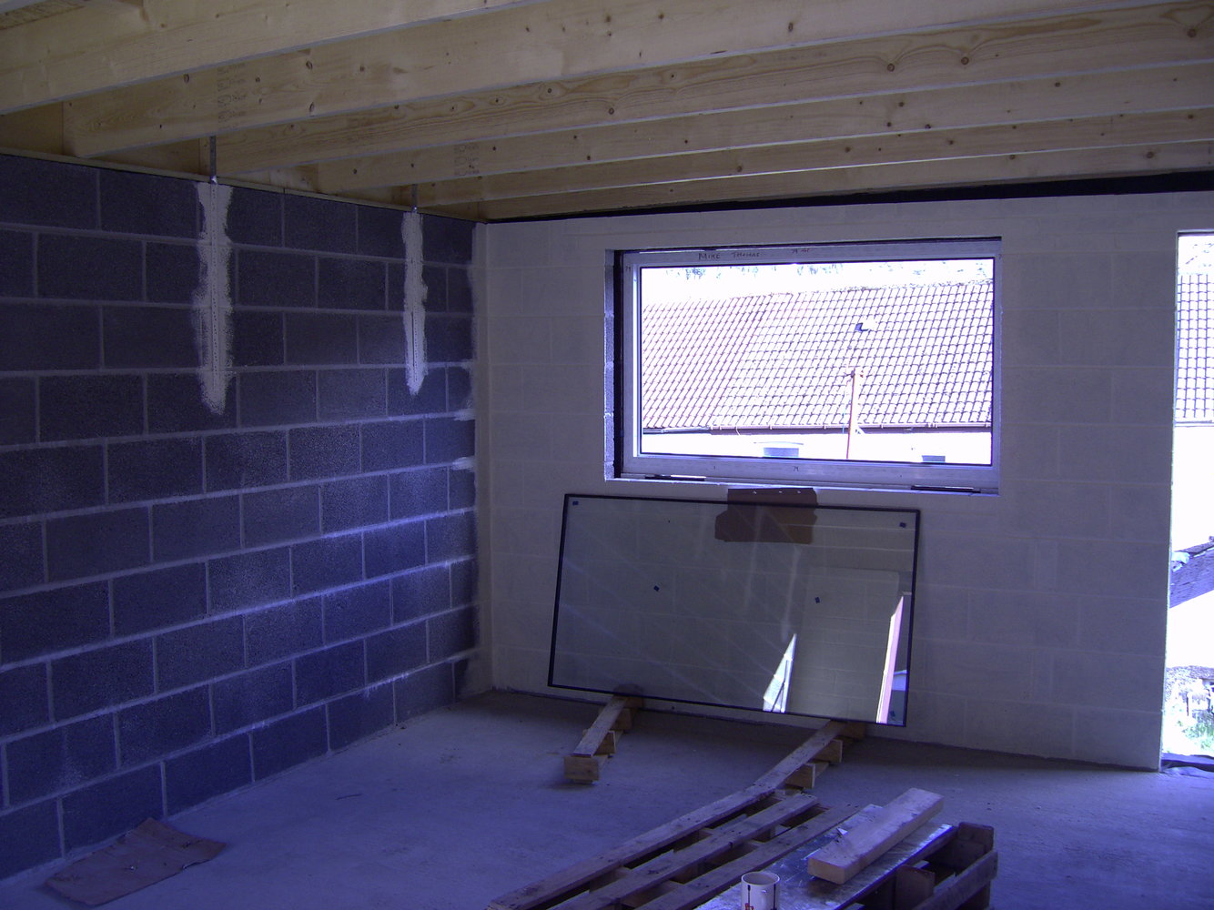

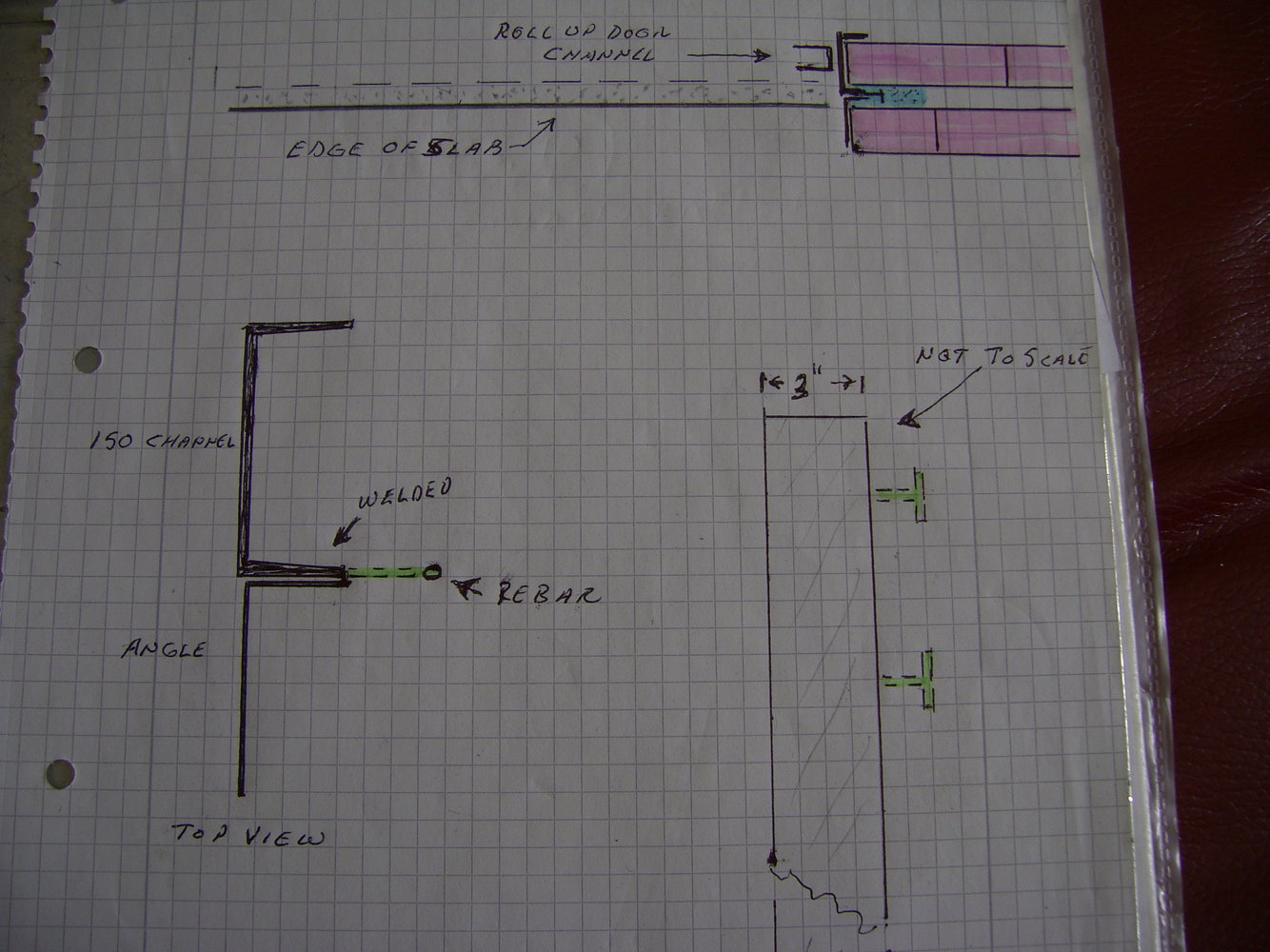

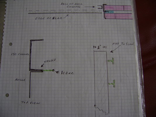

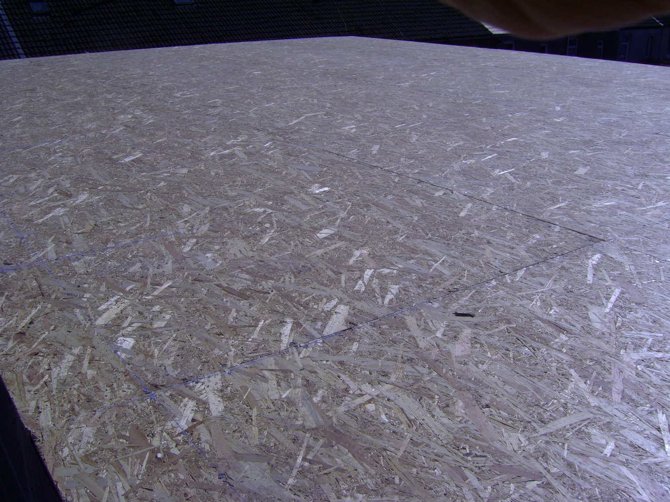

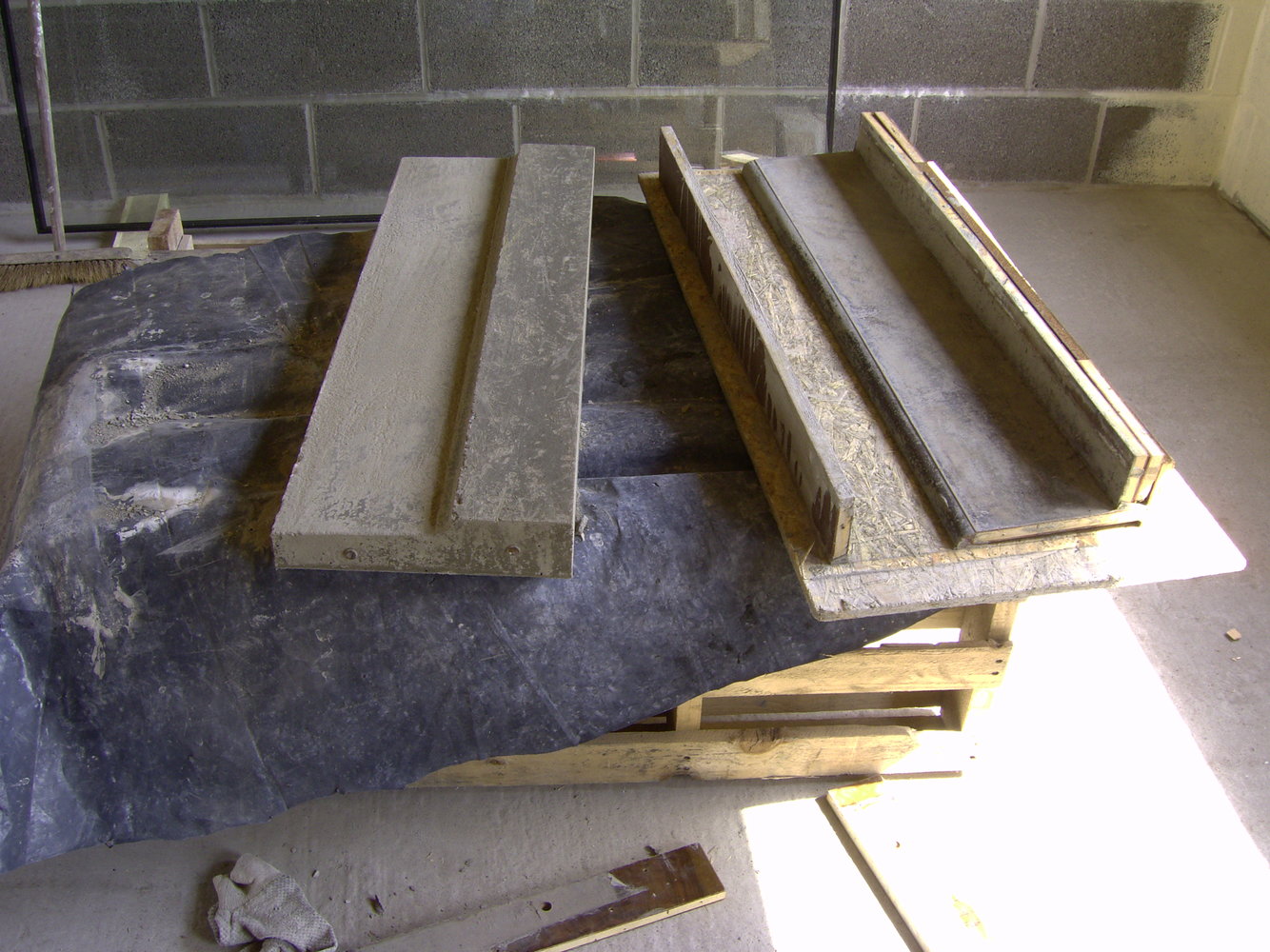

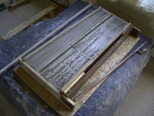

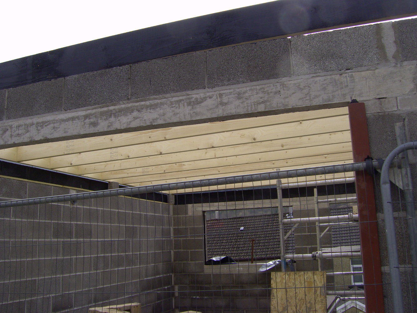

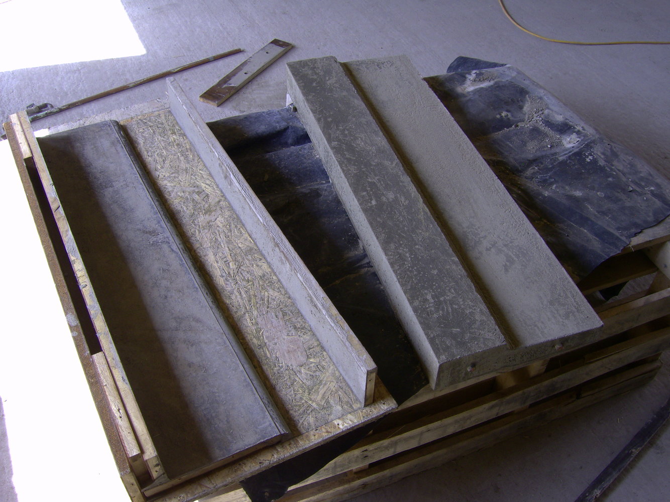

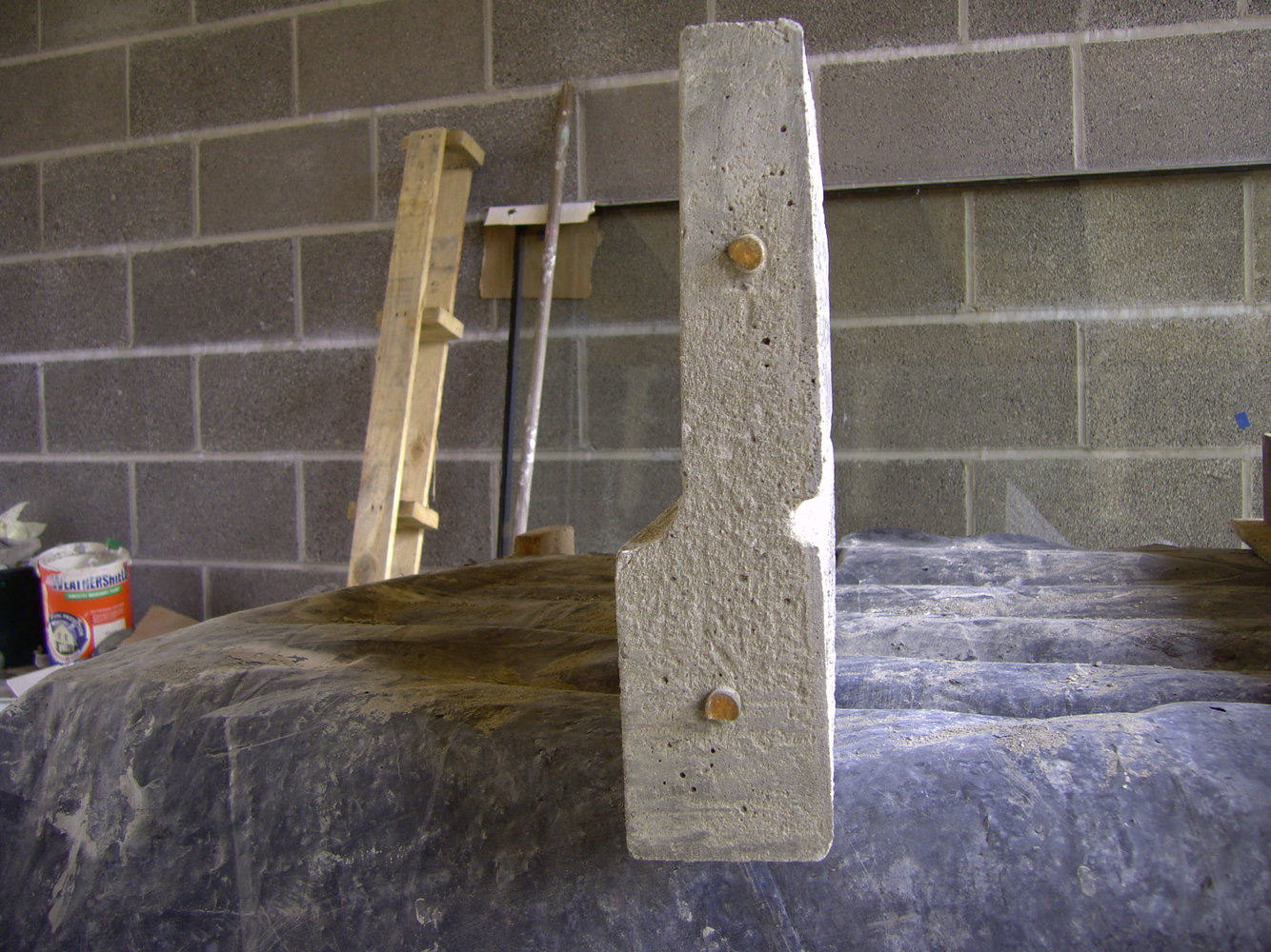

The glass supplier said he would get me another in about a week, and at cost. Yesterday we laid the torch down felt on the roof, and now I'm just waiting for the metal roof sheets to arrive. I haven't been able to find a lintel for the walk in door of the correct size, so I made up a form to pour my own.

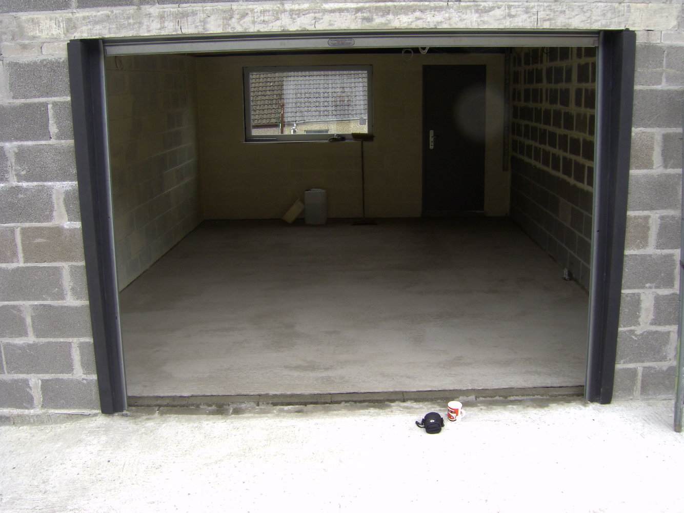

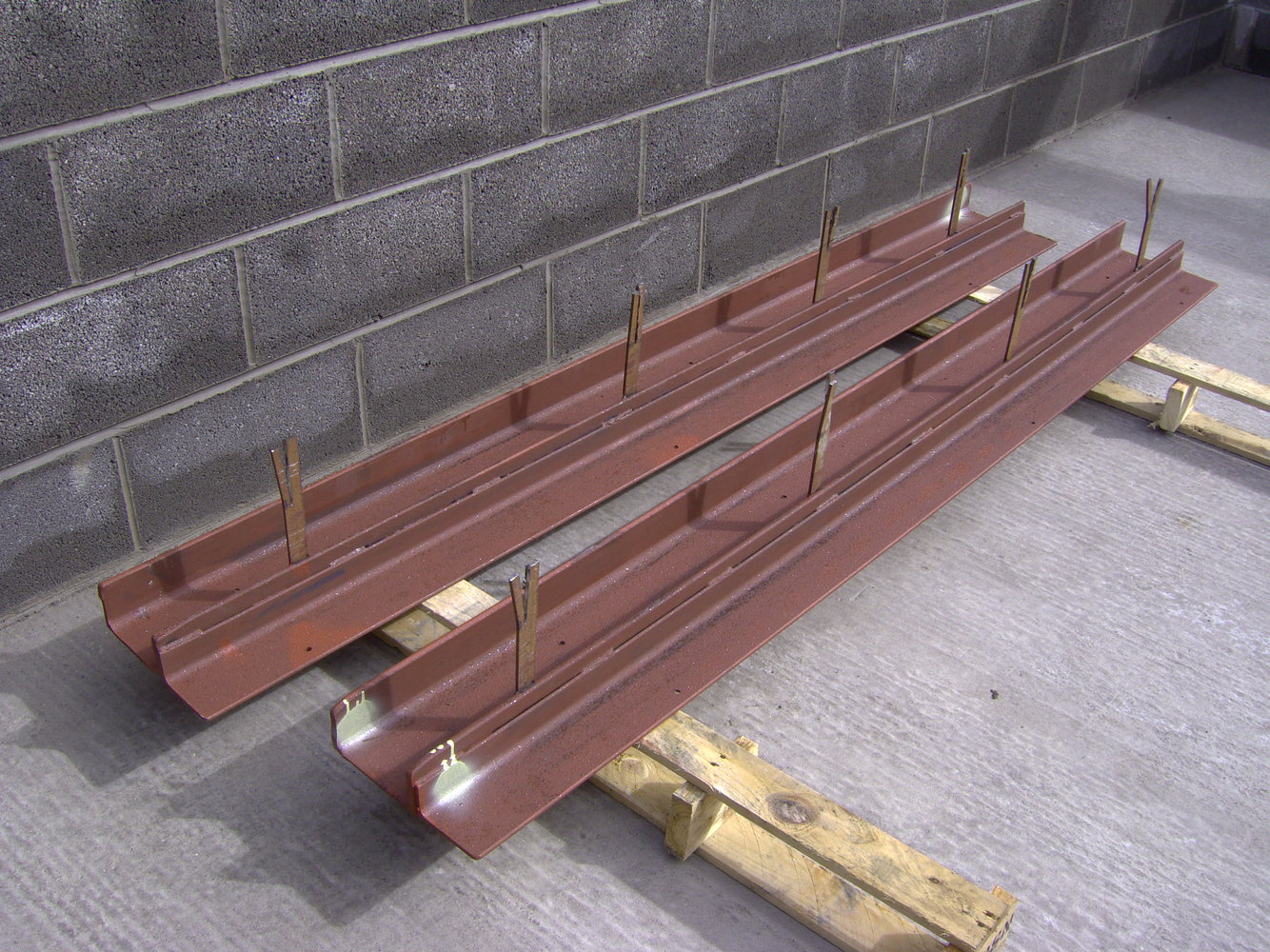

, and the roll up door guys did their thing yesterday. Just need to install the walk in steel door to button it up.
Just the window trim and paint left to do to finish it cosmetically.
