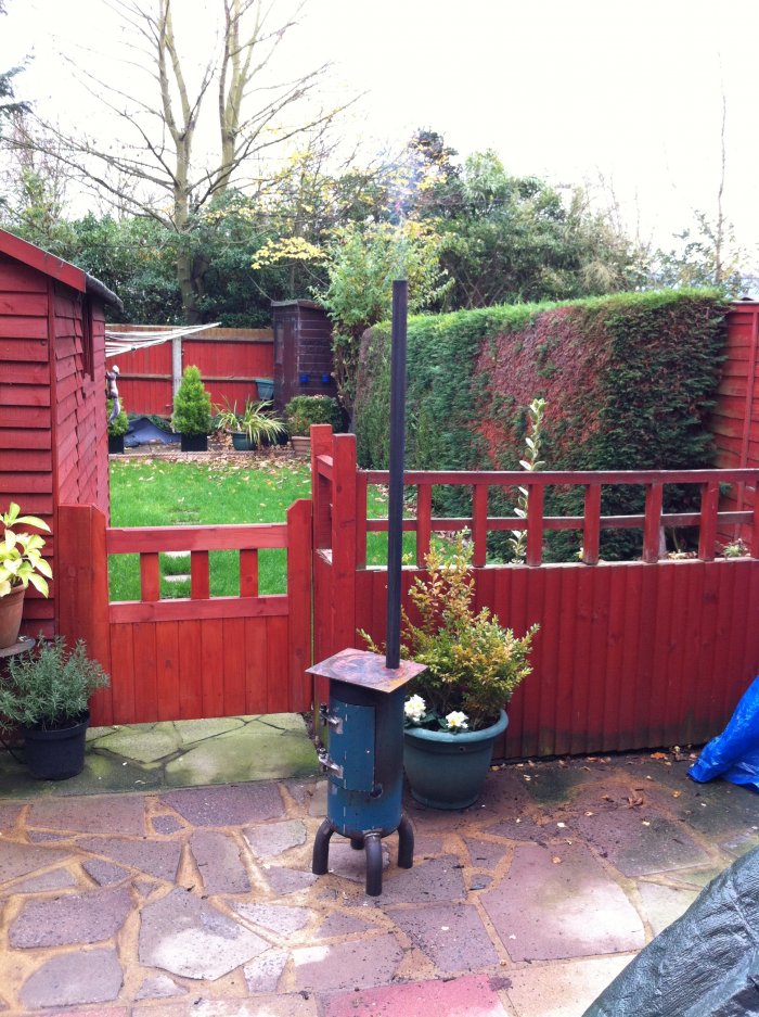

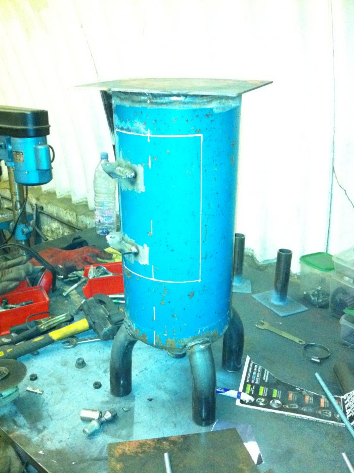

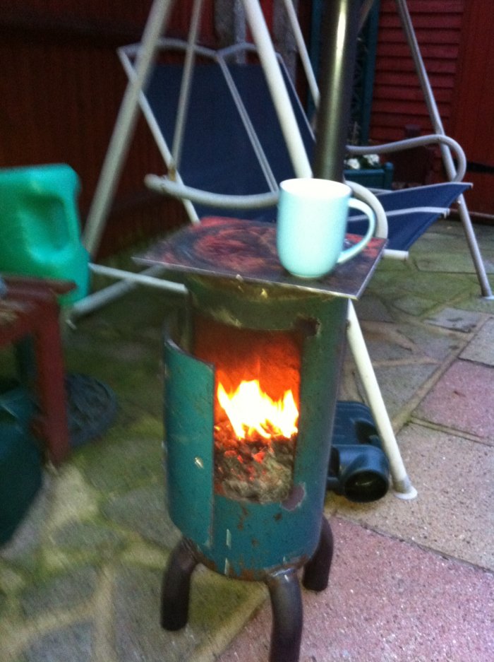

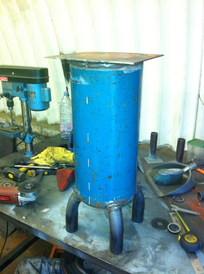

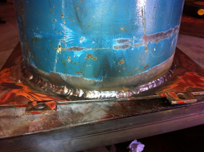

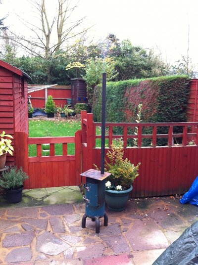

As its getting a bit chilly in the garage now i thought i would make good use of an old cylinder we had kicking about.
Its not finished yet as it needs vents and a handle, i was going to make it a lockable handle but its seems to stay closed all by its self.

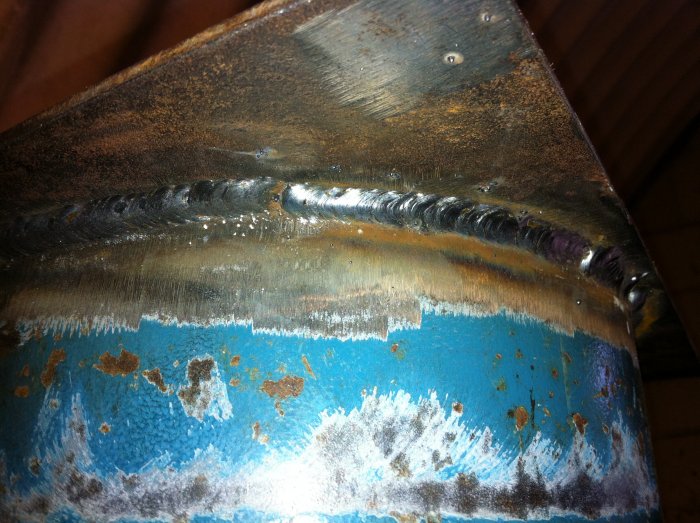

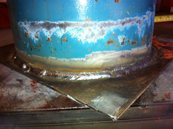

The cylinder is about 8-10mm thick and the top plate is about 4mm i welded it with 0.6 wire as my 0.8 had ran out and my supermig 150 turned to max. The welds look fairly good and feels pretty solid.
Anyways hope you like it, im happy with it so far and i think not a bad job considering my limited welding skills
Any tips on making it more efficiant welcome.
