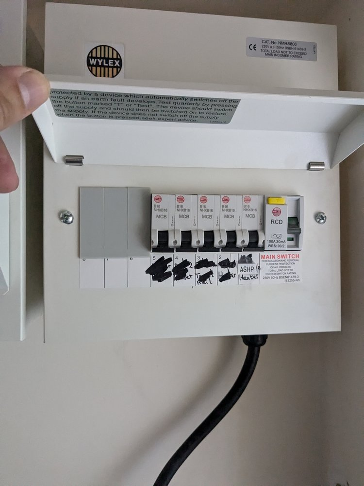

It predates the widespread availability of RCBO's.Would "overkill" have been all RCBO? Or should that have been "ideal"?
Good point, you have to consider earthing, depending on the type of earth in the house.How far is the garage from the house, and what is it made of (metal or not)?

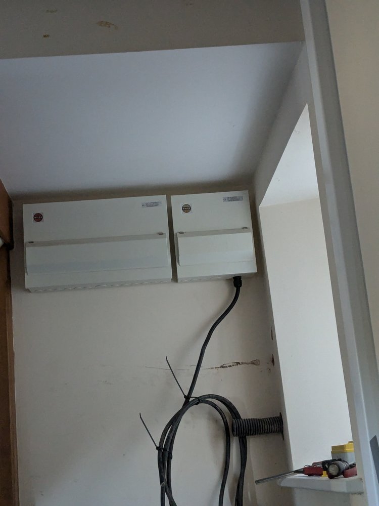

I'd run a duct alongside the SWA in the same trench. Pull in more data cables than you think you'll need, and leave a draw cord. Depending on the system they may need Internet access.If you haven't put the swa in yet to the house you can get SWA with power and data cables in it used for car chargers etc. saves a lot of mucking about if your digging trench anyway.
It's about a 15 metre run and it's concrete block and will be insulated box profile sheets for the roof , currently asbestos cement sheets .How far is the garage from the house, and what is it made of (metal or not)?

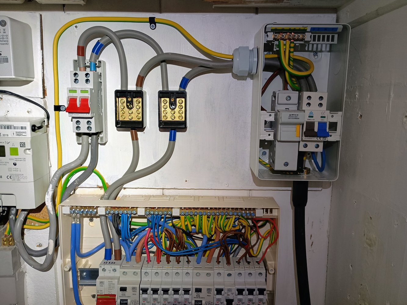

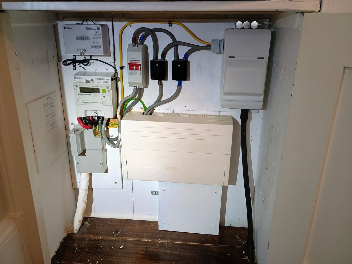

its a tt supply so rcd at source supply neededThe way I would do it would be to split your incoming tails from the meter, to feed your existing house CU and a separate mini consumer unit with a main switch, and then use this to supply your SWA.
Then in the garage you can install a consumer unit with RCBO as required, appropriately bi directional rated for the solar obviously.
That way you will avoid problems with selectivity for RCDs tripping and just generally make the install easier and neater.
Would the garage in such an arrangement need its own earth rod? (i.e. garage as a separate TT installation?)its a tt supply so rcd at source supply needed
