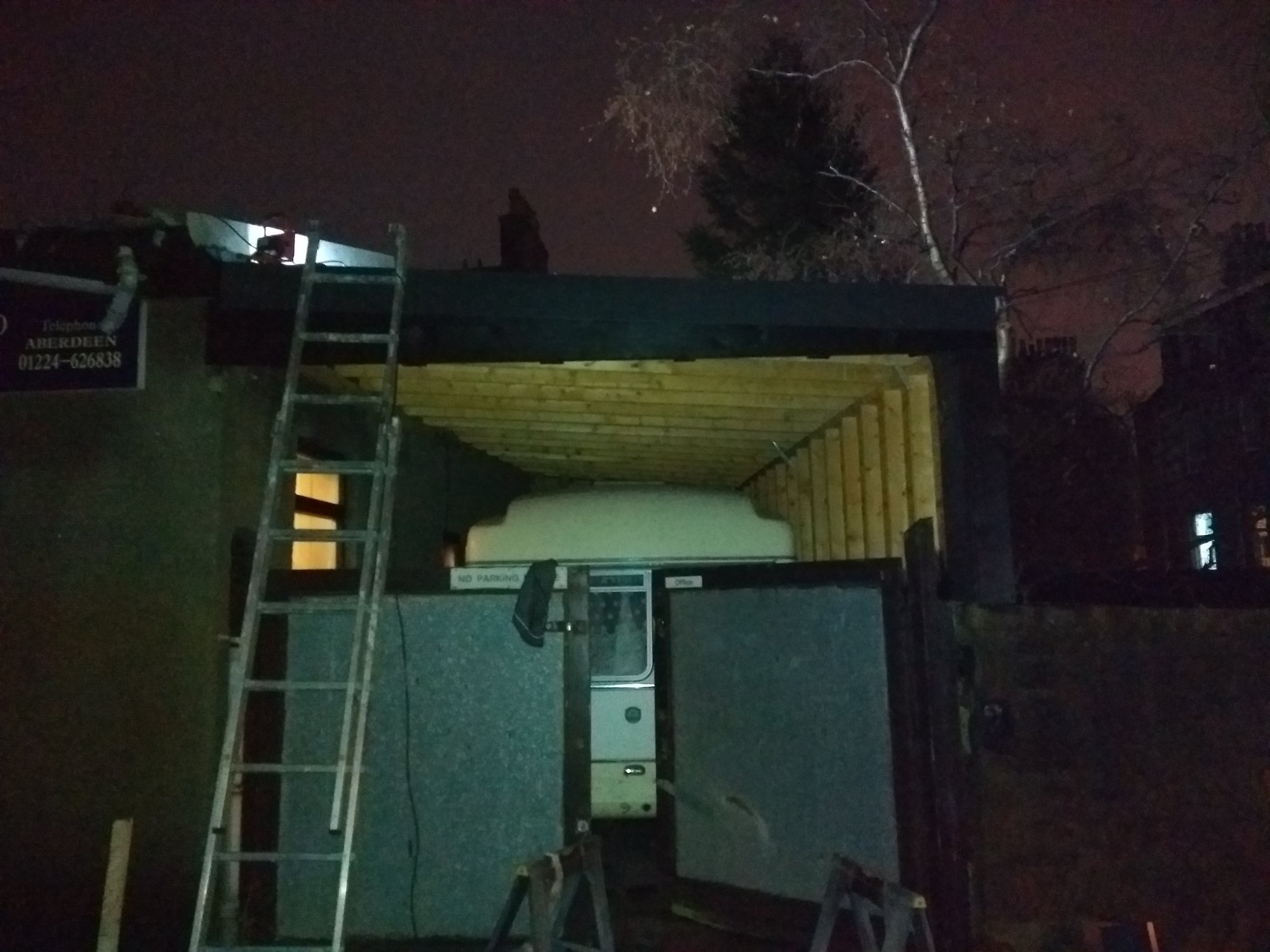

As felt = 18mm OSB = big joists = complete re-build as the walls are not strong enough - materials came out well north of a grand and that's at trade prices.

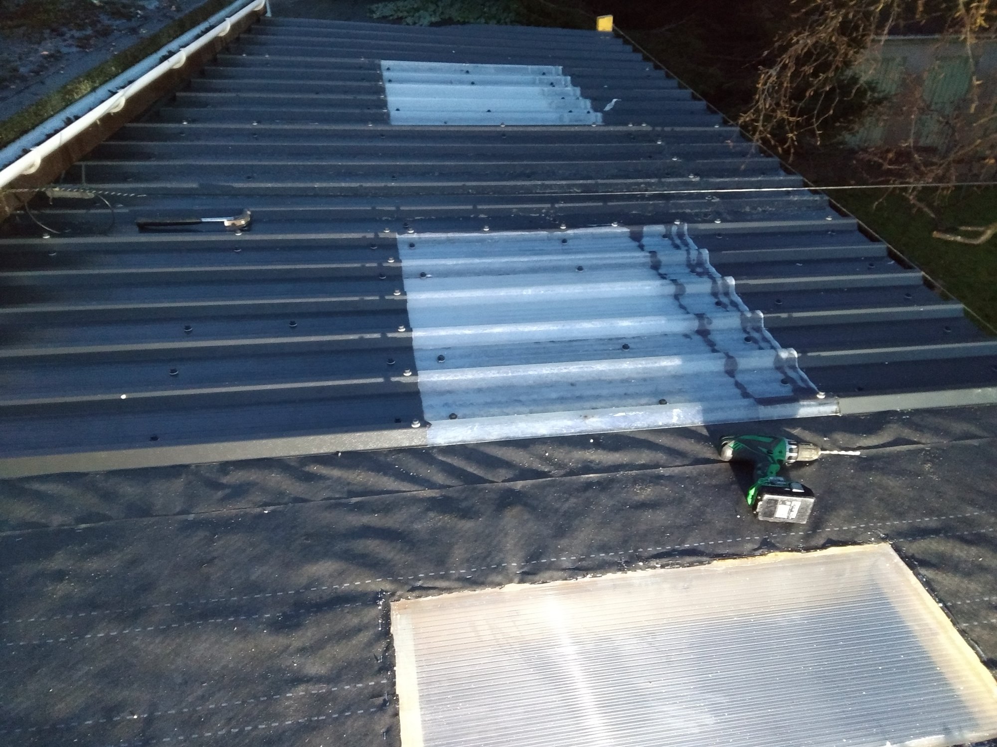

Had a re-think and am now going for Coroline which is a corrugated, pressure formed bitumen/fibre with a 15 year guarantee. Also it is light and needs no board backing at 10deg pitch, just purlins at 45cm's - which I can put on half as many joists so I only re-make the one wall to make it higher. Still £750 but I need a roof!
As an added bonus if I want a felt/board roof later I can add the walls, extra joists and boards at a later date.

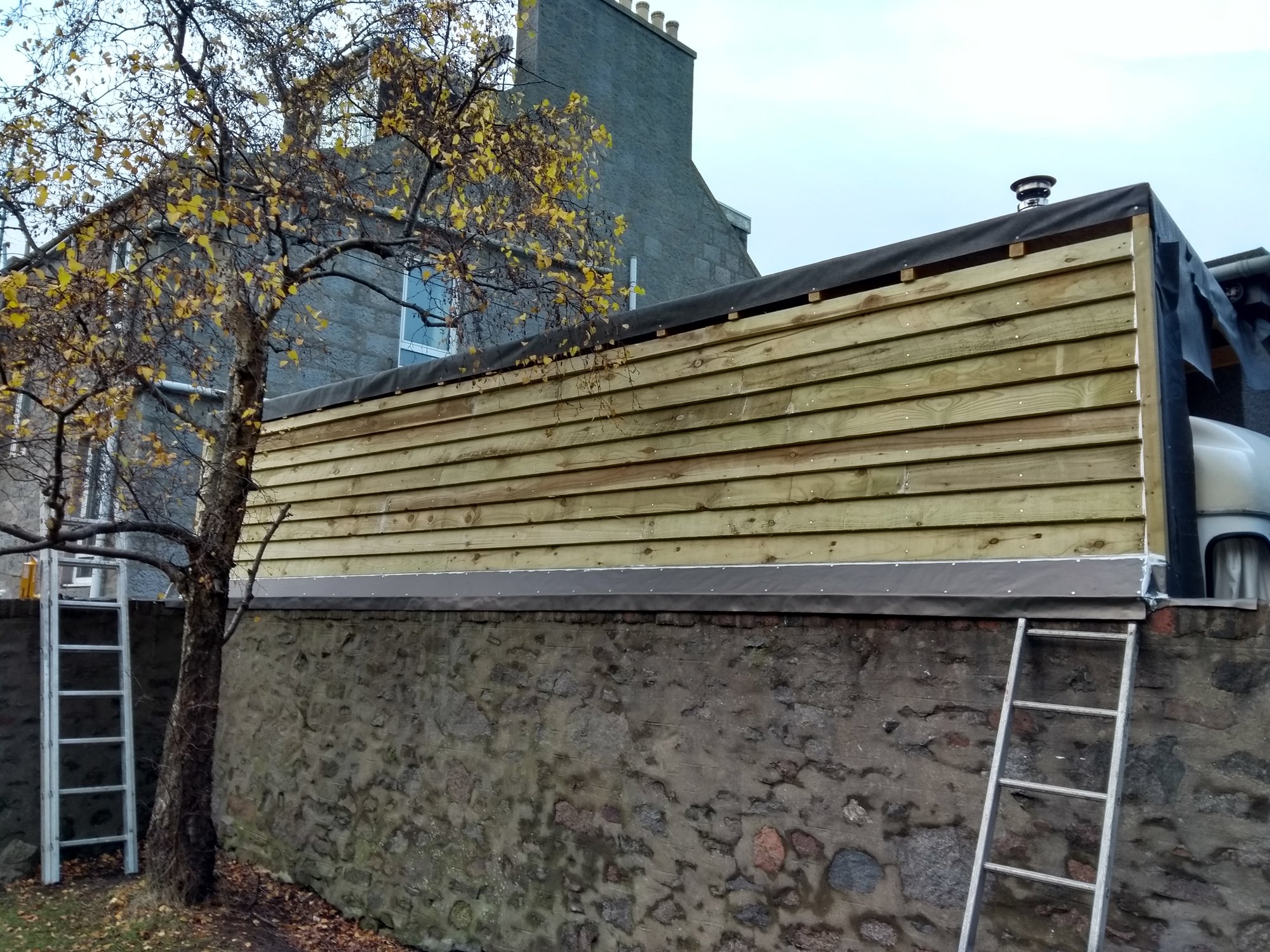

I bet your a happy chappy! Change for the better I would sayNow it is re-built from the inside I can re do the front when funds and weather allow.

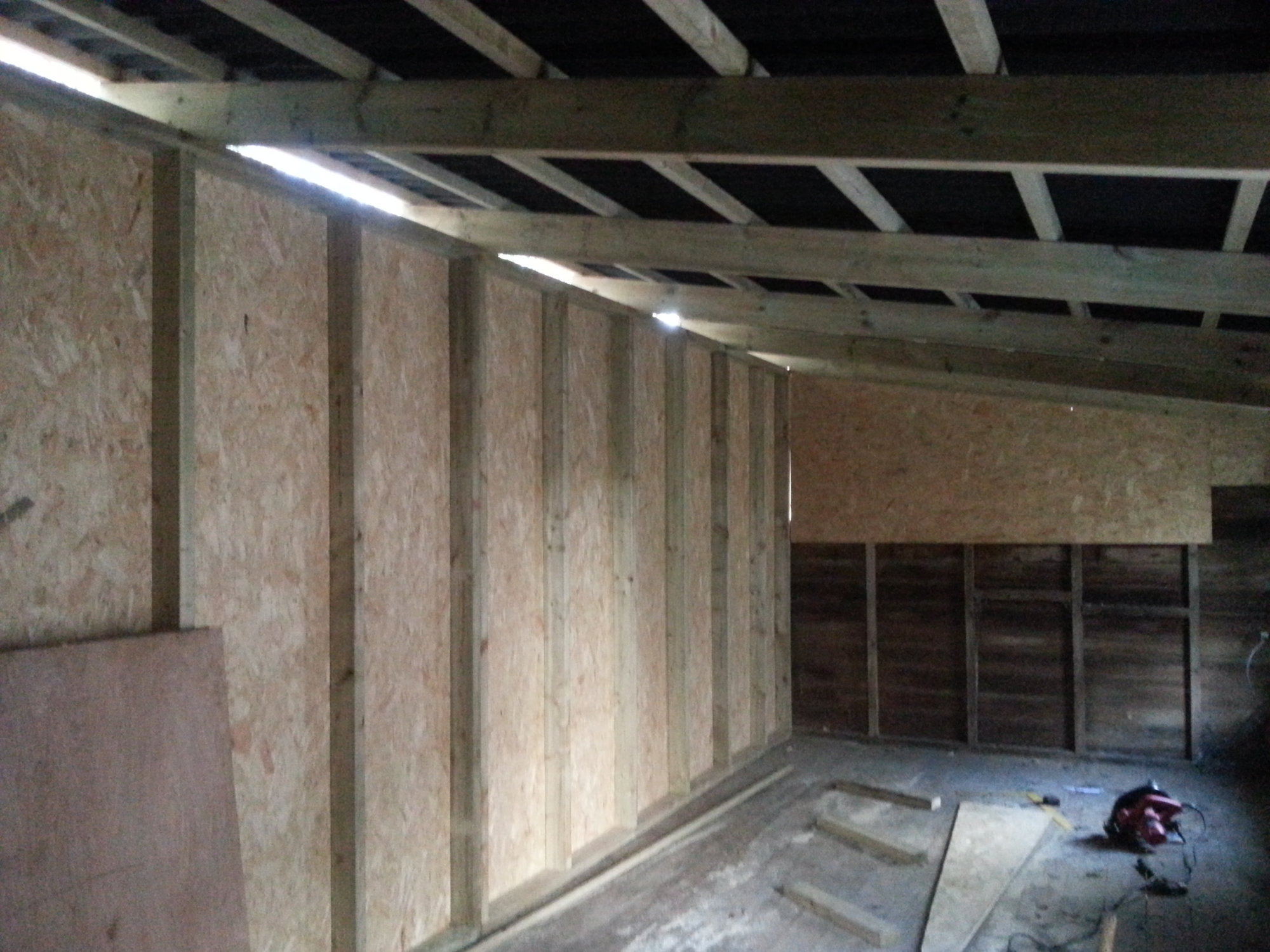

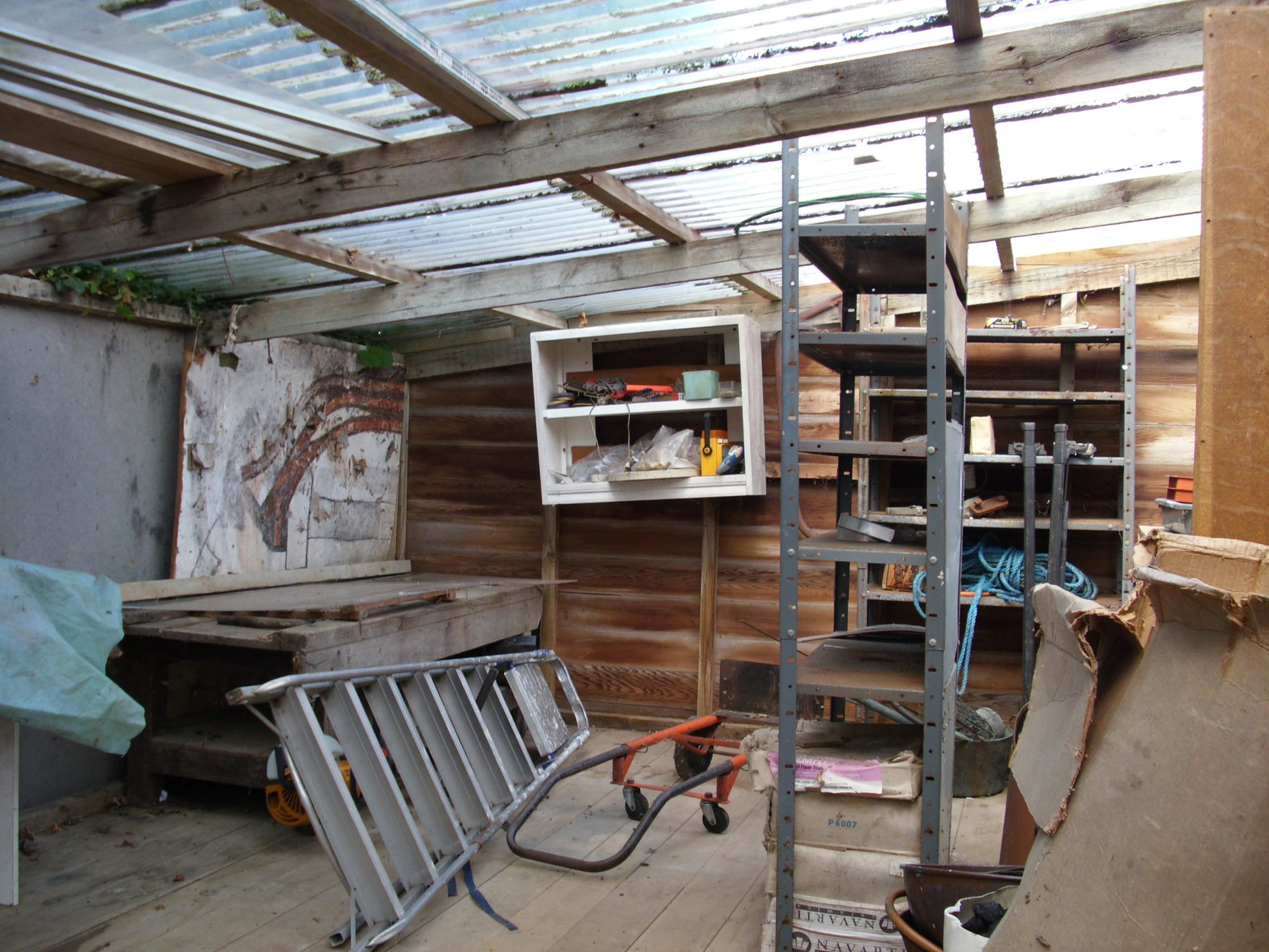

Yep lots of roof height - That was the big problem that the way it was there was only head height at the door, now it is 10.5degs up from there.

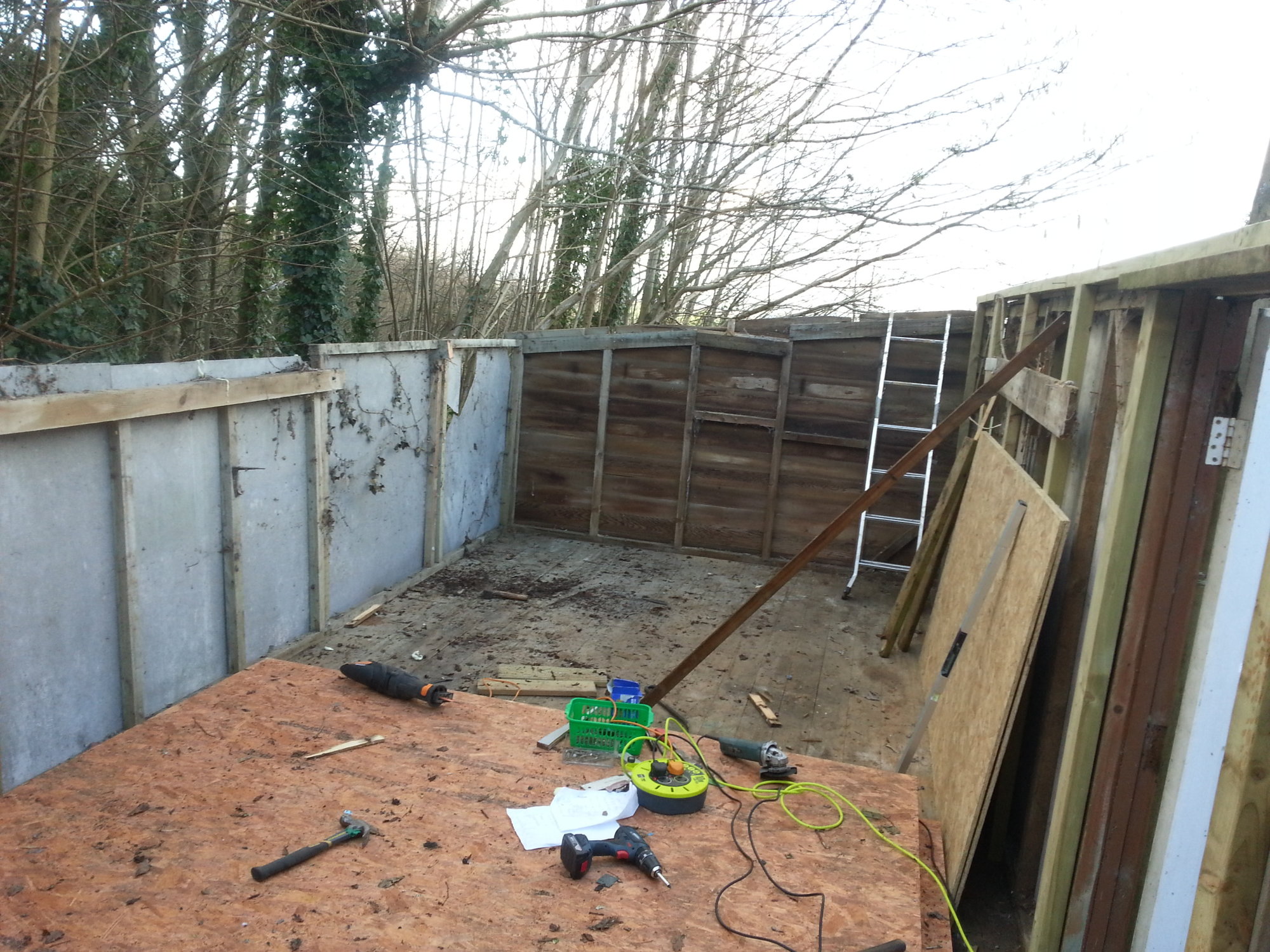

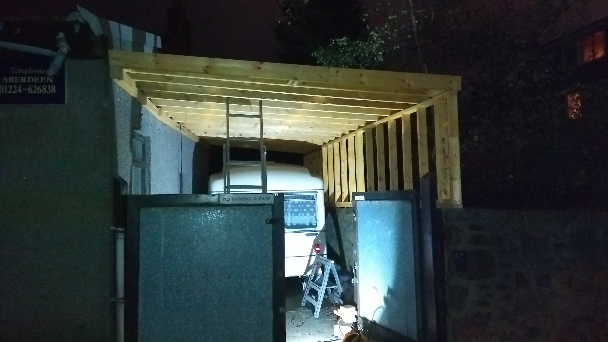

So I tore it down and put it up in one Friday (ok from 9am to midnight!). I prebuilt the rear wall in 2 sections inside the shed then just lifted them into position on the day. The front wall had to be heavily reinforced as it was very flimsy even before I took the old joists down - basically all the weight is now on new structure - you can see the front reinforcements on the right here, the OSB on the floor is the back walls.
im making him wait as a little bit of an eyesore as hes selling his property after 2 years owning it
