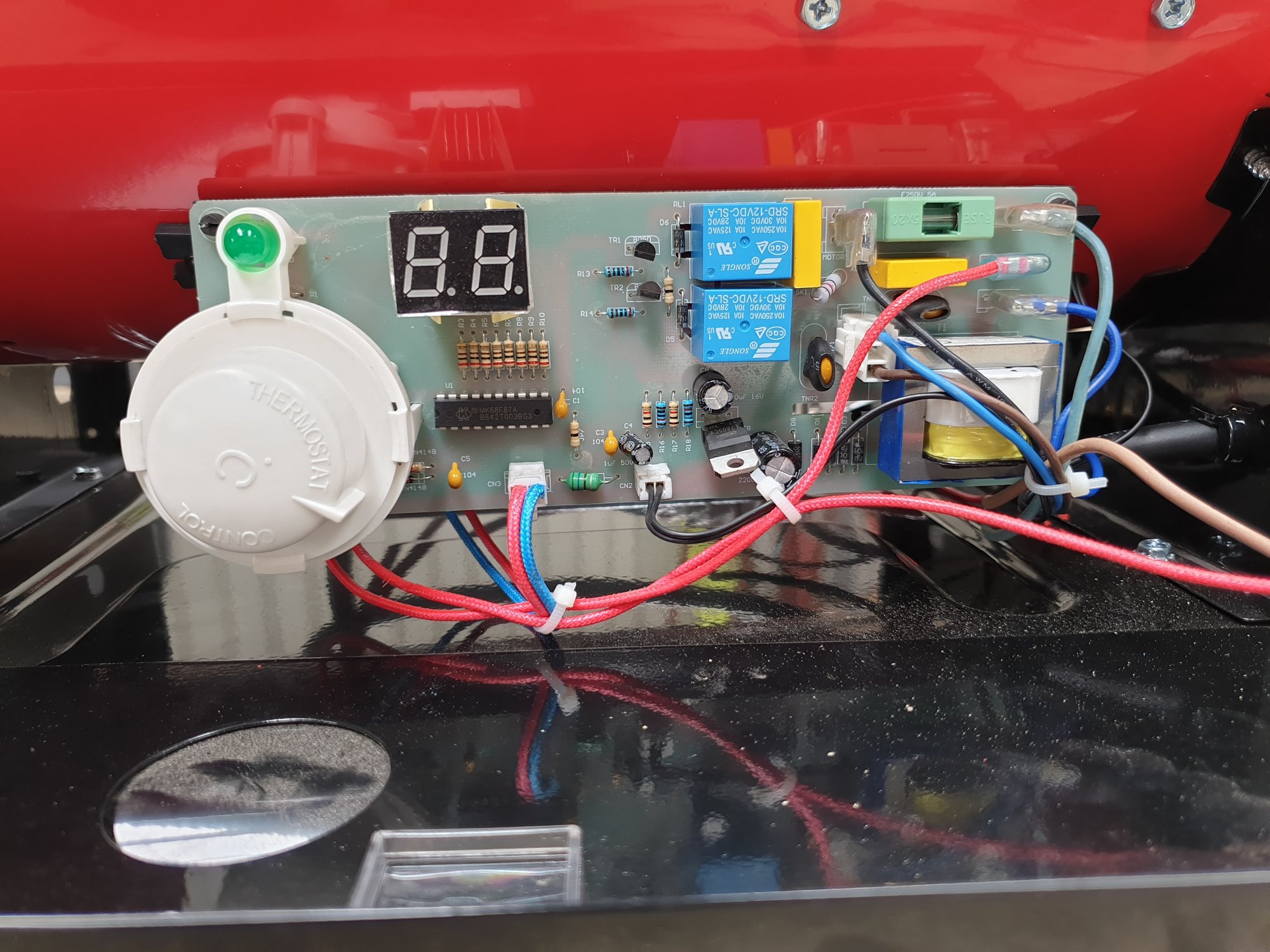

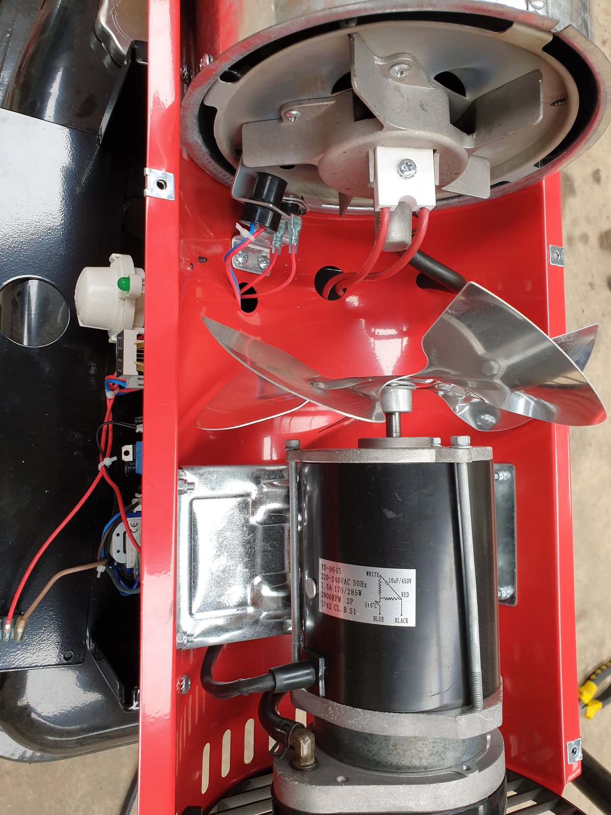

Hi just wondering if anyone has much knowledge of garage heaters and how they work? I have one that is nearly brand new only around 10 hrs of use but now when I turn it on it runs fine for mabye 20mins until it heats up then it cuts out and continually trys to reignite without success. It's a thermo static controlled one but I have the thermostat up full. I've checked the air and fuel filters which are both ok. Fuel pressure is around 5psi which also seems to be right. I have cleaned the photocell and then disconnected it and put in a jumper wire to bypass it but still the same issue. Anyone have any ideas of what could be the cause or where to look?
