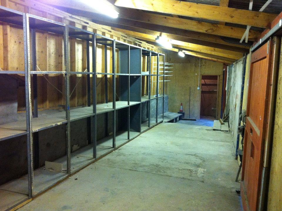

ive got a garage workshop which is the size of a double garage. Originally it was a single with a lean to but the PO built it into a double.
It’s got a pretty rough concrete floor, and the original single garage floor is dusty. No matter how much I sweep it just makes never ending clouds of dust.
Here’s a picture of the seam between the dusty original single garage floor (right) and the non dusty original outside floor (left).
What are the options here to make it flat, smooth and non dusty?
