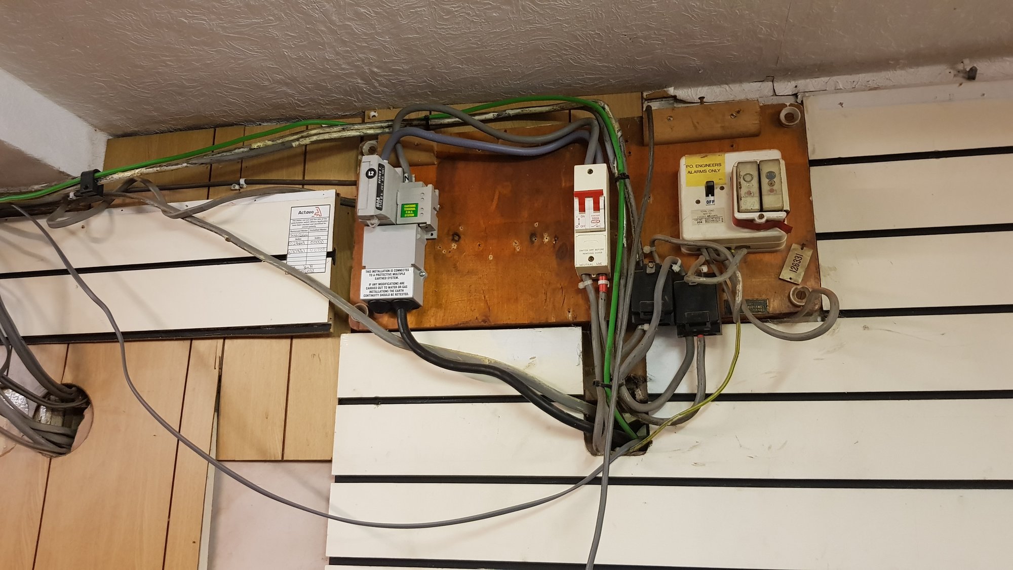

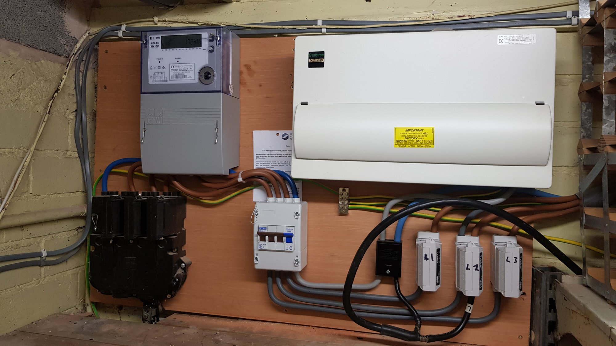

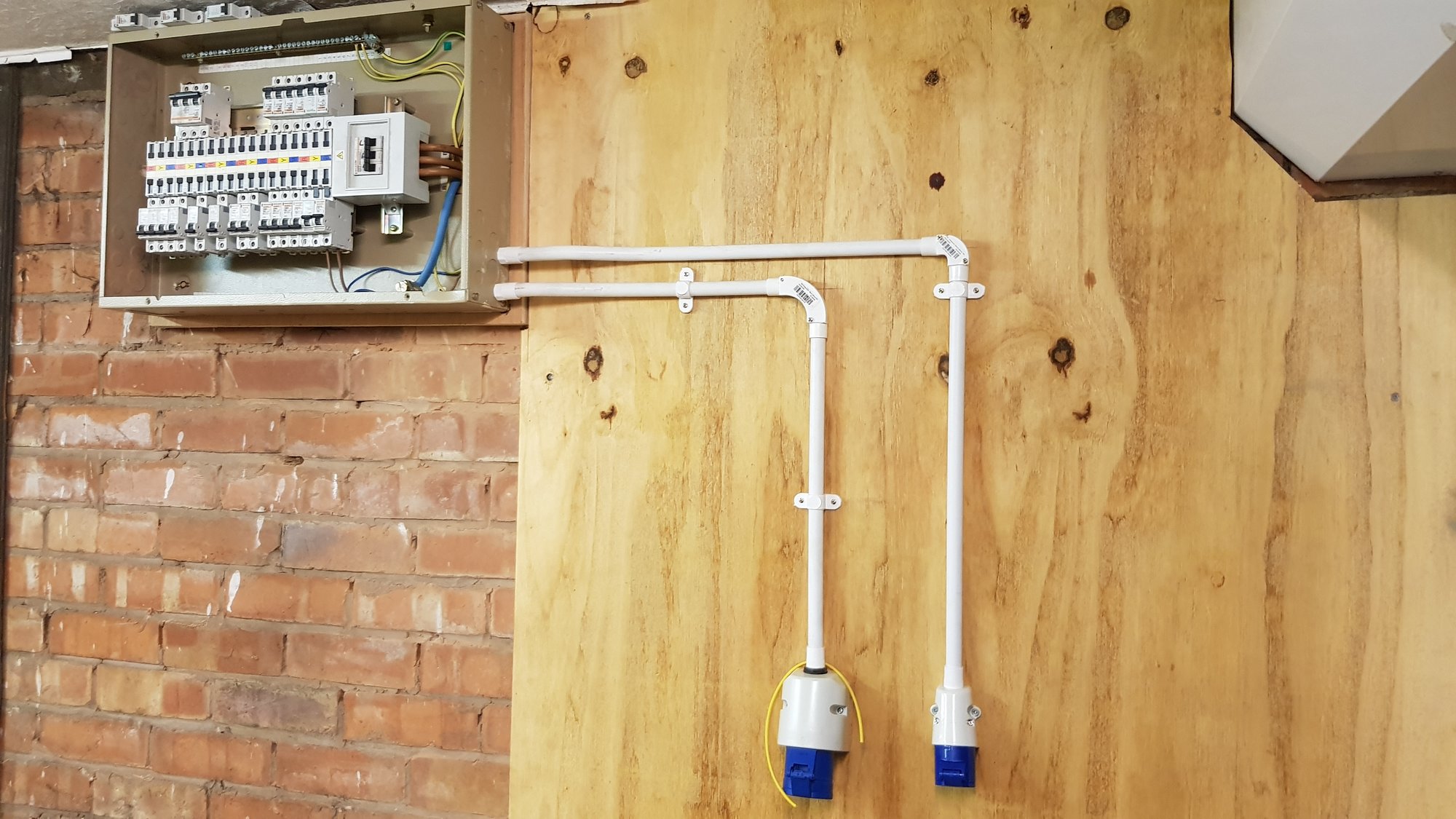

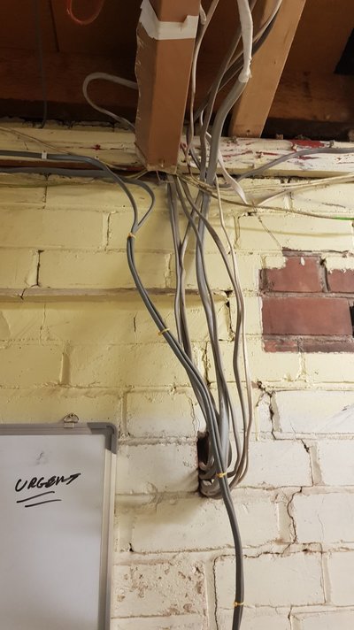

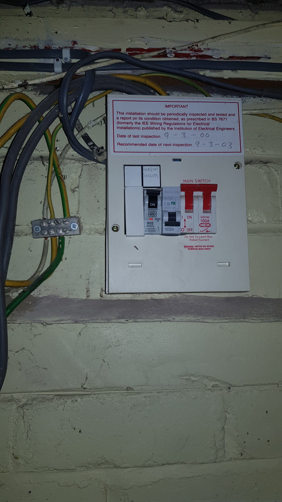

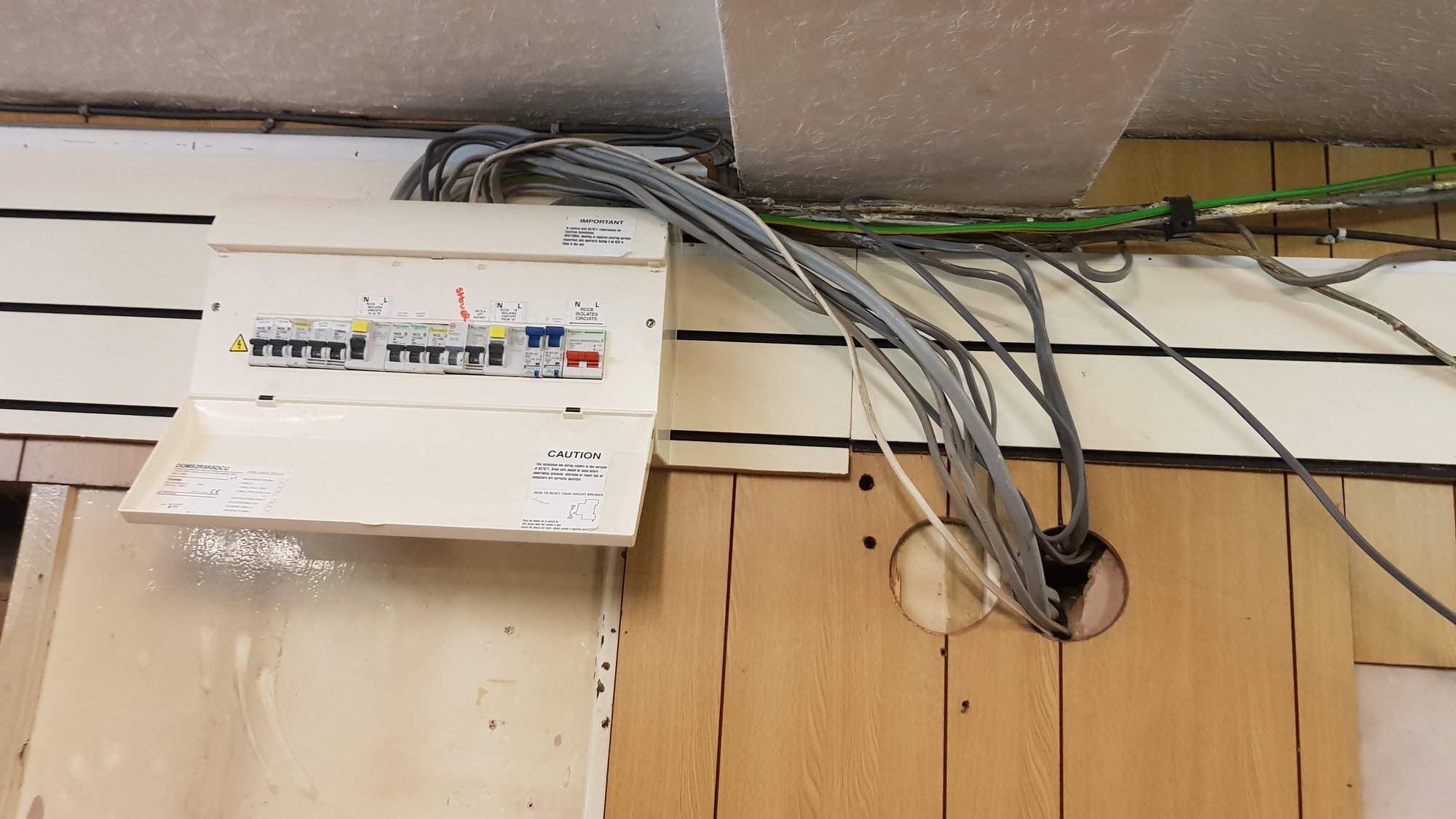

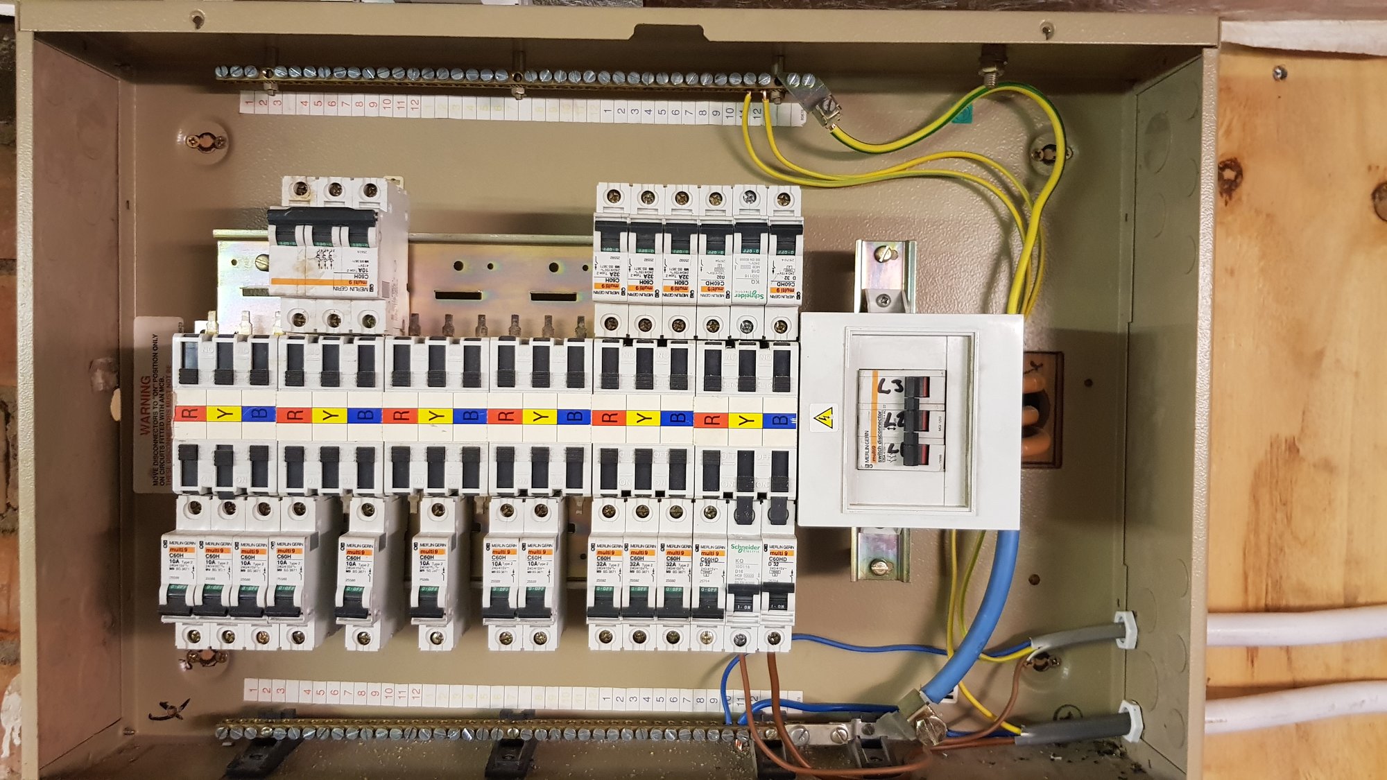

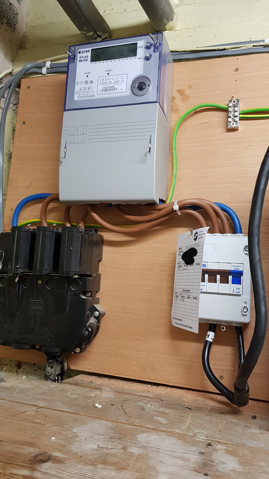

I moved house in early this year while on furlough, I'm now back at work so time is limited.
I've finally managed to get a 3 phase meter installed, replacing the old single phase unit, which involved changing power supplier...
So this weekend I started to prepare for a complete rewire, but the first job is the garage rewire, followed next year by the house...

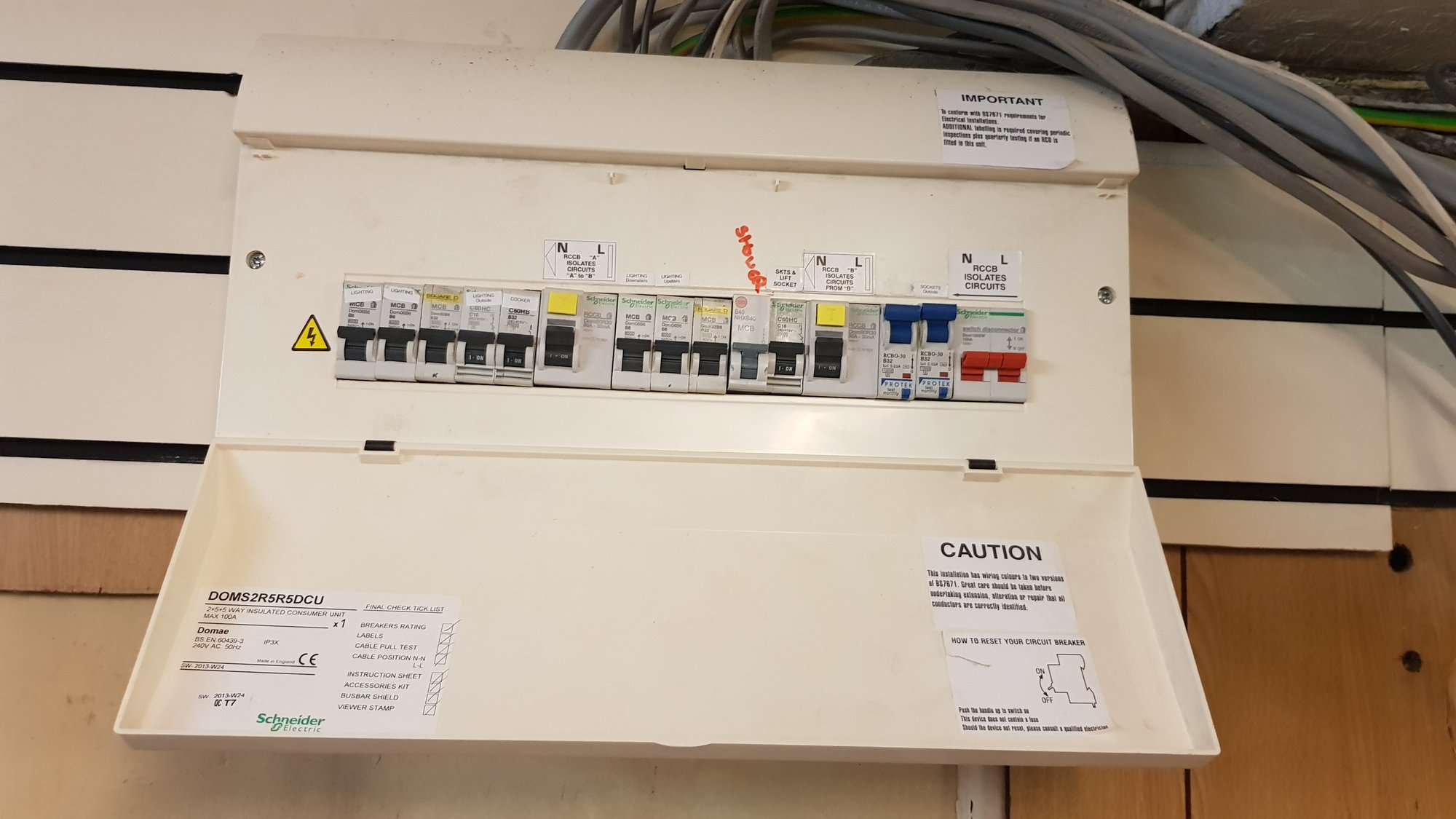

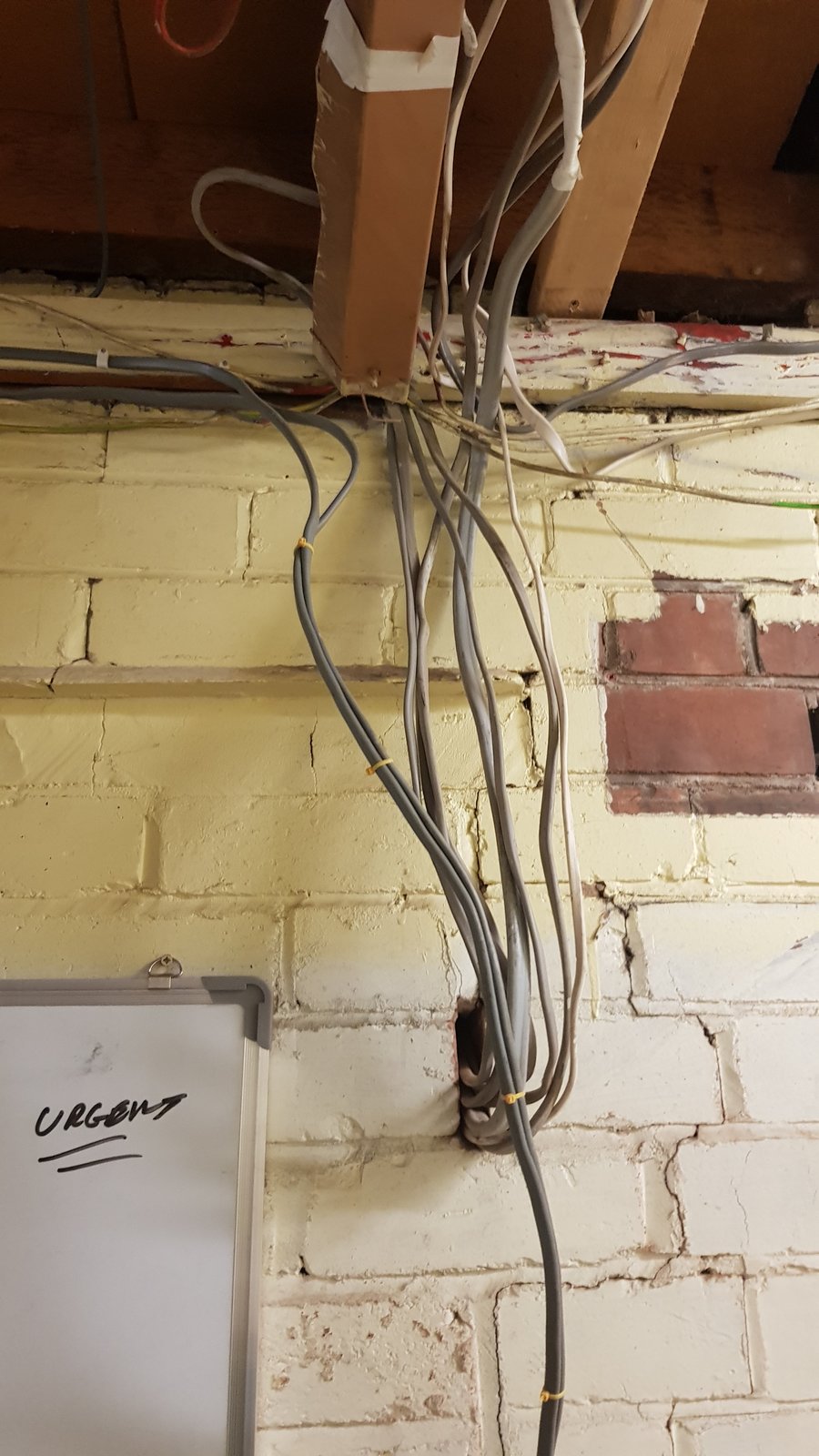

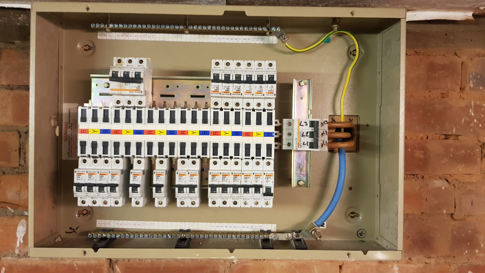

The wiring is a rat's nest, the garage (which was the old post office) has some form of ring mains lighting and power. The house has a mix of spur and ring mains, so a complete rewire is required.
I have a mix of domestic, semi- commercial, post office (Romec wiring) and a house/post office alarm system.
This weekend I installed mains fuse holders, a new consumer unit for the house and a 3 phase distribution board for the garages power supply.
The first 3 pictures are of the new install, the rest are the old consumer unit and rats nest wiring which will be removed next year after the house rewire, don't cringe to much.
The black armoured cable in the 1st and 2nd photo is the supply cable for the old consumer unit, now a temporary supply.
