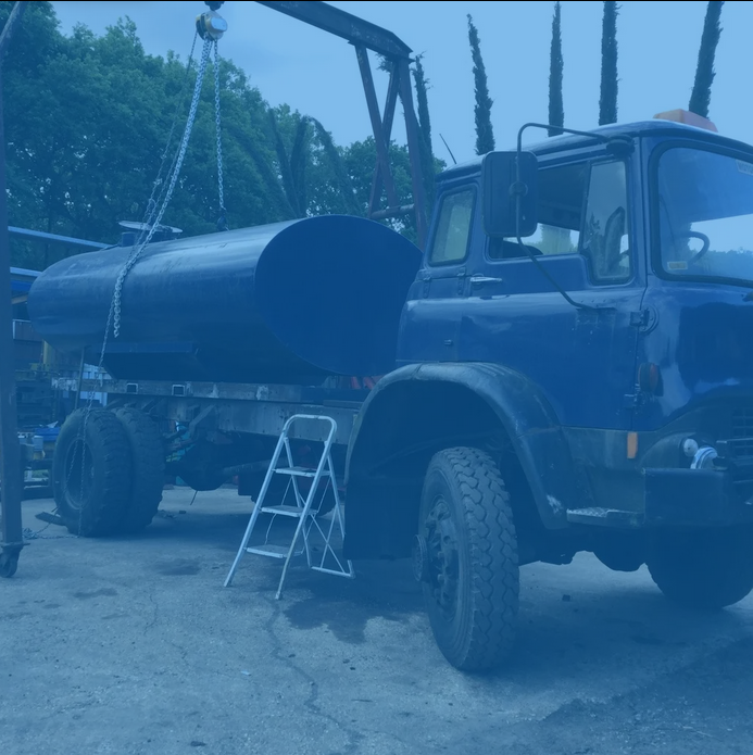

The "I" beam on my gantry is a 178 x 102 x 19 section beam, 2700mm (9ft-ish long), I've tried looking for single point loading capacity chart for this beam length/section, I can't make head or tail what i can find online.
Does anybody have a chart I can understand/read or do you have the knowledge to edgeumkate me........
Kos, I ain't got a scooby, I reckon it should be good for 750Kgs at least, just asking out of interest for the recommended max structural loading before I really test it........
