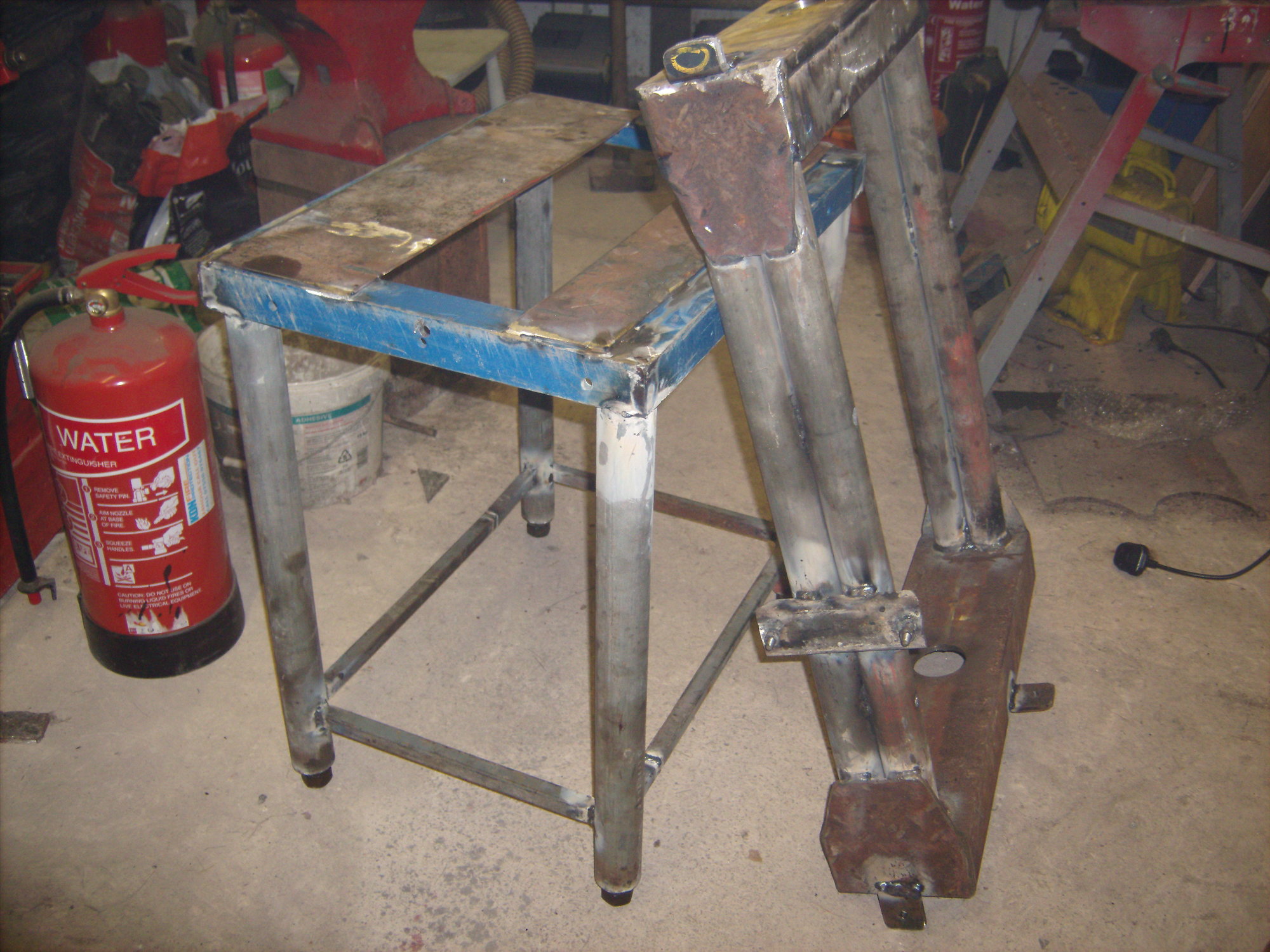

Day 3 of coughing, chest rattling, feel sick and dizzy when I bend.
Welded some galvanised scaffold pipes together for a frame to set the hydraulic press frame on that I'm making. Was'nt weather due to rain on Thursday to do the job outside so I did it in the 'too small a shed', had fan blowing on work, ground most of the galvanise off the weld area but it's still inside the pipes, at times the atmosphere in the shed was light blue and white fluffy stuff floating around. Well another lesson learned.
DON'T WELD GALVANISED WITHOUT ADEQUATE VENTILATION.
