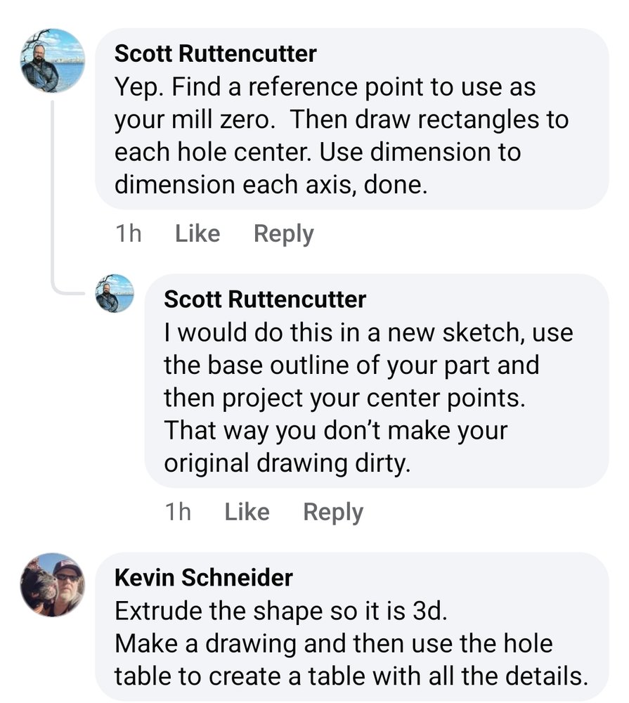

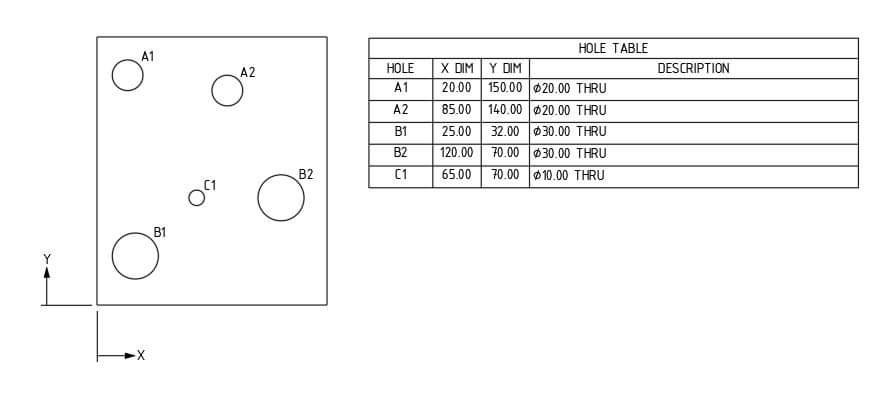

In SolidWorks there's a Hole Table feature for drawings that automatically creates table for holes with x and y coordinates. Probably there's a similar feature in Fusion.I don't know (and don't like) Fusion, but I would expect one of the quickest ways to do it would be to create a drawing of the part and just dimension all the holes from some fixed point.

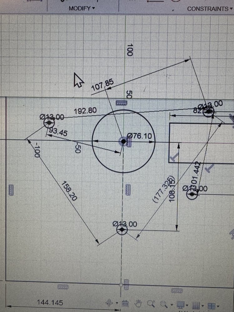

If the holes need to be sized quite accurately then I usually cut them slightly undersize with the plasma and then drill to finish. The accuracy of the positioning should be good with the plasma.Efficient isn't the main goal, i just want to do it more accurately than the plasma (which will cut the external profile.

yes the third reply echos a post i found on the fusion forumThese replies any good?View attachment 461417

Yep, all i've got to do is reference the 3" centre hole as the origin/datum point.
Glad it made sense to you...lol. it's all gibberish to me currently.Yep, all i've got to do is reference the 3" centre hole as the origin/datum point.
He just posted this...not sure if it's any use.
