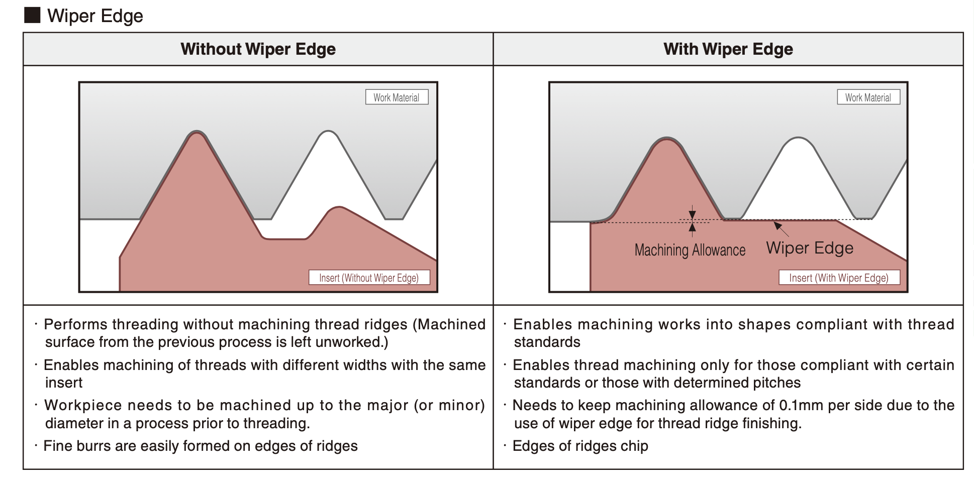

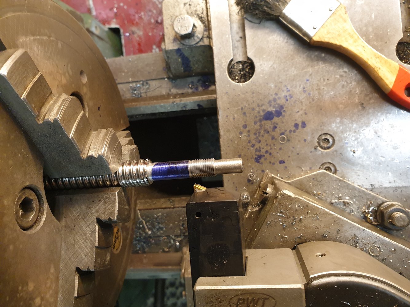

Novice question, when using a full profile thread cutting insert, do you leave the stock slightly oversize and then cut the crest to the correct size using the full profile insert?
If so what is the ratio, how much do you leave the stock oversize and how do you know when you reached the correct cutting depth? For now when I get close I try on the nut repeating this step until the nut goes on smoothly.
