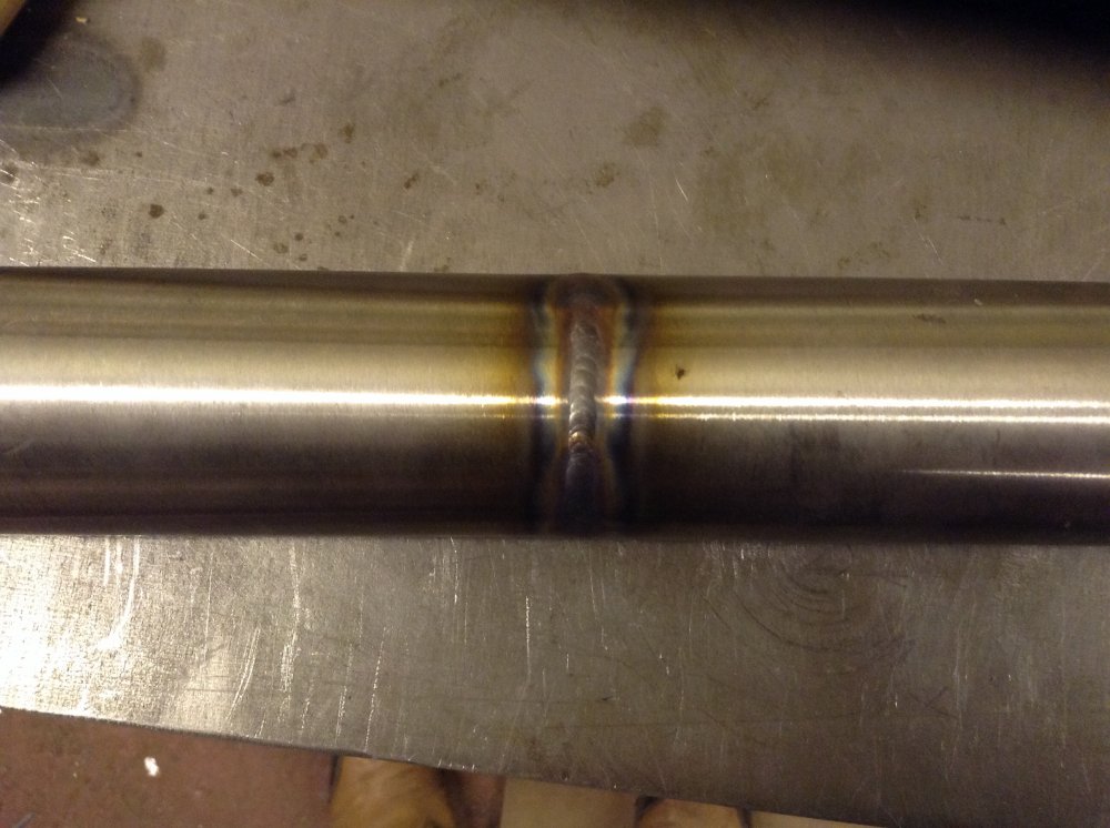

I am trying to get full pen butt welds on 50 x 1.5 stainless tube right.
I can get full penetration but am struggling with the colour.
Tube is 304 using 308 1mm rods,arc length is ok and filler kept in gas shield
throughout.
using 37 amps no pulse,1.6 lanth Tungsten,gas lense 7 cup
Have tried with gas from 5lpm upto 10lpm with no real difference.
There seems to be a very fine line between moving quick enough as not to overcook it
and getting the penetration.
Is it necessary or possible to get full pen and keep the colour to gold rather than brown/grey?
throughout.
