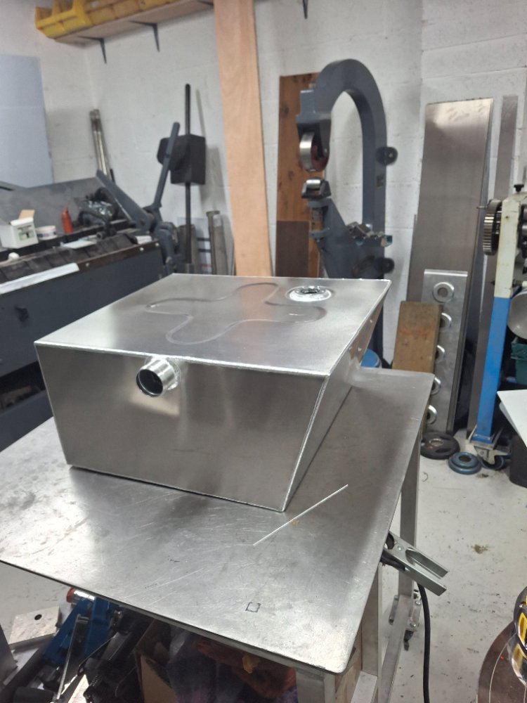

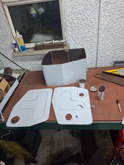

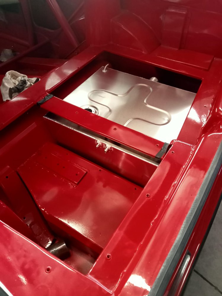

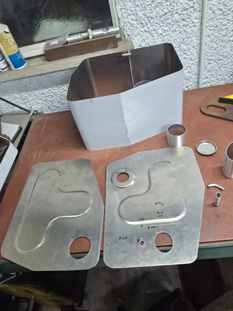

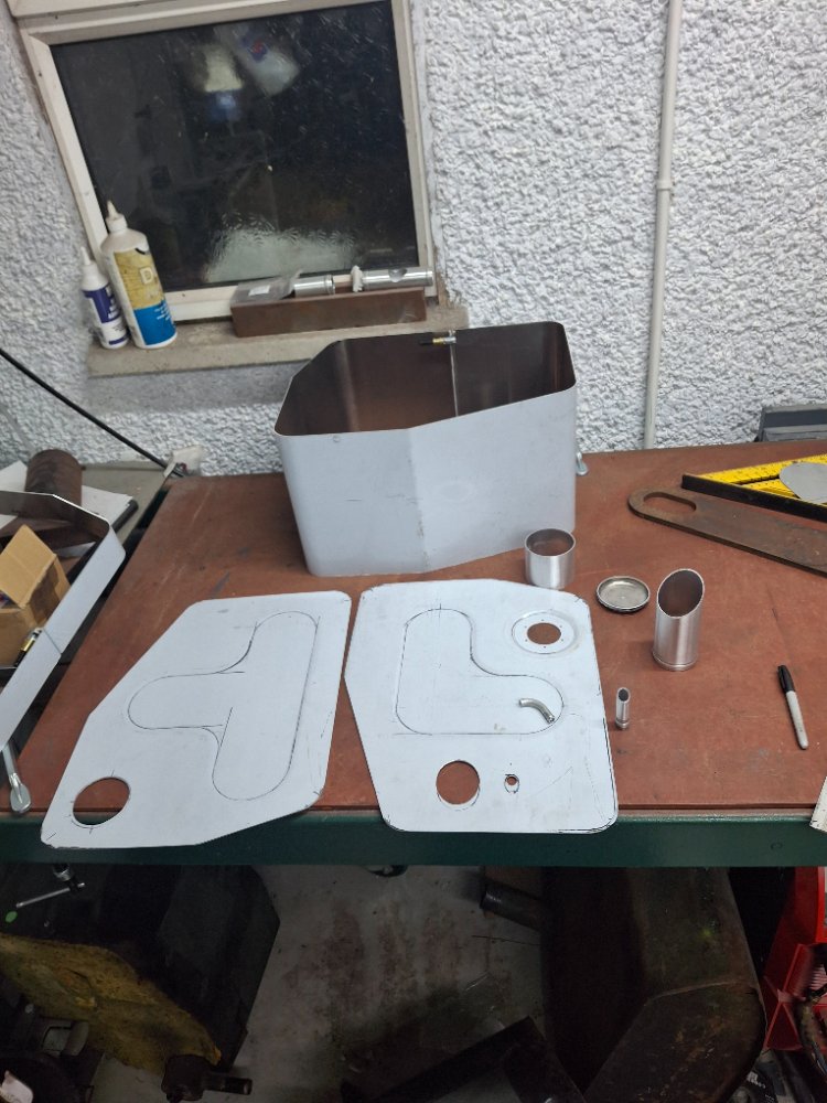

C Cheesie Member Messages 1,260 Location Lisburn Friday at 6:32 AM #1 A bit of bead rolling and pressing on this tank to try and cut down on warp, the stpe roller was made from derlin rod, the other tank is for an esprit IMG-20260428-WA0001.jpg 97.9 KB · Views: 32 20260422_215825.jpg 103.7 KB · Views: 31 20260406_202933.jpg 123.8 KB · Views: 33 20260406_202914.jpg 134.4 KB · Views: 31
