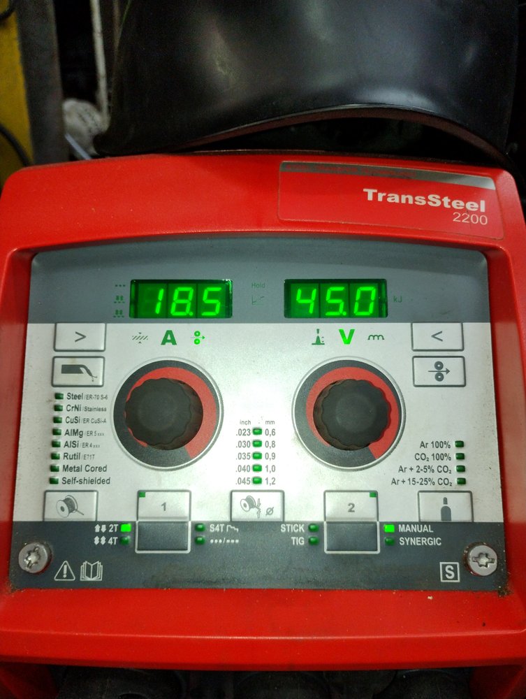

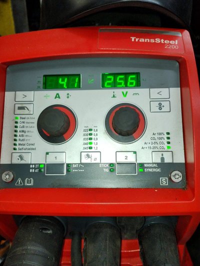

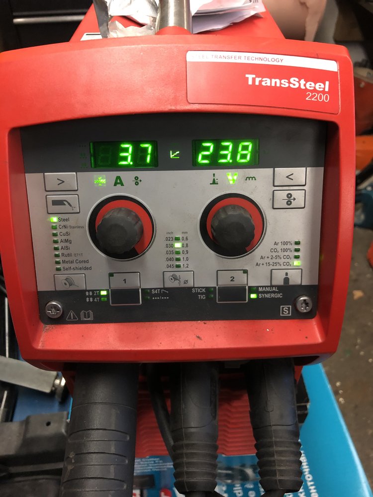

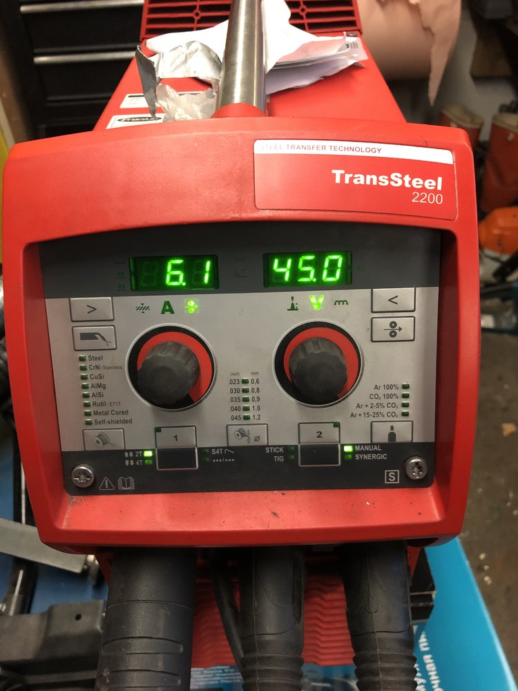

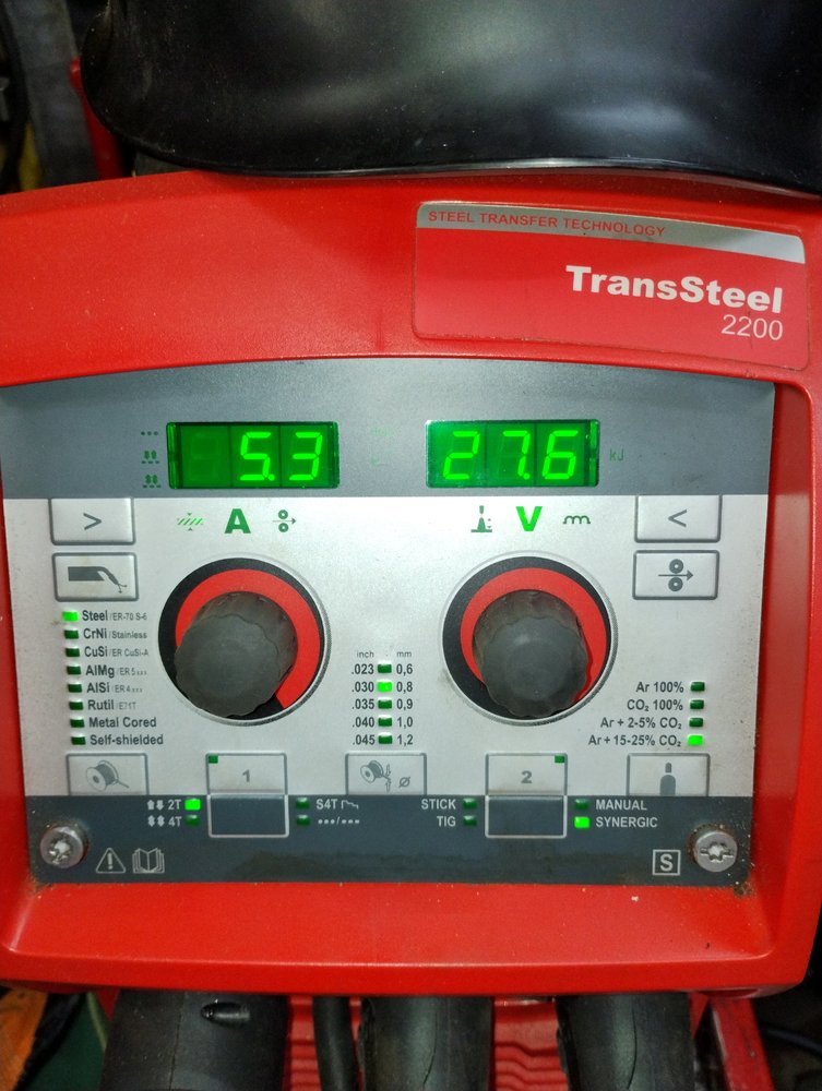

I have now tried it and is a bit uncertain if it still has something wrong.
one thing i noticed is that when I select 0.8mm steel wire and 75-25 gas in synergic mode I can only adjust the material thickness up to 3.7mm and it reads 23.8V
and in manual mode I can turn the Volts up to 45… I have not tried welding with this setting though.
I am wondering if there is anyone else with a transsteel 2200 that can tell me what the maximum thickness can be set in synergic mode with 0.8mm steel wire and 75-25 gas settings is?
I am a bit unsure but i think it was something like 5mm?
also can you really turn the volt dial up to 45 in manual mode???
