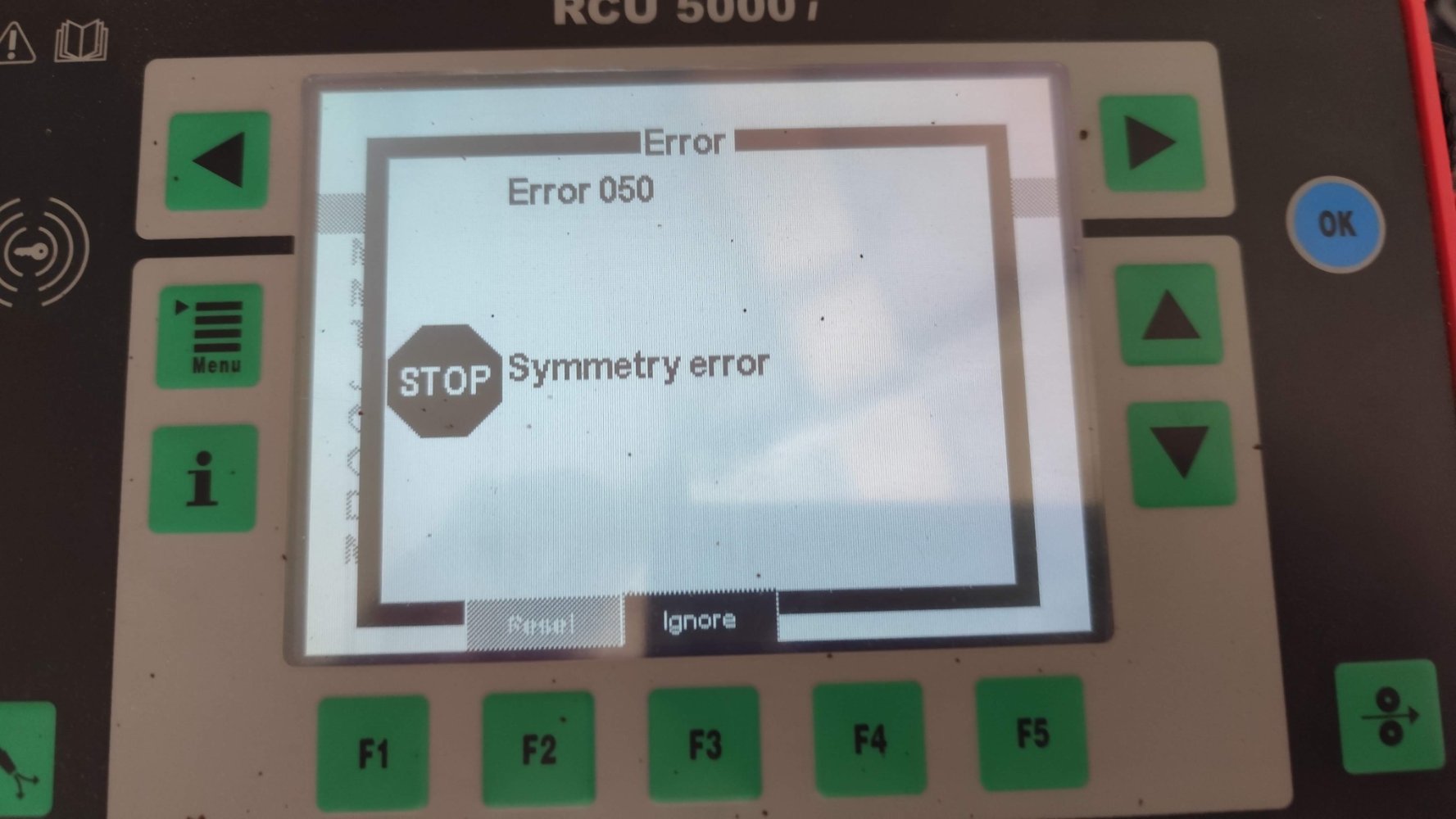

I have Fronius TPS 4000 CMT that was sitting in storage for a few years and now I powered it ON and there is 050 Symmerty error. Last time I used it everything was OK.

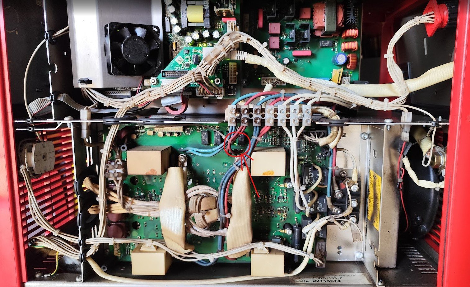

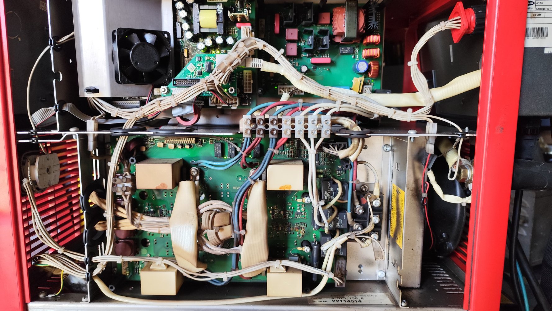

I checked three phase power supply and it looks OK.

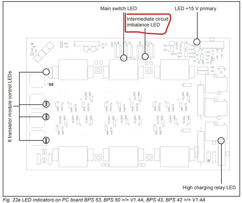

Only thing I found from manuals is LED on PC board BPS that should be maybe related with my problem. Red arrow on attached picture.
Has anyone had experiance with this error?
