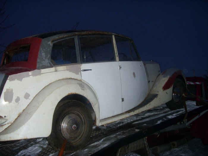

My first restoration and Am about to cut three or four inches off the bottom of my rear wheelarches. Replacements are unavailable but luckily the car is early fifties and not too fancy so hopfully I will be able to bash some steel into the right shape. My questions are:-
Should I lap joint or butt joint? should I weld from behind the wing? should I tack untill the weld is continuous or tack every half inch then use filler? and finally if a lap weld is preferred do you weld both overlaps front and back?
Have scoured these pages for above problems but could not find similar questions. Probably because everyone except me knows the answers!
Thanks in advance
Ron

and do a but joint with a step behind it that way you wont be blowing holes
