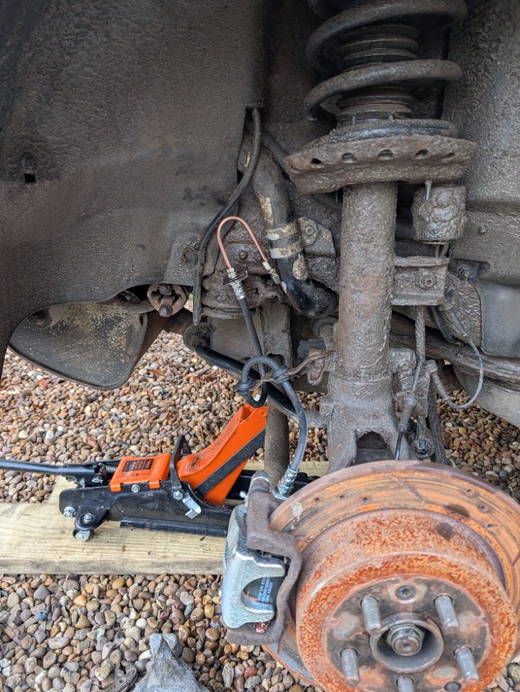

I replaced the discs and pads on the Freelander 2 a while ago
No major dramas except the nsr slides were seized so needed a new carrier, also put new slides all round
Osr seemed a bit noisy and hot the other day, seems the caliper has seized and worn the pads down so new caliper, pads, Flexi and because of rust a short bit of pipe from the Flexi
All done now, ready for a trip up north
