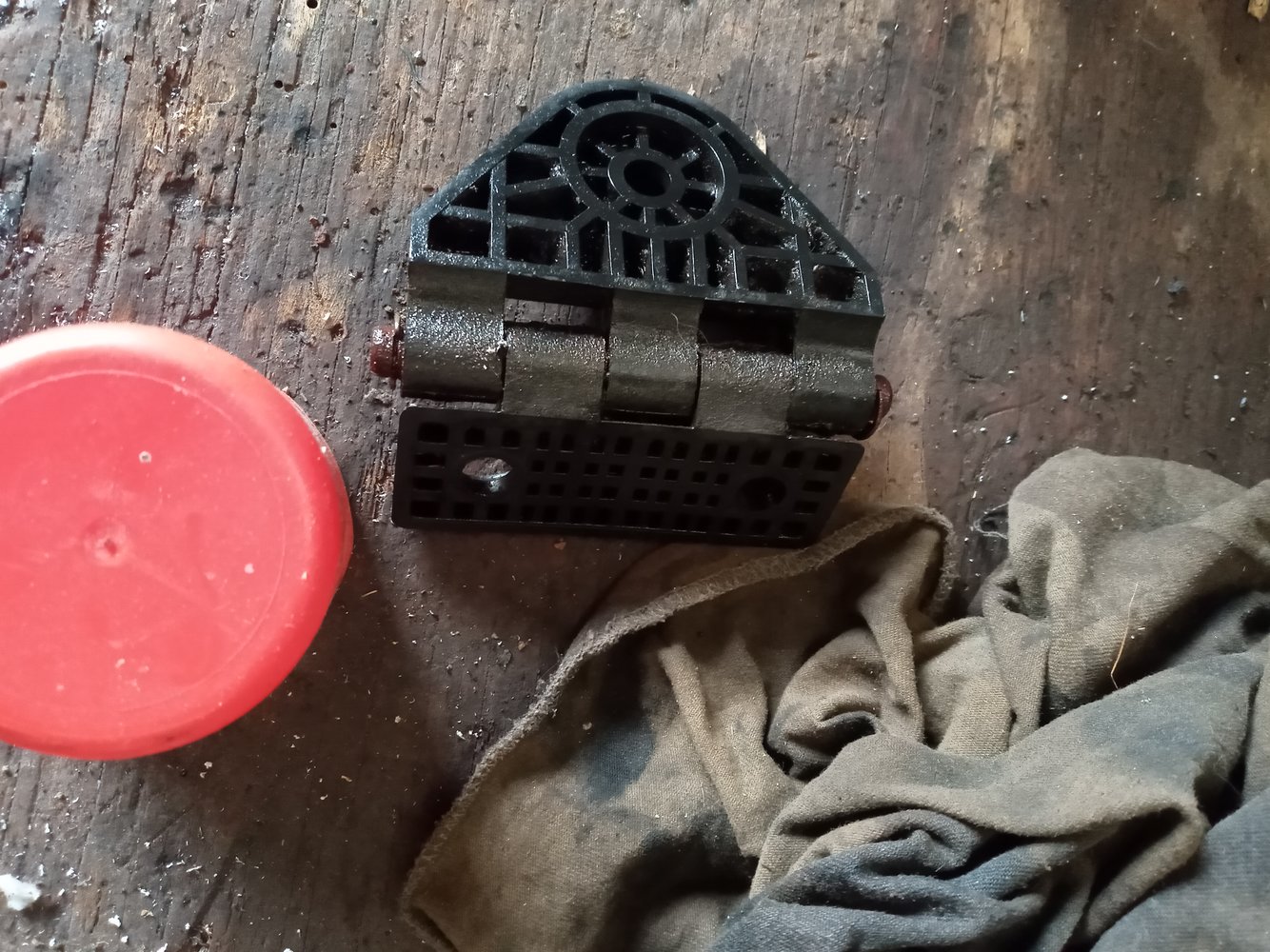

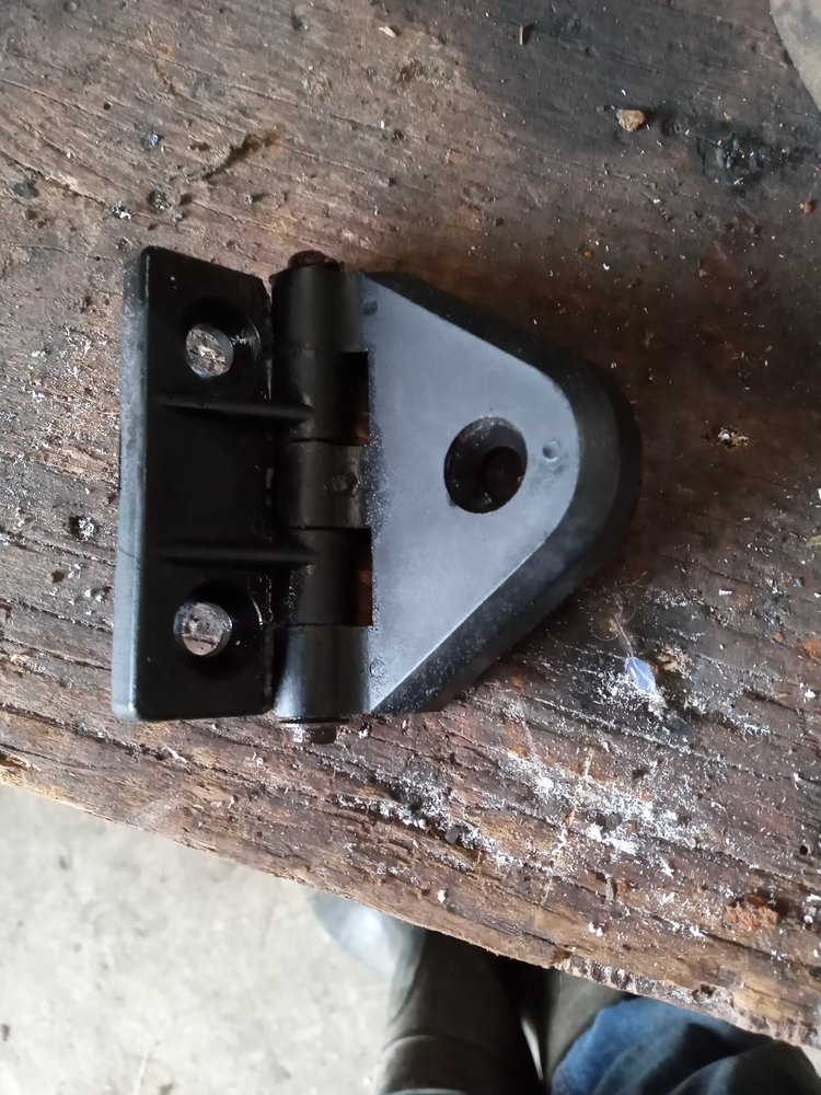

Citric is your best bet.
Maybe we need to add that he should clean all diesel and oil residue off the part first.
Clean it well in very hot water with added detergent (washing powder or dishwasher powder).
The citric won't cut through any oil.
A question more than a suggestion: would electrolysis work? I am thinking not as the rusty parts are not exposed.
I'm really impressed you could recognize that.Is that a rear window hinge off of a Massey Ferguson?
If so I'd try acid as above before drilling. They are silly money to replace.
