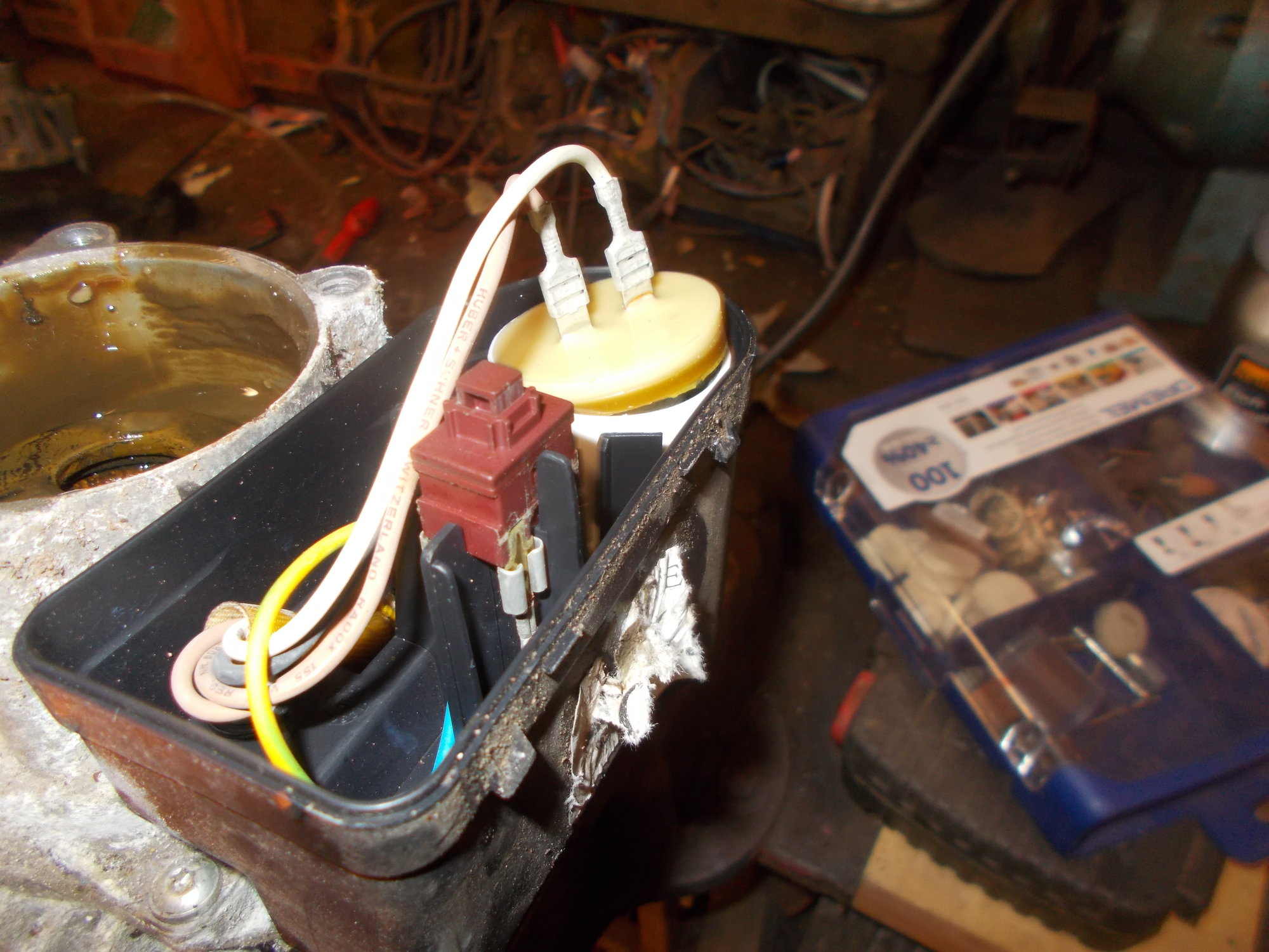

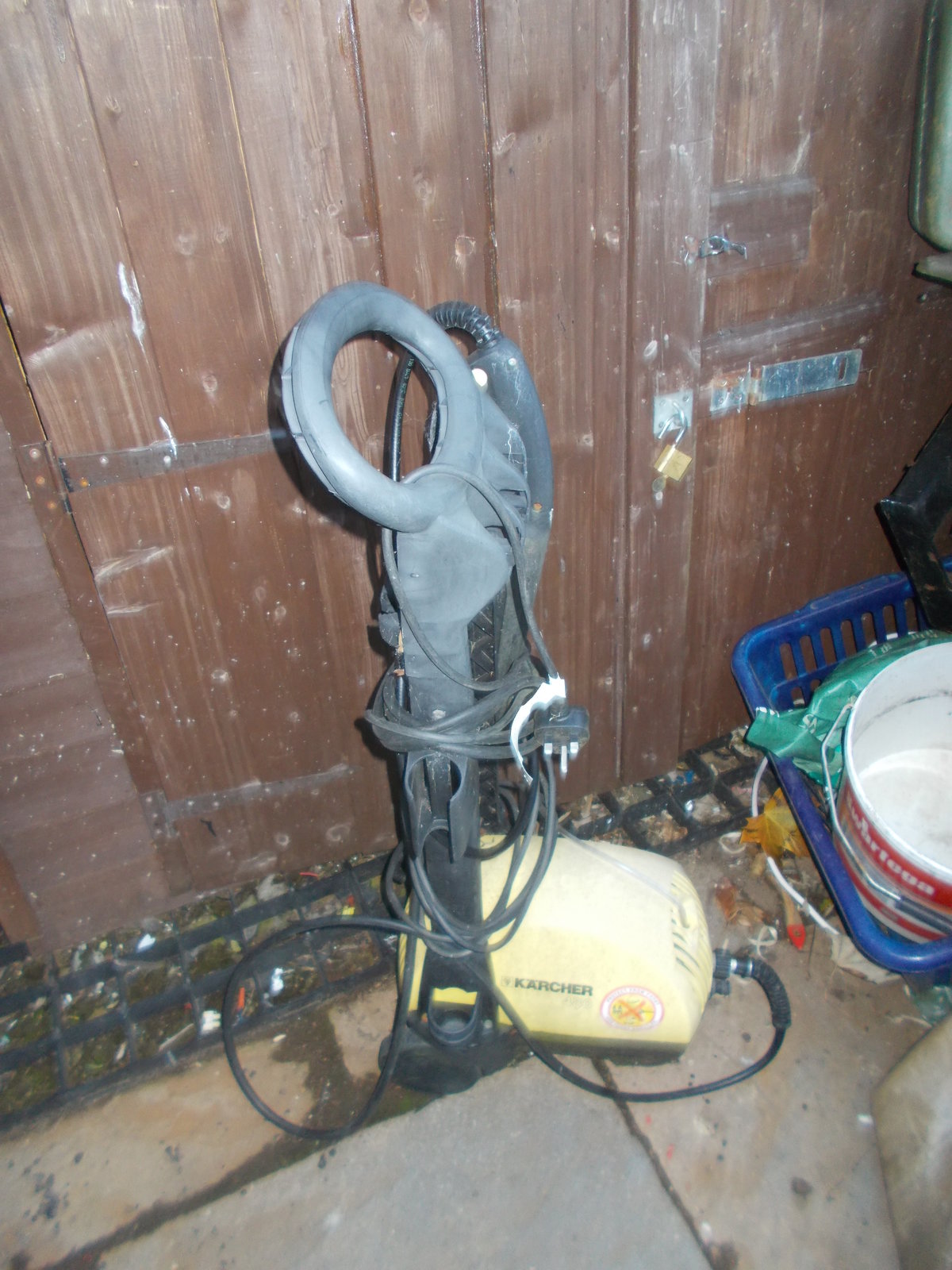

The other week I got my hands on this pressure washer.
It worked, so it was put to hard work.
Used at least 2 times a week and for about 3 hours each time. Yesterday when I was washing down an engine it died.
Motor sounded like it was seized and trying to run.
So up on the bench.

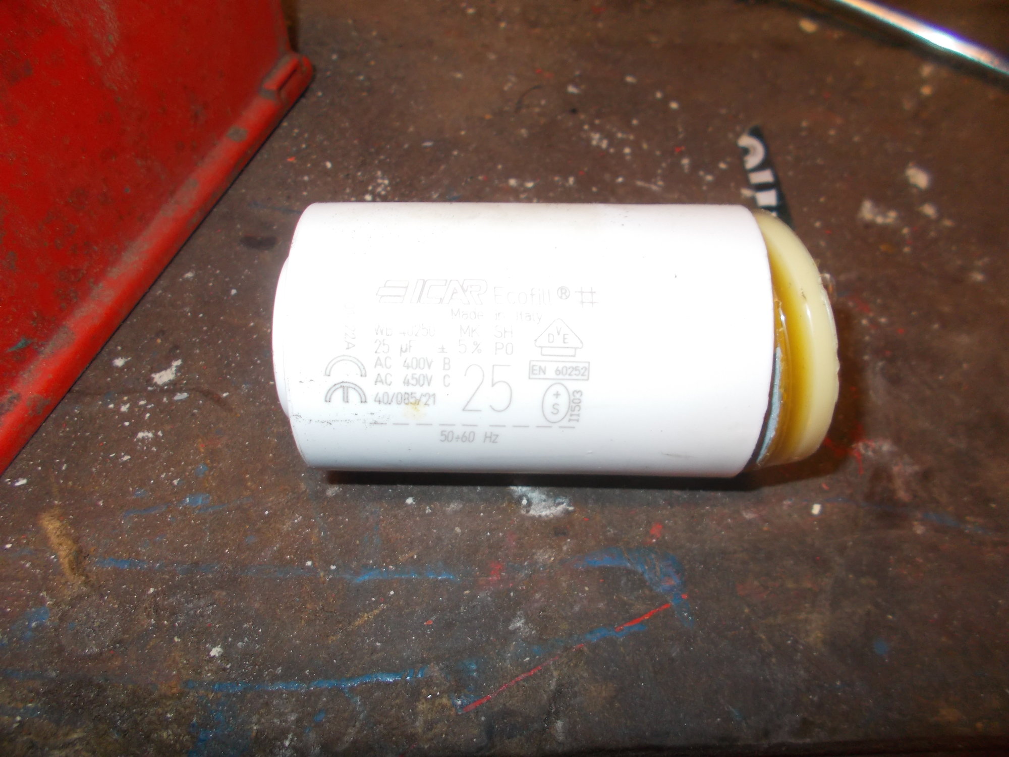

The motor was free, the pump was working. So open the electrics part.
Hmmm I wonder what can be wrong.
As it was free and I have another one it will be stripped for spares and scrap.
