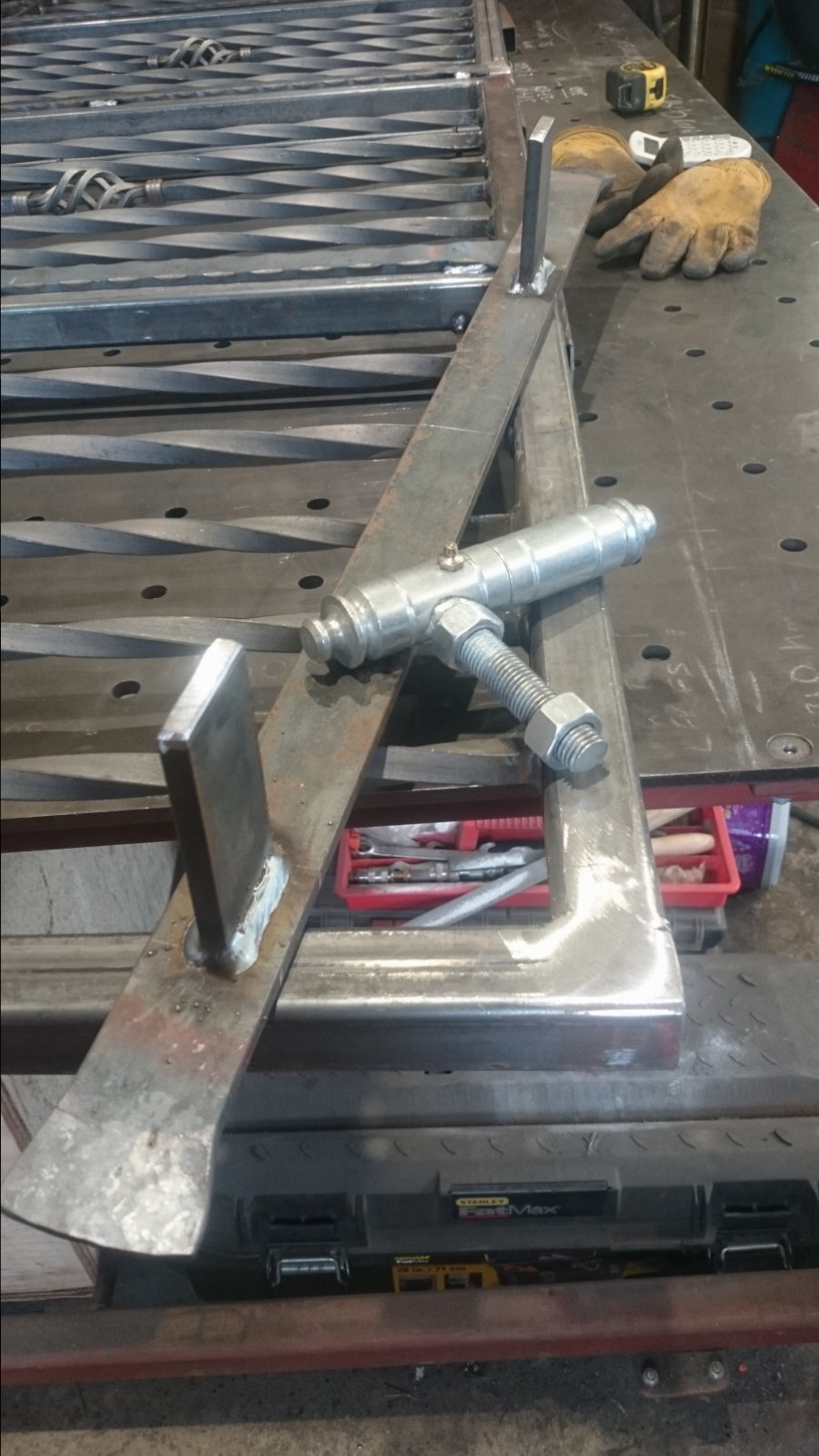

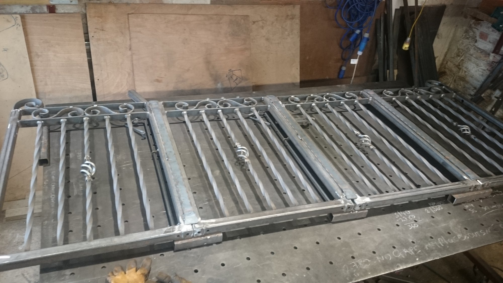

Existing brick posts broke, as always got my disclaimer against such unknowns. Will be doing a re-fit. Foc once I get off the fitting and welding contract I am on presentlyPlates 50x 10 forged end wall plates onto brick pillars four m10 resin fixed studs into the brick
40 mm diameter barrel hinges 2 per side
Not quite, the customer knew one of the posts were past it. We decided it was worth a go still. I always get a disclaimer signed on dodgy looking posts. As it happens the other one snapped actually fracturing the bricks not the mortor. Going back to refit again but on a contract through Jan and into Feb 7 days a weekLooks very sturdy if not to say massively heavy! I guess it pulled the brick pillar over with it?
