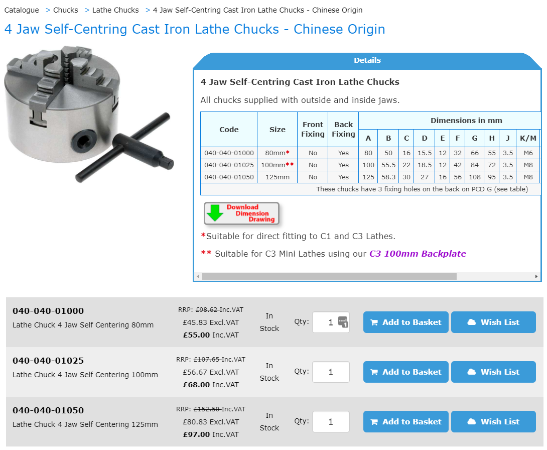

I went through a phase when my 4 jaw s/c was on all the time. I don't know why I stopped using it.
convenience and speed . will do 95 percent of jobsA self centring chuck be it 3 or 4 jaw will never be as accurate as a collet or independent chuck, but is usually good for 90% of the routine work out there.
In industry there is a move towards more jaws - 6 is fairly standard now for the increased grip.
Just the same way as a 4 jaw has more contact points - it tends to be a better choice as it holds square in addition to everything a 3 jaw can do, it's just tradition that keeps people using 3 jaws!*
* ok, there is one point, a worn 3 jaw will still grip using all three jaws albeit off centre; whilst a worn 4 jaw may only grip on 3 - just like a 3 jaw!
Perhaps the question should be "Three-jaw self-centring: why?"
I'd be interested if you decide to move it on.![]()
I was just about to say that..
I have a 4 jaw that all the jaws tighten on one square. but the square bit they tighten on was broken off when I got
it, so I use it as a normal 4 jaw.
