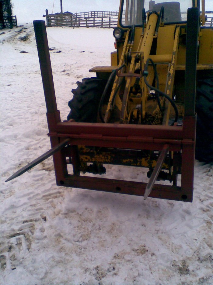

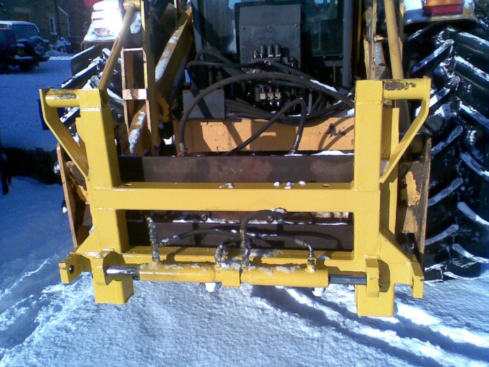

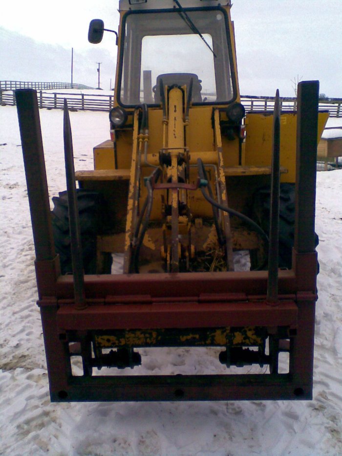

Here's the first project with 400 amps to play with, an adapter plate for one tractor loader to take quick hitch buckets etc from a jcb loadall. Hydraulic locking pins too!
All 80x80x5 box section ( ex scrappy) and hyd rams from used stock. Hyd rams outers have been shortened to provide 6" movement, end 6 inch of ram shaft will not damage seals if dinged as it stays outside the ram.
Well chuffed, Neil
Well chuffed, Neil
