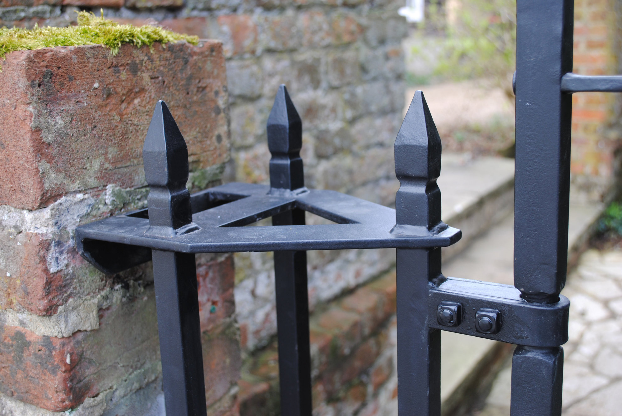

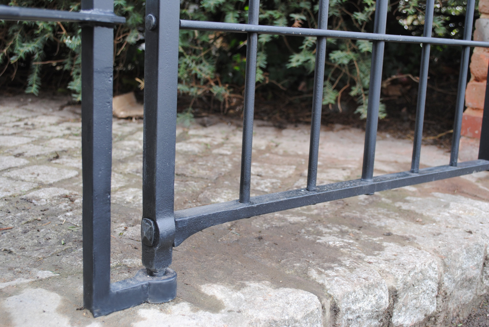

That's just a little variation on a very old system. Usually the pot that the back stile rotates in (the bottom bit) would be independent so it can be moved around or be lowered by drilling deeper into the ground, but that stone is granite & that was a battle I didn't want.possibly weird but I particularly like the hinges
