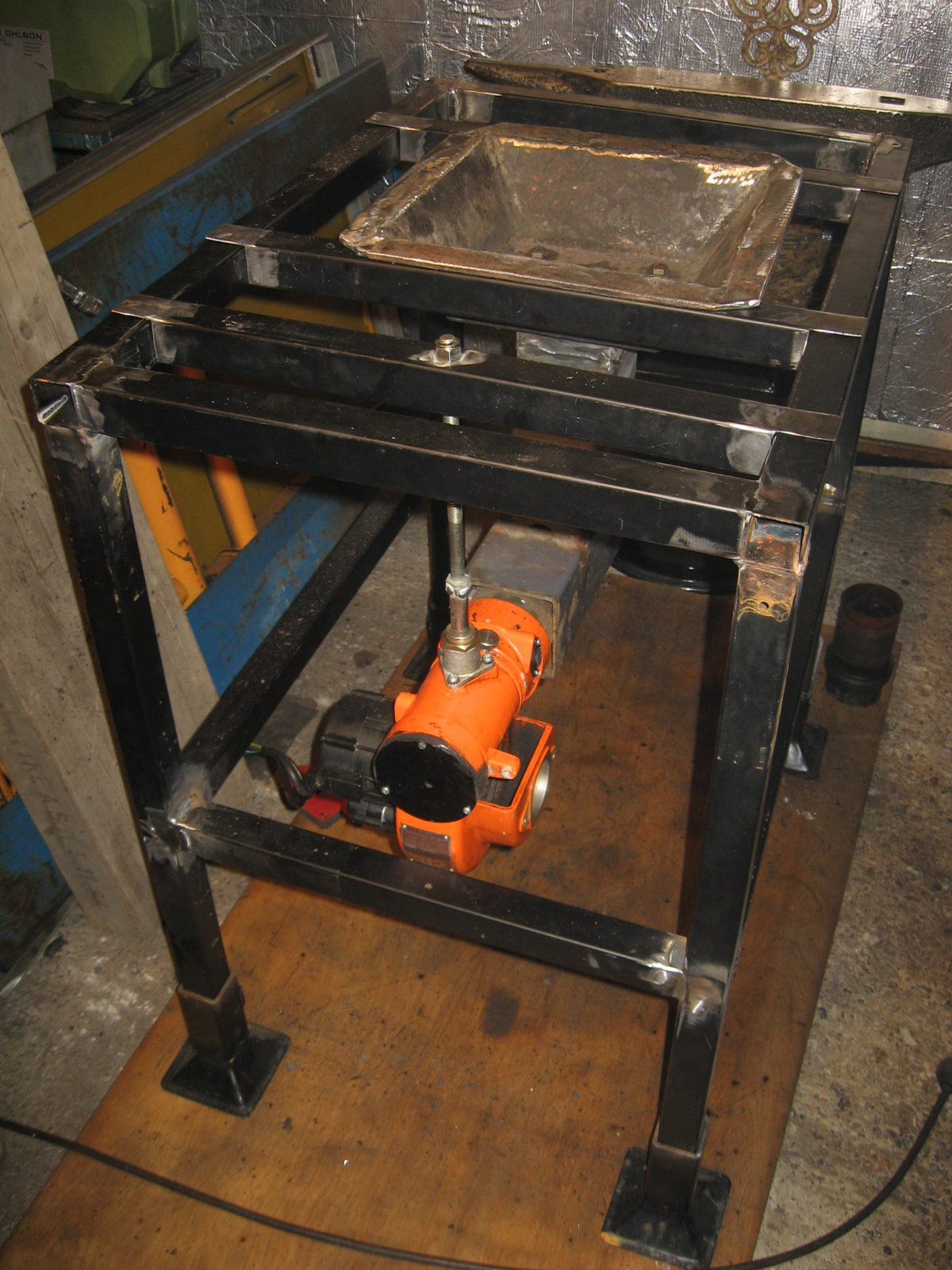

S Solo Member Messages 242 Location Norway Sep 23, 2017 #1 Forge project.... IMG_8282.JPG 341.6 KB · Views: 141 IMG_8283.JPG 521.1 KB · Views: 136 IMG_8284.JPG 502.7 KB · Views: 136

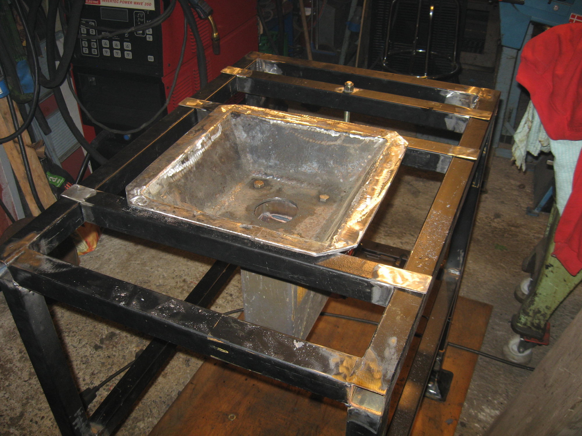

crazy Member Messages 103 Location Derbyshire Sep 23, 2017 #2 Looking good that m8 been thinking of making a forge myself, How big have you made your fire pit?
S Solo Member Messages 242 Location Norway Sep 23, 2017 #3 Upper 4X30cm, lower 4X20. 75mm hole. I've made 2 before so it works. Good luck! Post pictures!

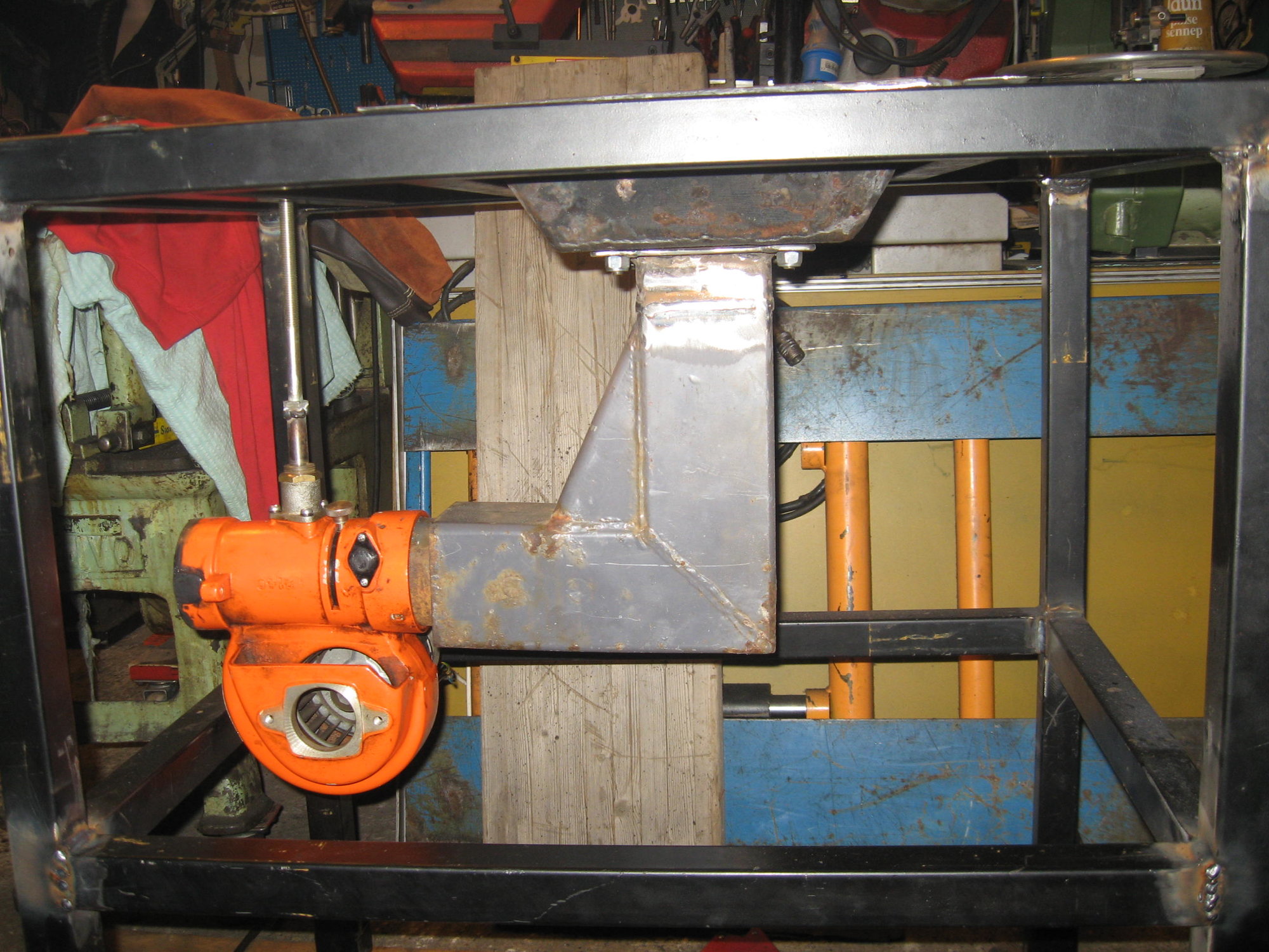

S Solo Member Messages 242 Location Norway Sep 23, 2017 #4 and the buoy is from a conteiener and the fan is from an oil burner
Thrashsmith Member Messages 789 Sep 30, 2017 #5 Looks sturdy! Do you have an ash dump on the underside of the right angle on your tuyere?
