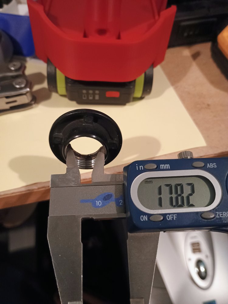

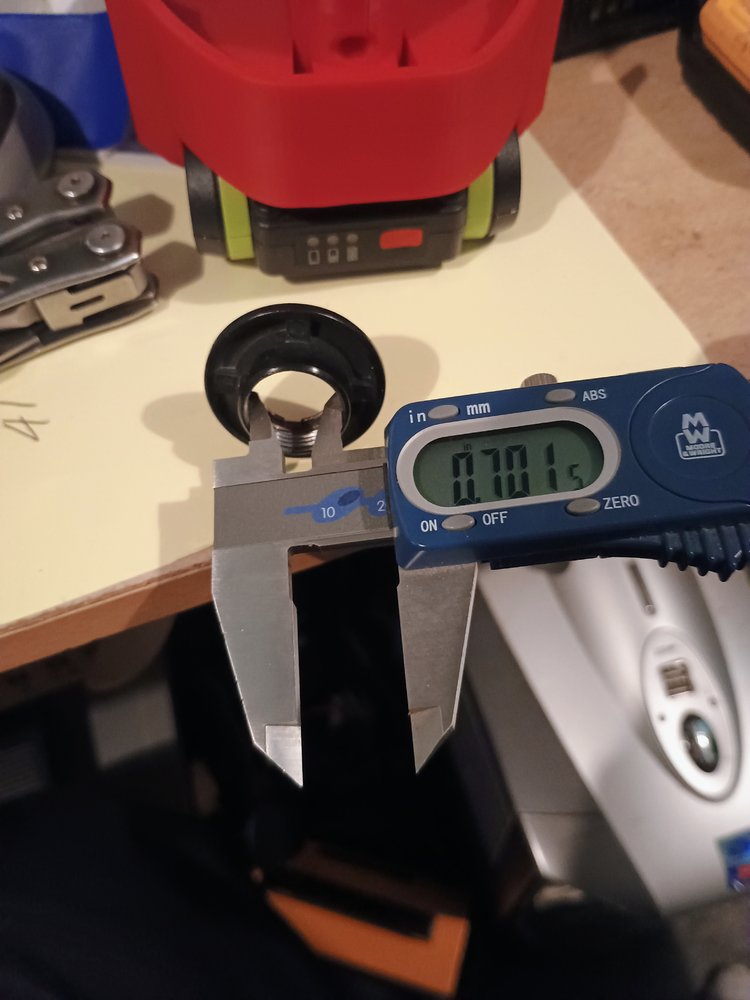

Trying to gauge this thread size:

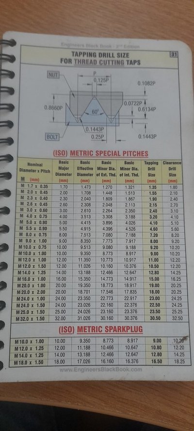

It's not M18 x 1 or 1.5. Core measurement below in metric & imperial.

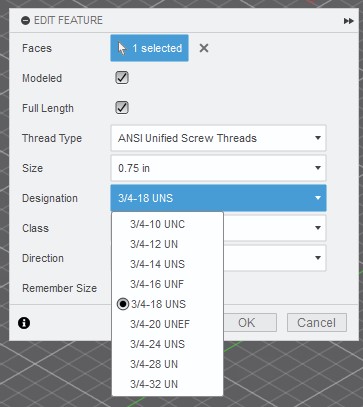

Consulting Mr Zeus then ¾-16 UNF is my best guess at the moment where the core is 0.6823". Currently printing a test thread. Somewhere around 20tpi maybe...
