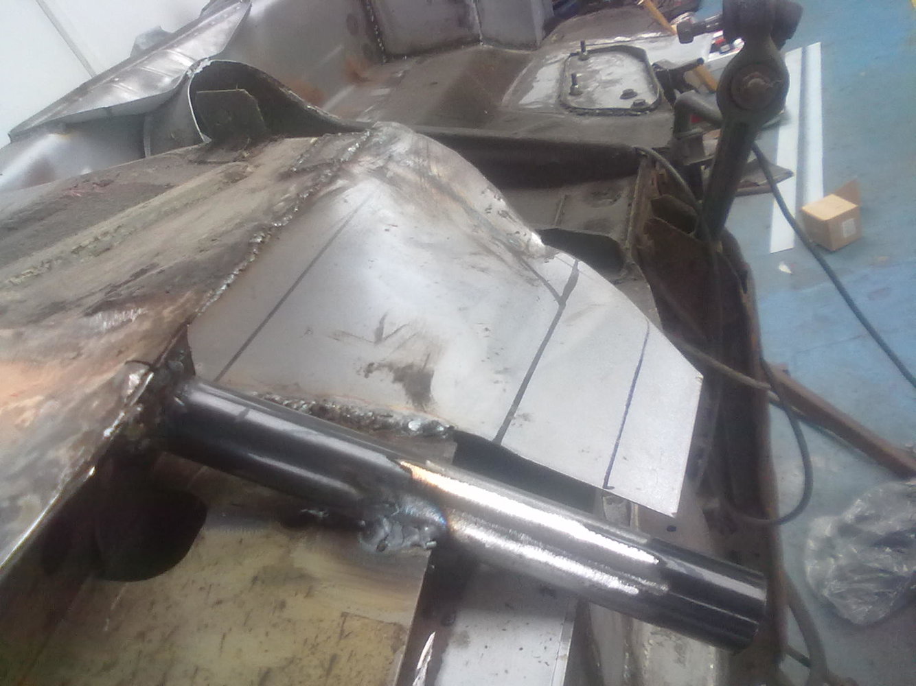

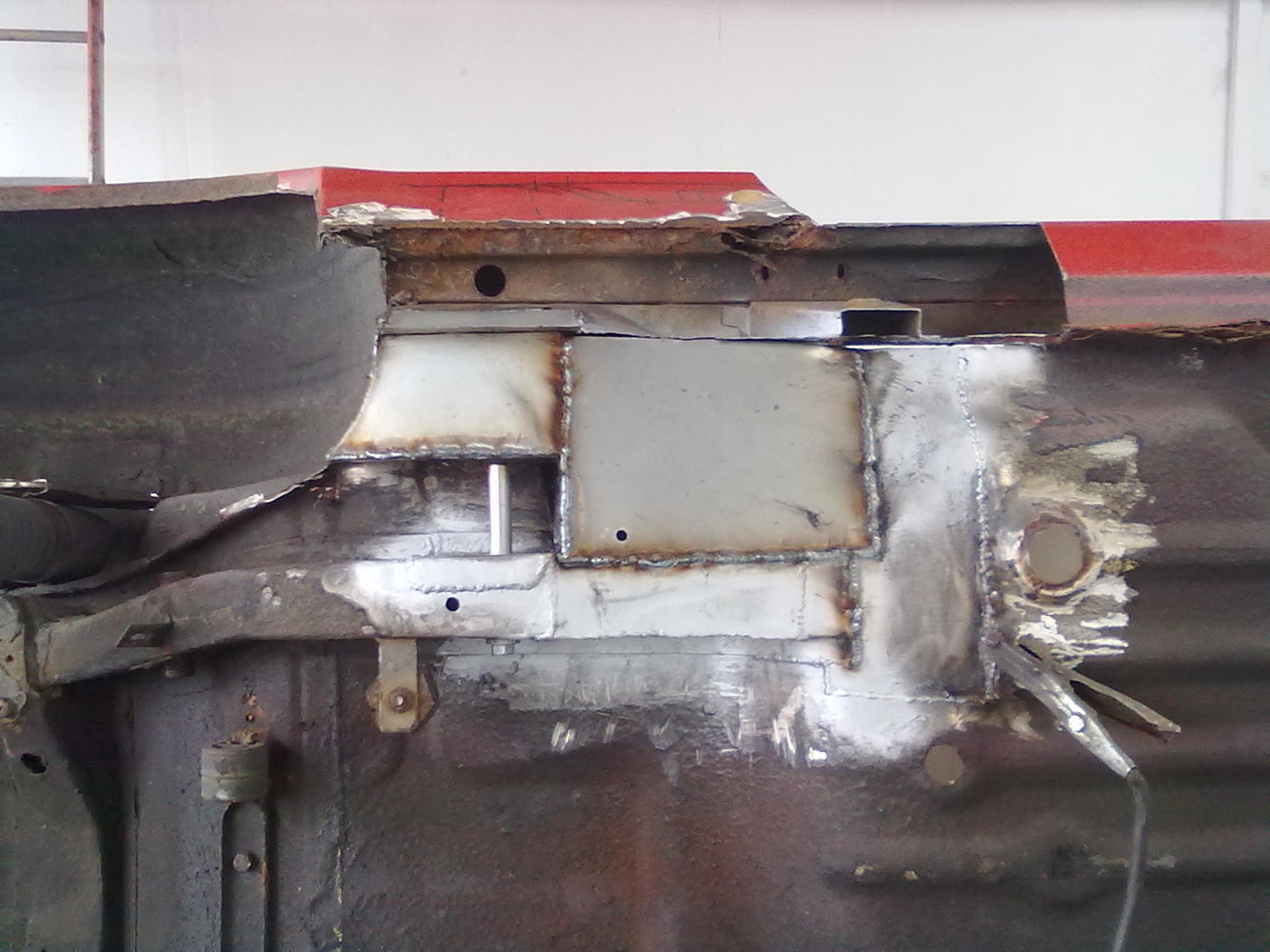

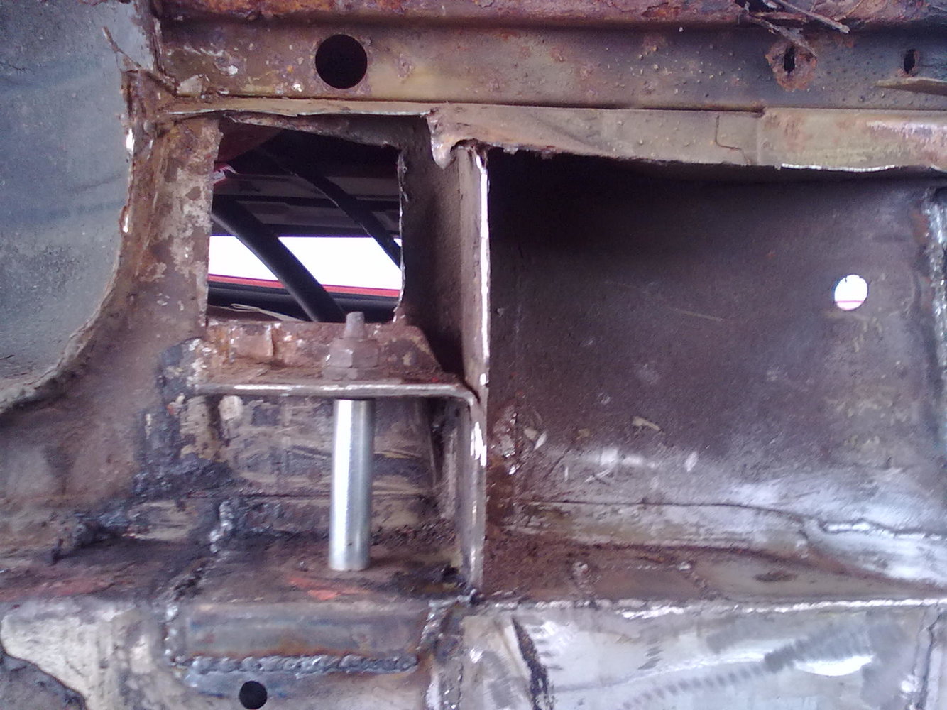

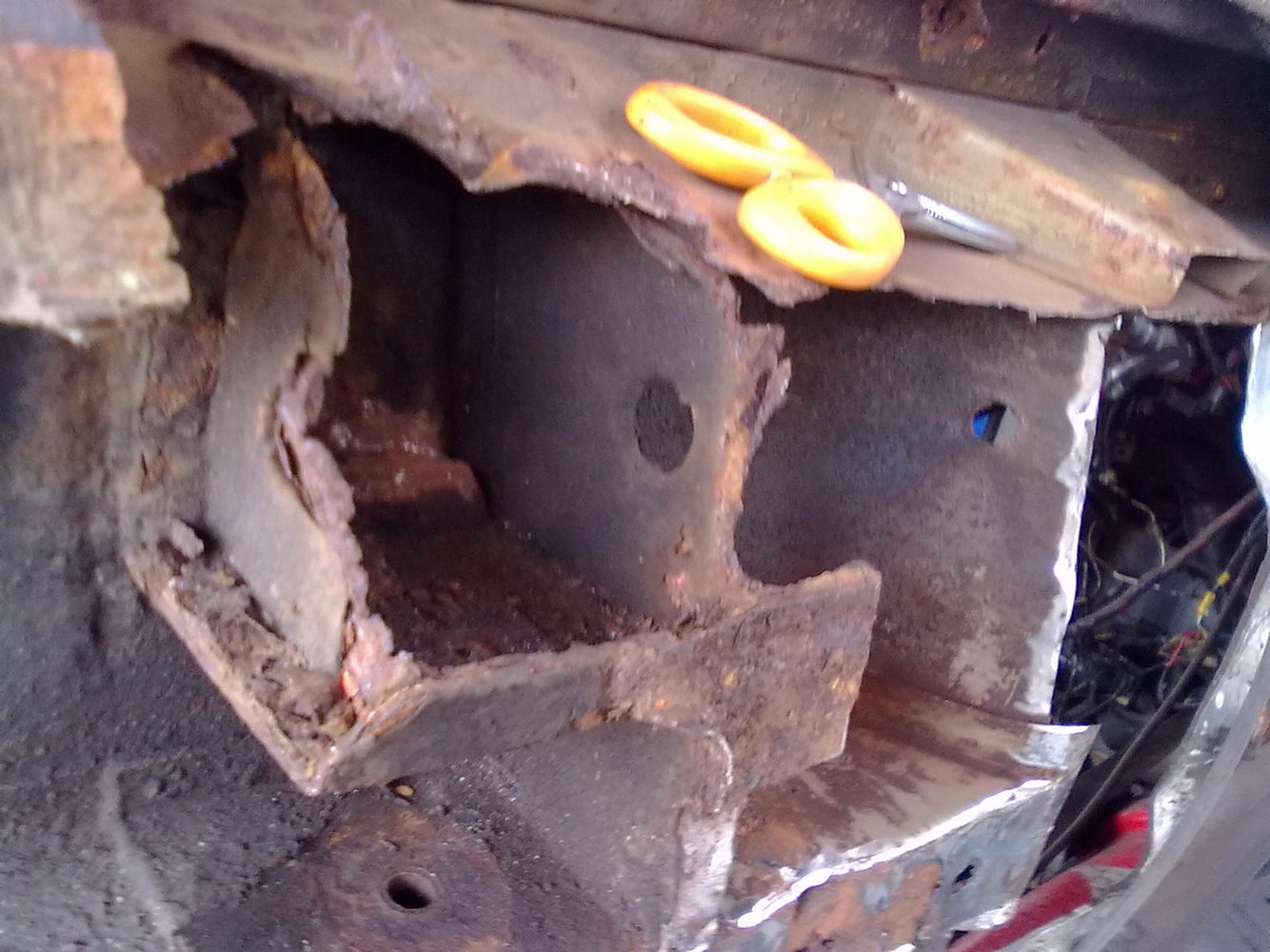

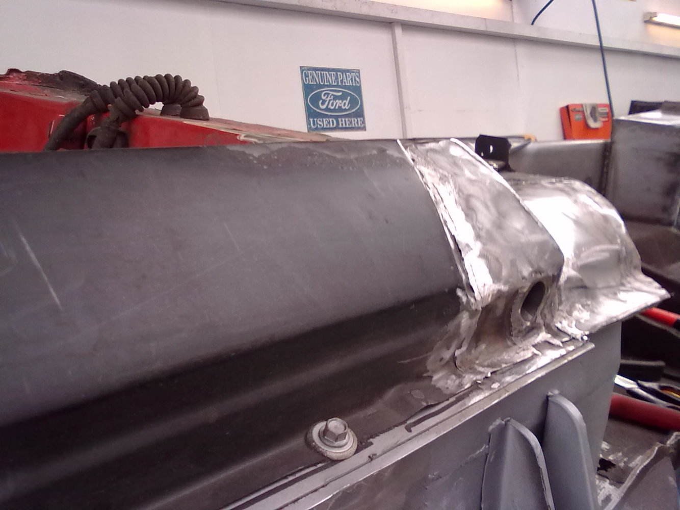

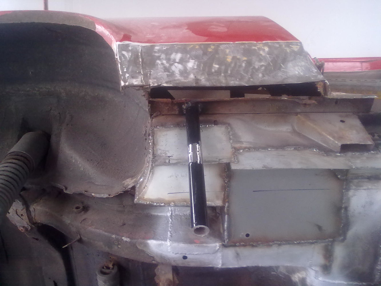

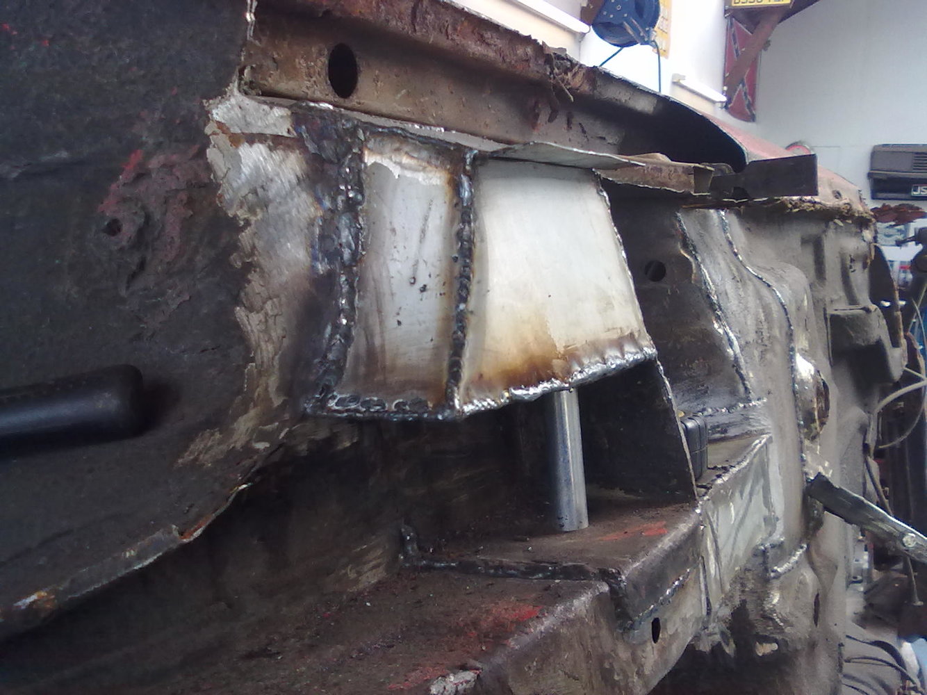

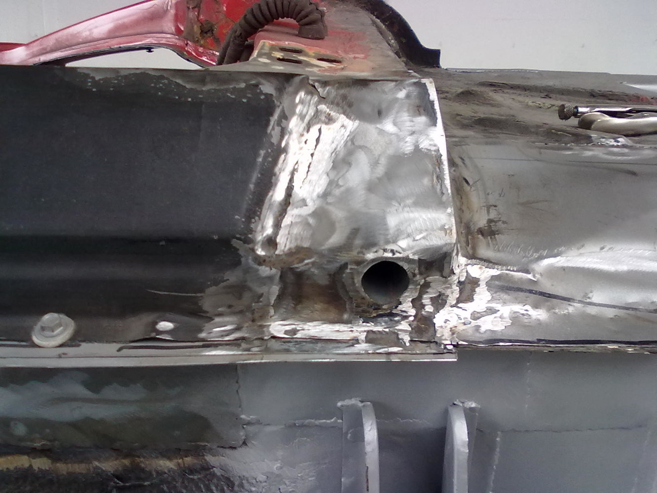

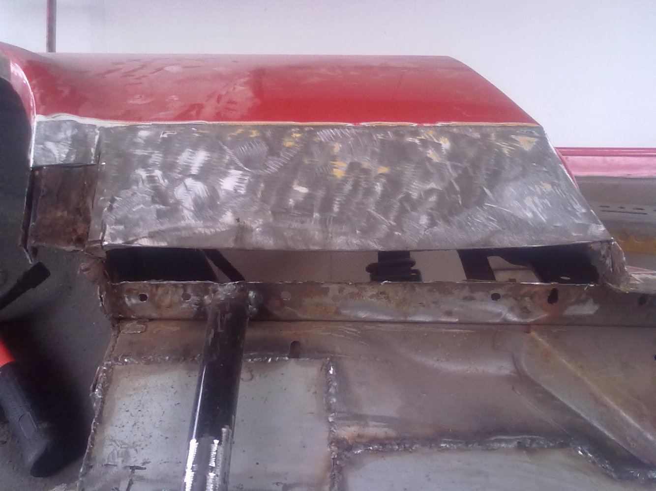

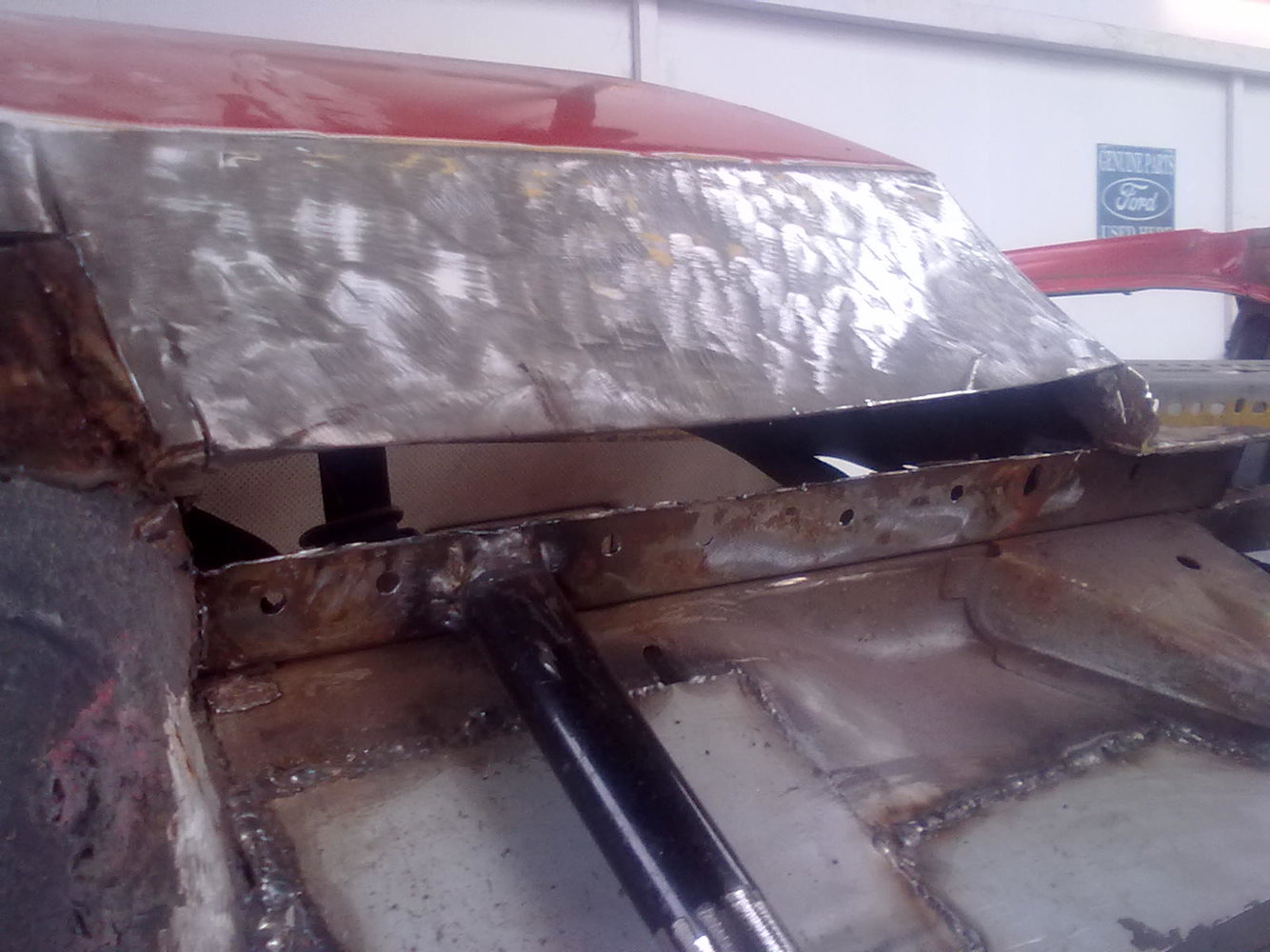

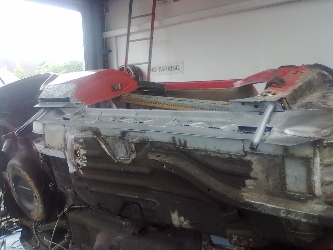

This primarily for @ajlelectronics with his Scorpio. Not mine but a mate's off of Capri Power.
He wrote:
"...found some steel gas pipe, inside diameter same as drain tube outer diameter.
they were welded in right thru the box of the sills so that all is sealed..
Our only difficulty was in the front, where they drop through the bottom of the A-pillar.
they go out thru where the outer wing wraps over... Our plan was to arrange a pair of hollow plastic stoppers,
that once the wings were in place would pug in to extend down and out avoiding that cavity ..
However, just this week, I have bought a complete solid non-sunroof roof, so the drains will be getting removed!
that'll teach me to take over 10 years to rebuild the sucker"
Pics to follow...pic heavy!
