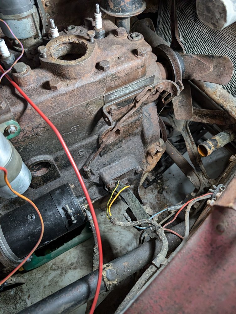

I called in to see Andreas, my friend who runs Cyprus Classic Motorcycle museum, he has an early Morgan 4/4 with a ford side valve 1170.
He asked my advice on repairing the lower water inlet pipe that has corroded away.
Corroded end is middle right of photo. I was thinking cut it off flush with the block then perhaps braze on? a short length of pipe that I can turn to suit. What do folk think? If it was me, I would take the engine out and machine out the bore for the water inlet pipe and machine a stepped pipe to replace the rusted one.
