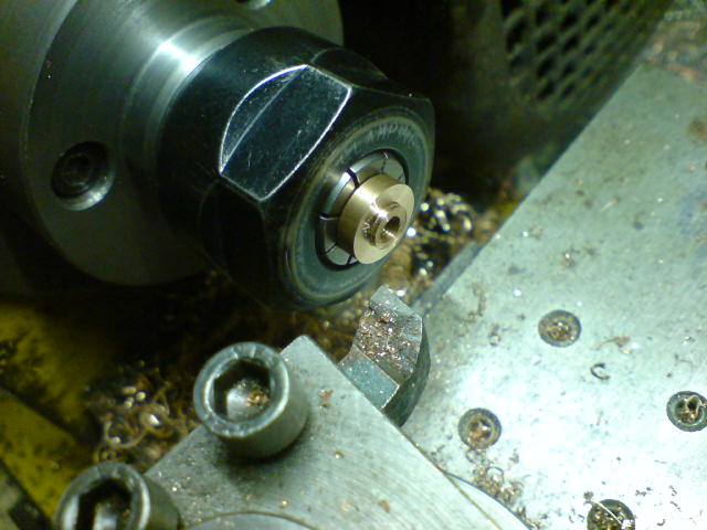

I love my vcmt16 tools - try it with a polished vcgt16 insert on aluminum or brass and it will cut the full edge length. I cant use much of the edge with my lathe on steel. There are still some 25/32/40mm shank holders/ boring bars for these on amazon btw.I've posted to my thread but thought I'd mention here too...

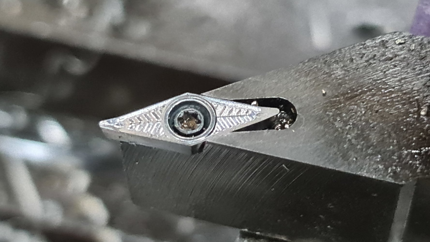

Yes lathe is pretty big - Colchester Triumph. The toolpost makes a Dickson S2 look tinyEither that is a short tool or your lathe is massive!
That looks like a non ferrous tip and will do amazing things on aluminium, brass and delrin.
It wont last long on steel for anything more than light tickles.
Ive ordered some YBC251's which should be here next week.
I need to play around more with the other tips and maybe try them in this holder to get a fair comparison.What depth of cut and feed are you at? The inserts I got still liked at least 0.5mm/20thou (that is, 1mm/40 thou off the diameter) and 5 thou per rev. You could do less, but the finish suffered. Also, what's your centre height like with those shims? Is it close, or is it actually correct?
