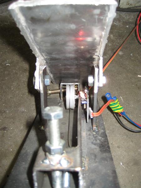

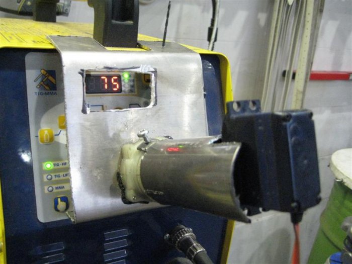

Just wanted to show you who dont have possible of foot pedal with machine.
Heres Tuningy servo tester attached to foot pedal and servo fixed to planetary gear from old drilling machine.Guite "high tech"
I may do this little neater now that Ive seen it work
