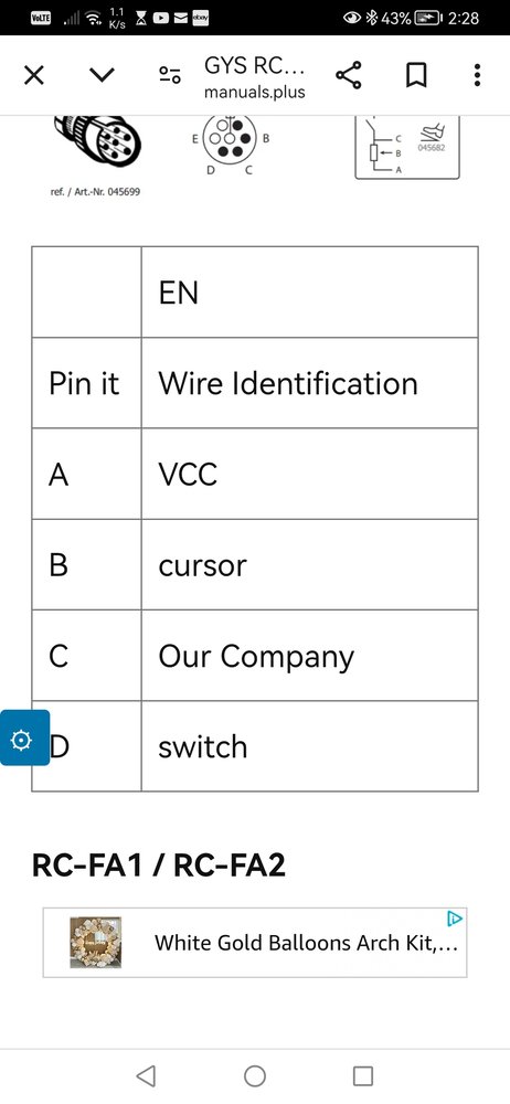

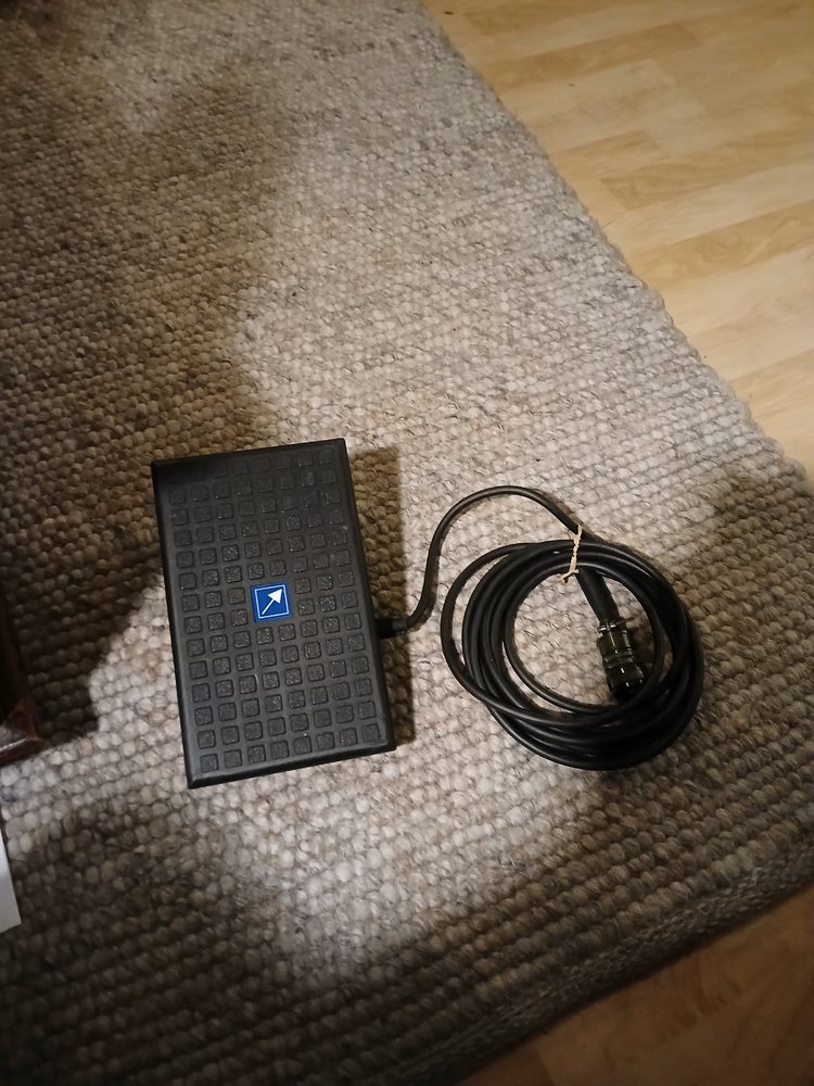

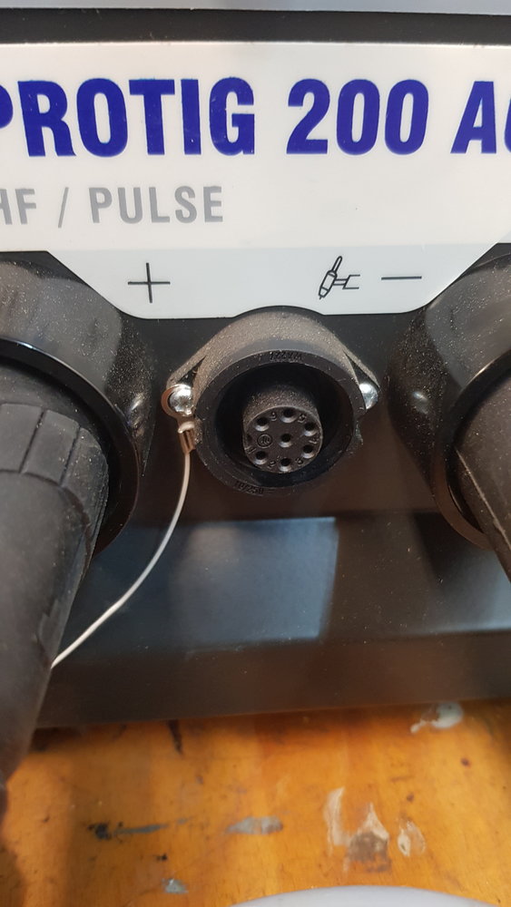

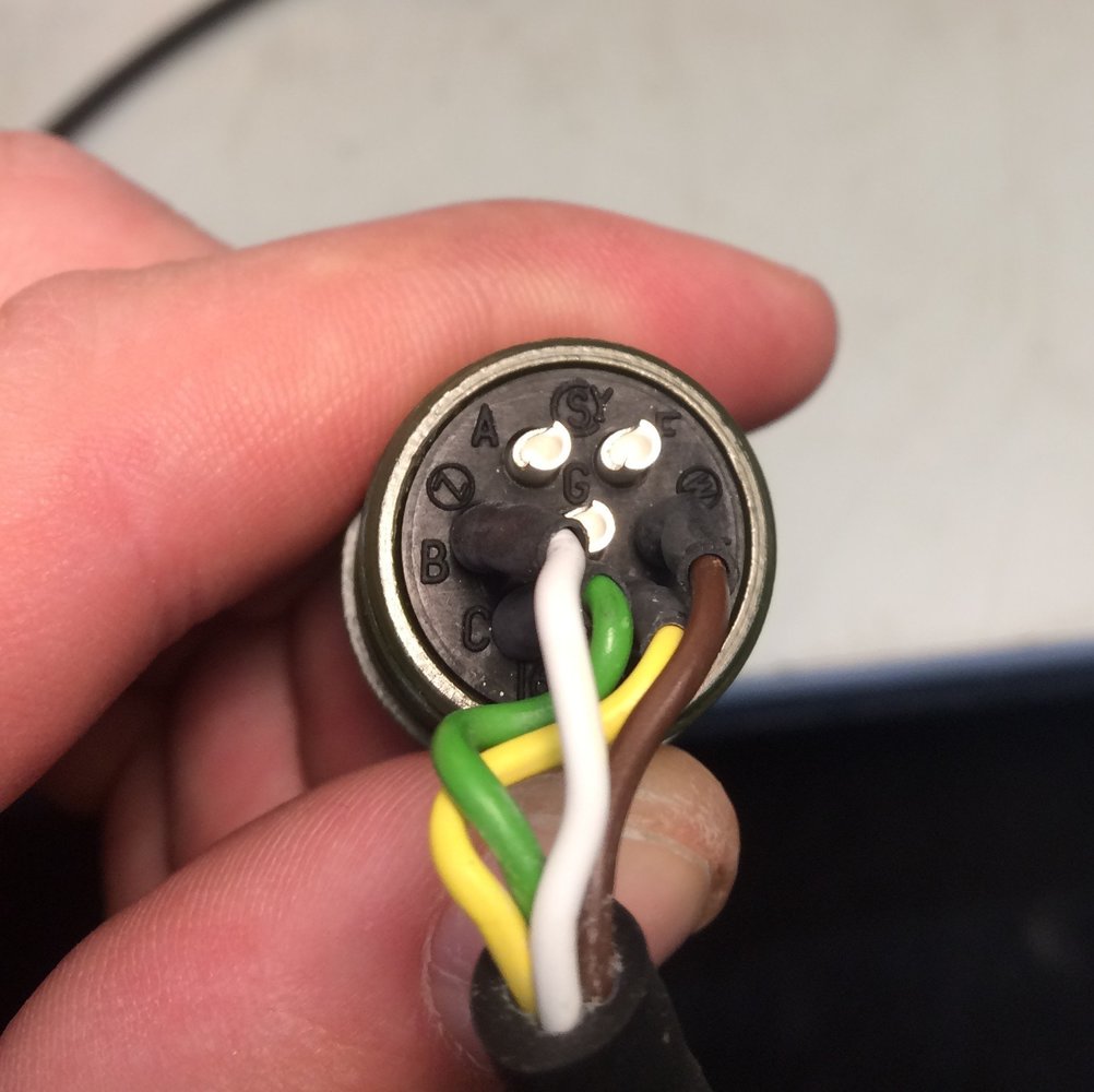

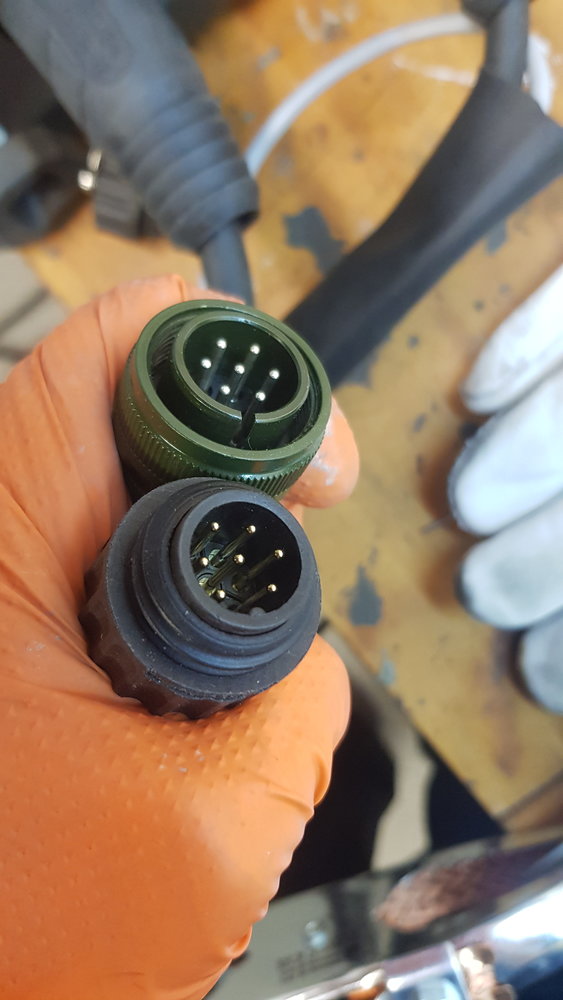

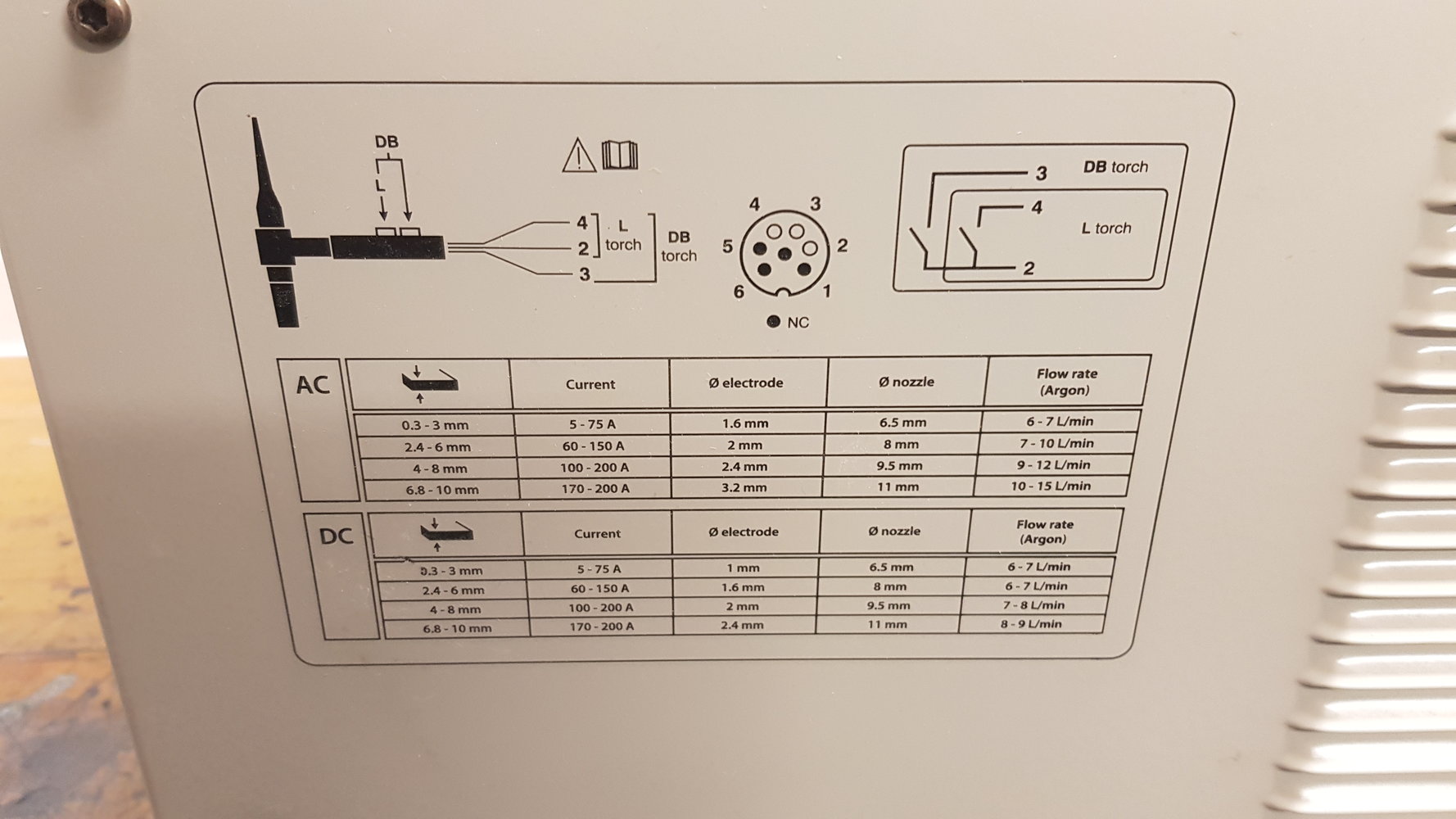

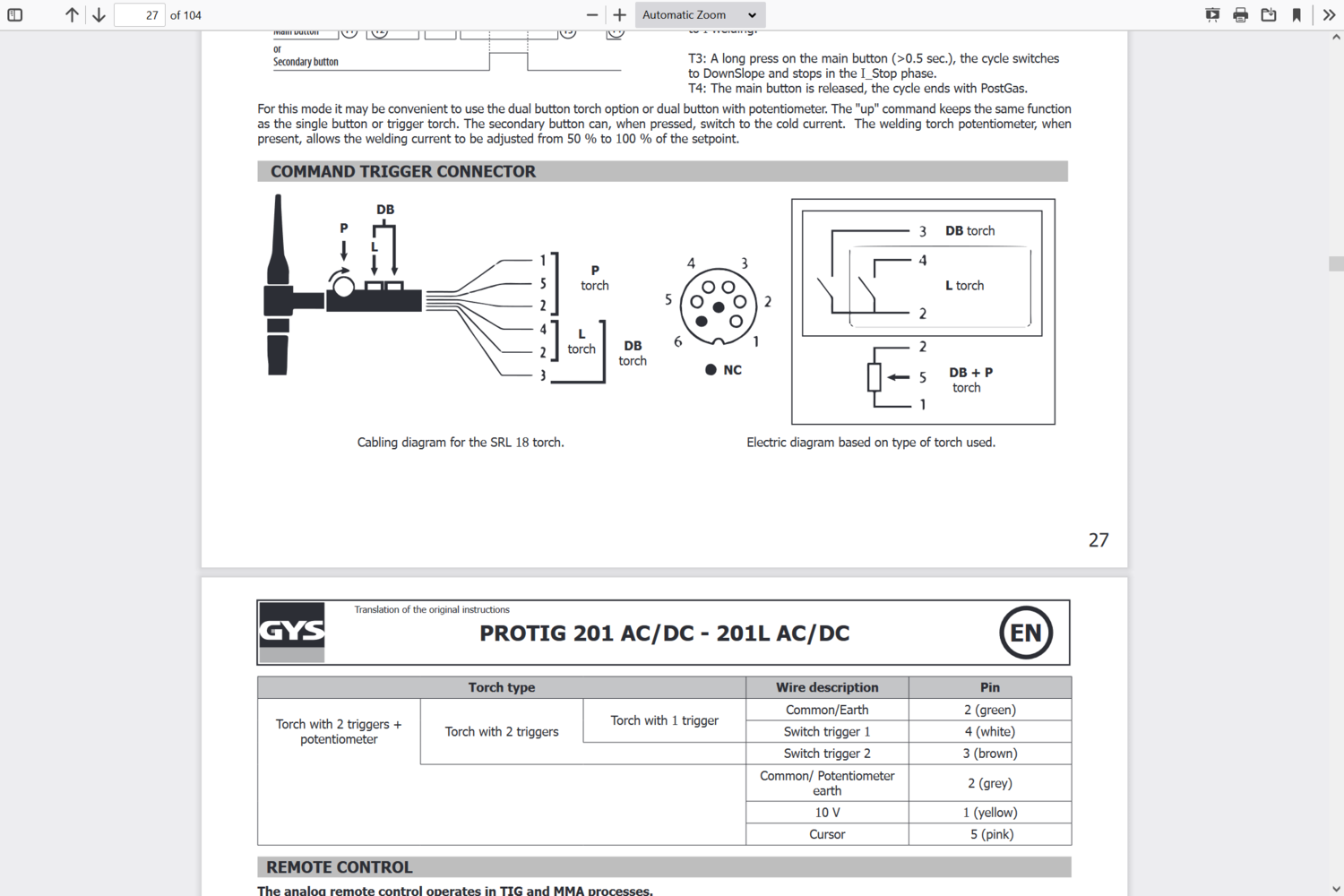

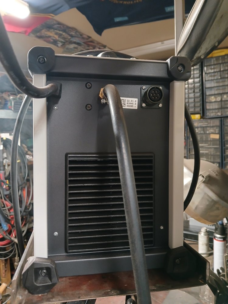

I've recently acquired a GYS Protig machine, and I purchased the GYS foot pedal. Is anyone able to help shed some light on wiring it up.
I assumed the din plug would go straight in, however they are very slightly different.

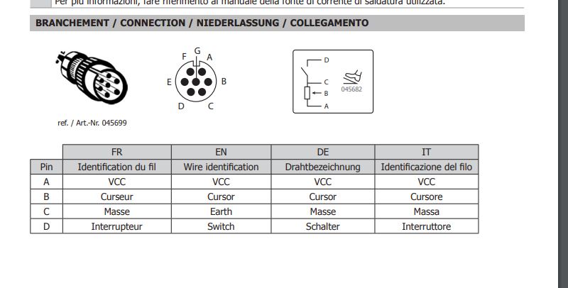

I'm a bit concerned my machine cannot accommodate a foot pedal. I've attached photos of the two plugs (green one is the pedal, black is on my torch) as well as the wiring diagram from the pedal and the welder. Let me know if you have any thoughts on this.
