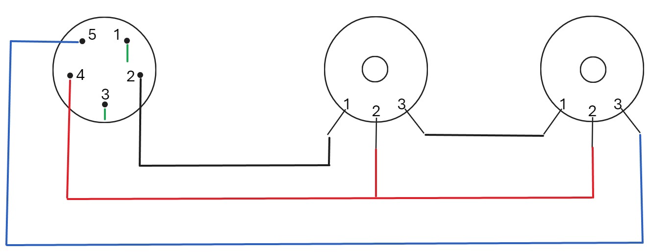

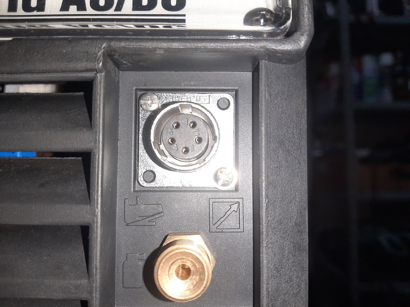

Gentleman, I have this brazilian brand name Bambozzi WMI 208 TIG AC/DC welding machine with a 5 pin connector for TIG HF start. I bought a very common foot controller (since this brand does not have one) but, of course, I have to adapt it. I've watched all Youtube videos of DIY foot pedals, I've seen hundreds of schematic images on google search and I've tried myself to make this pedal to work with my machine but with no success, so I need help.
My pedal controller has two linear rotary potentiometers: one external and one internal. Both B103 (10KOhms). It has two plugs: one for the switch with two pins and another for the amperage control with 3 pins.
Since my machine has a 5 pin aviation plug, I have to figure it out what pin does what and I did (kind).
From the inside, there's two green wires (pins 1 and 3) for the switch, one black wire (pin 2), one red wire (pin 4) and one blue wire (pin 5).
Using a multimeter on continuity mode, none of the pins are connected to the machine ground (the chassis).
On DC voltage mode, my multimeter shows:
14.7 volts on pins 5 (blue) and 4 (red)
14.7 volts on pins 4 (red) and 2 (black)
0 volts on pins 5 (blue) and 2 (black)
So:
4-5 = 14.7V
4-2 = 14.7V
2-5 = 0V

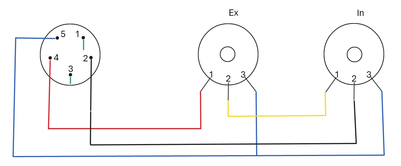

I tried to connect one potentiometer (10kOhms) like this:
Machine Pot
Pin: 2(black) ------ 1
Pin: 4(red) --------- 2 (whiper)
Pin: 5(blue) -------- 3
Though it changes those 14,7 voltages (checking with multimeter) and lights up the foot controller on the panel, it doesn't change the numbers on amperage display.
I tried changing the wires, tried wiring two potentiometers as a voltage divider, even tried with 2.2K and 1K potentiometers, but nothing worked. Run out of ideas here and reaching my machine's company customers service, they didn't want to help me aswell.
