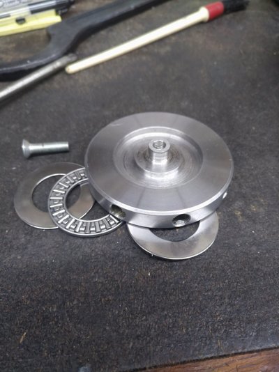

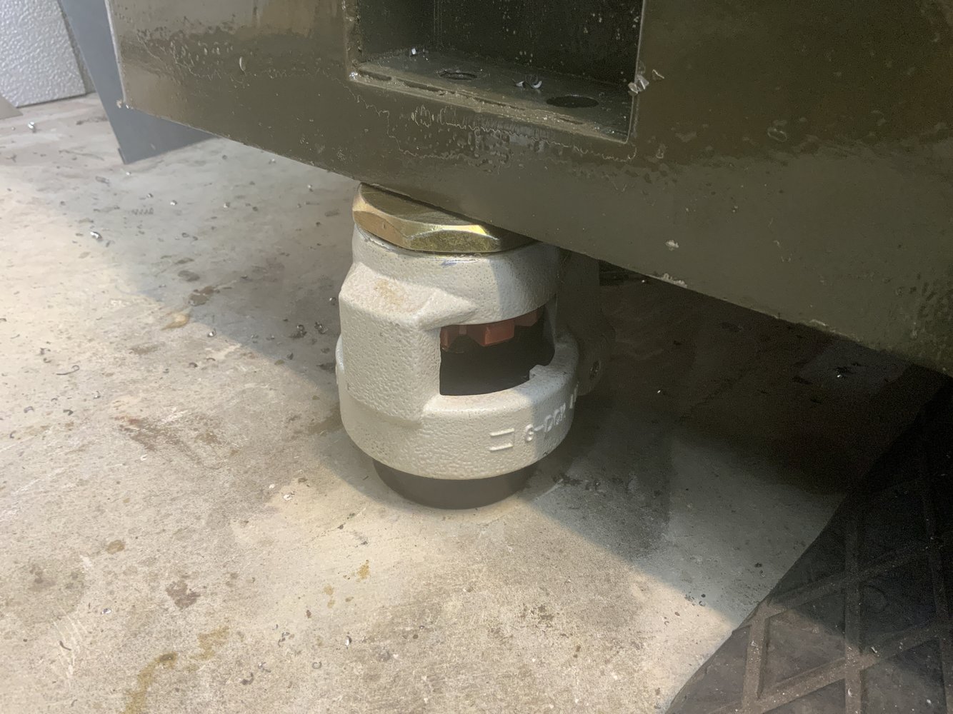

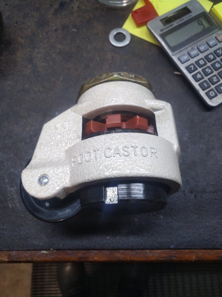

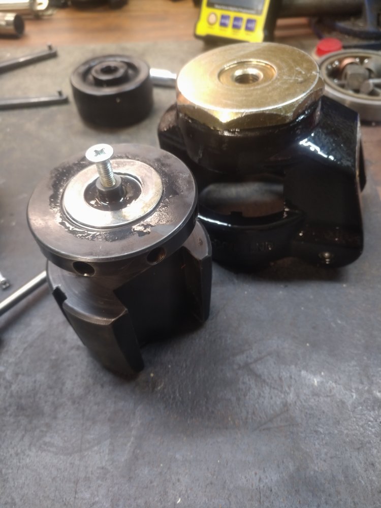

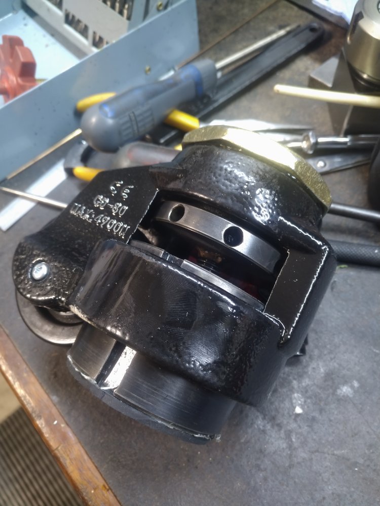

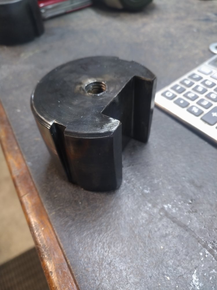

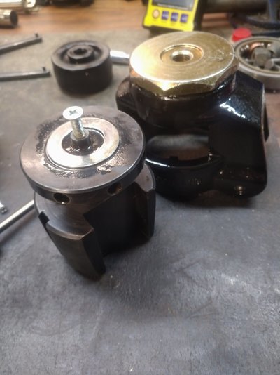

Bought 4 of these a while back to level the M300. did as they should, happy days...

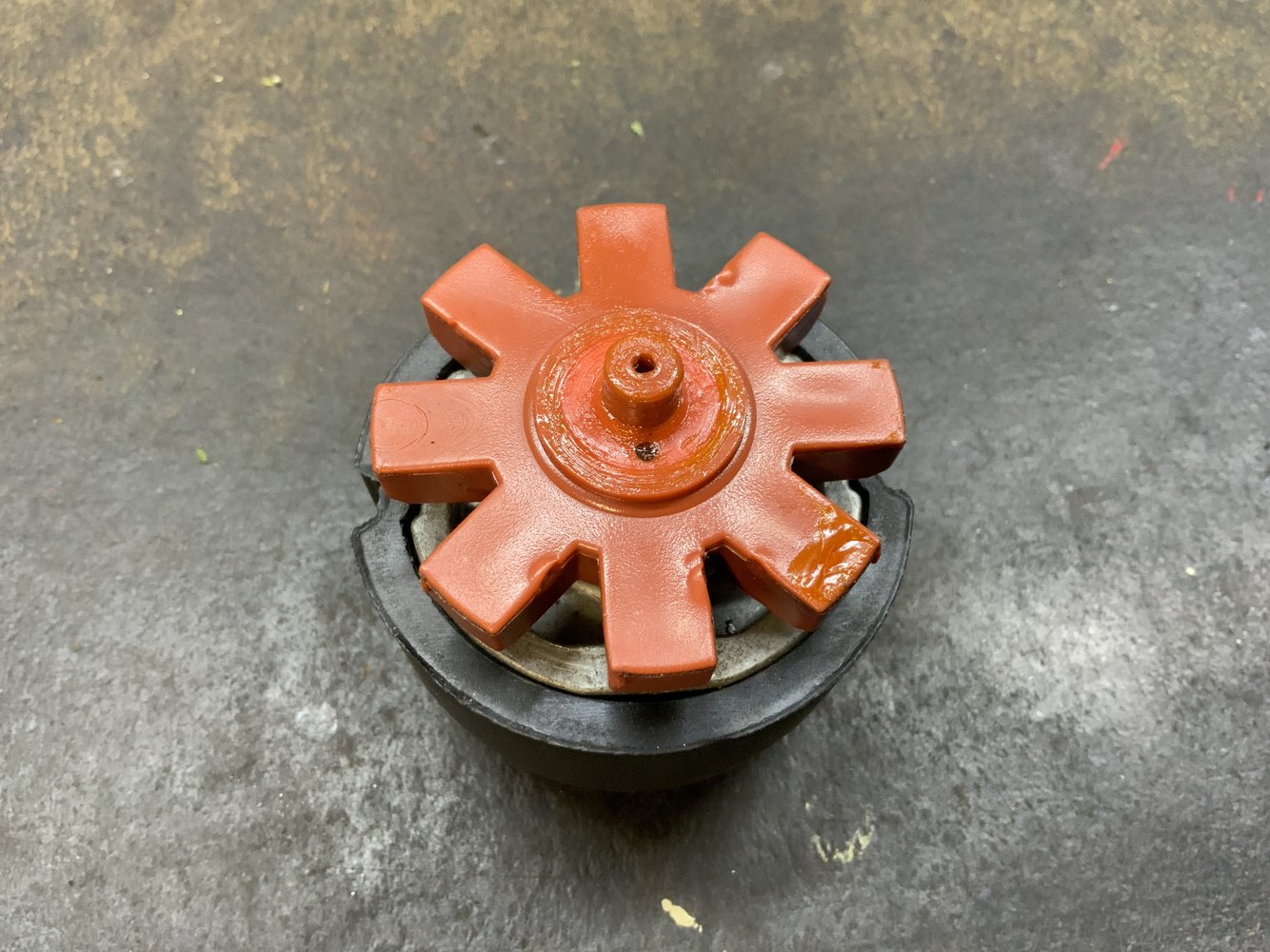

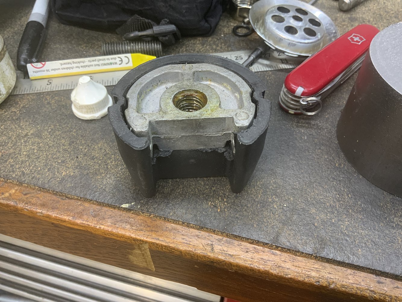

However last week I decided to check the bed on the lathe as something was amiss with machining. Annnnnd the problem is the castors. The feet are rubber, the weight of the machine has compressed the feet knocking it out of level. Grumble.
They olny just lift the wheels off the ground as well.
So I machined or have started to machine 4 replacement feet from bar. First one done and a lick of Blue to abate the rust.
