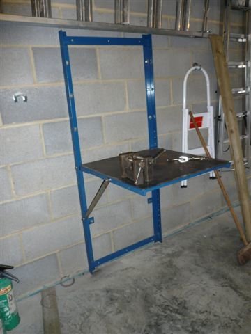

Short of space, I built this fold down welding table. I can raise or lower the table depending if I am tig or mig welding. This is my first weld project all quite thick angle iron, but it works great. I am planning on adding a shelf for all the clamps and a spot lamp next.
Regards Chris
