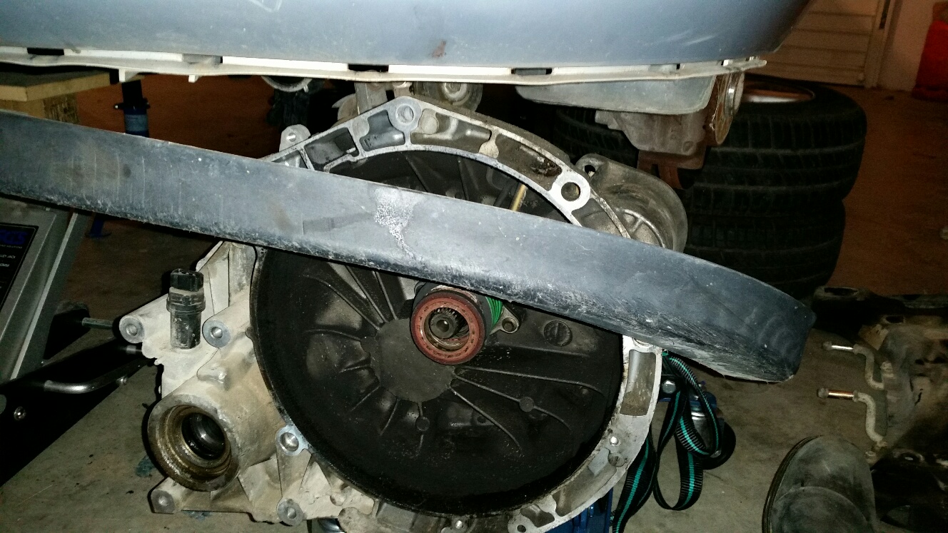

He says they engage fine when the engine isn't running so if the gears are crunching then it's unlikely to be the linkage.Before you rip the box out, swear like a trooper, check the linkage.
They used to fit a PTFE bushes in the joints, they break up and fall out. They were £0:32p + VAT from Mr Ford.
He says they engage fine when the engine isn't running so if the gears are crunching then it's unlikely to be the linkage.![]()
