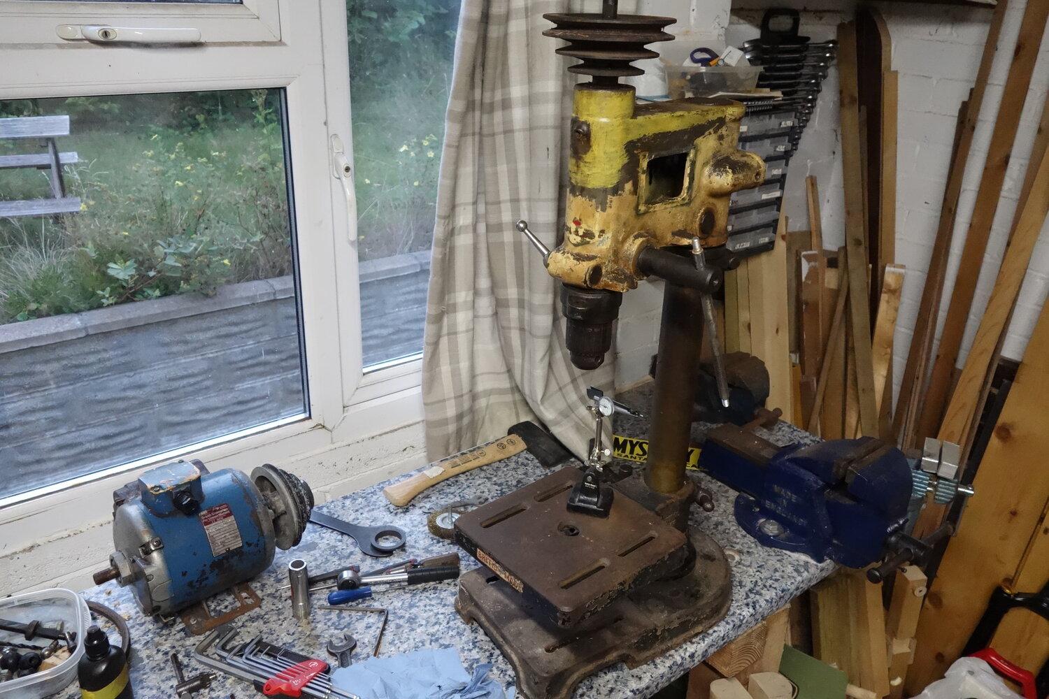

I recently bought this from gumtree. I'd like to restore it as good as I can, but wanted to check it's a viable project before I start any serious work. It has clearly had a long and interesting life! I have all of the parts apart from the belt cover - they're just scattered over my bench. I also bought it for a good enough price that I don't mind spending some money if needed.
As best as I can measure, it has 2 thou radial runout (measured at full extension, and measures the same both on the chuck and on a drill bit mounted in the chuck). There is no lateral movement in the quill as it is extended and retracted, however there's about 10 thou of play if I unlock the quill at full extension and give the chuck a good wiggle.
I've mostly used hand tools for my projects till this point, so would really appreciate any advice!
