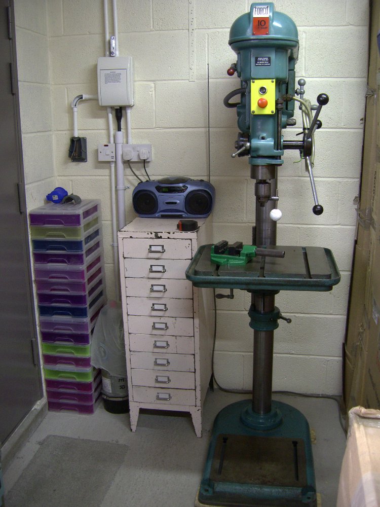

Back in Sept 2023 i bought a few bits and pieces from a steelwork fab shop which was selling everything off. The main thing i bought was this Fobco 10 eight drill. After winning the auction me and a mate drove up to Annan to collect it. Luckily there was a crane in the building we could use which made things easy so i just drove my pickup into the shop and we lowered it into my Hilux bed and off we went.

Thats how it was basically from when i bought it as i never got chance to do anything with it. Still swarf in the table and oil and grease all over it, probably a good thing with it sitting a while.
The past few nights ive made a start cleaning it up a bit and finally getting a chance to give it a look over. As it was from an auction i dont know if it even works at this point.

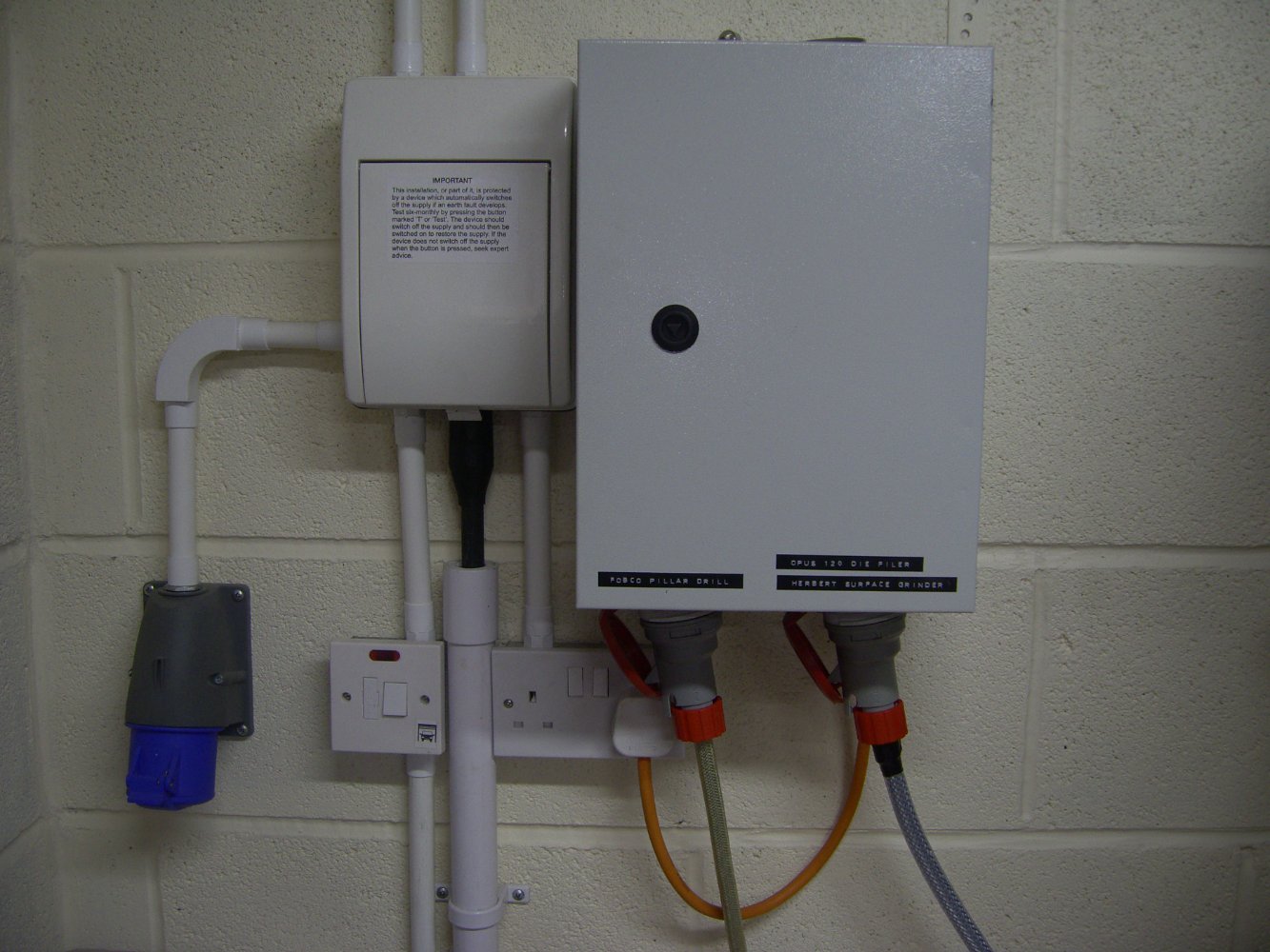

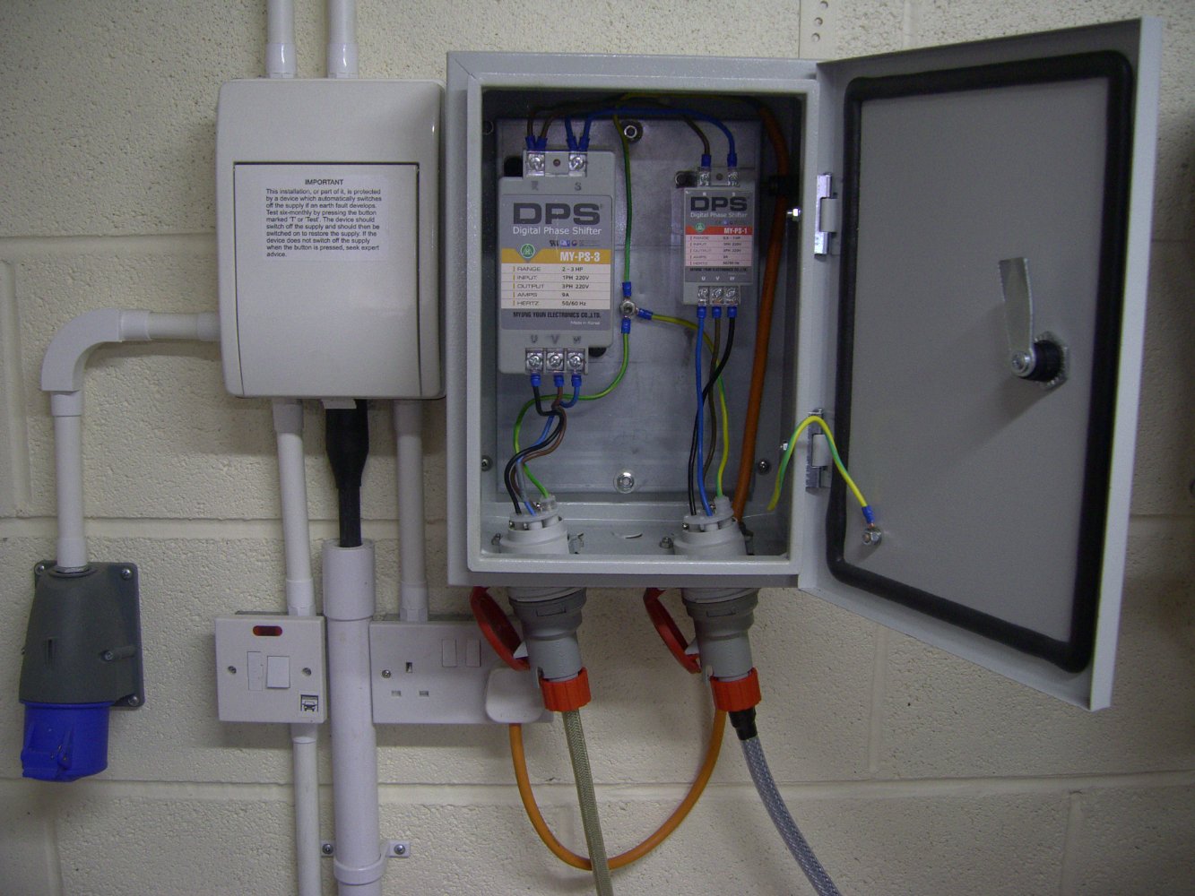

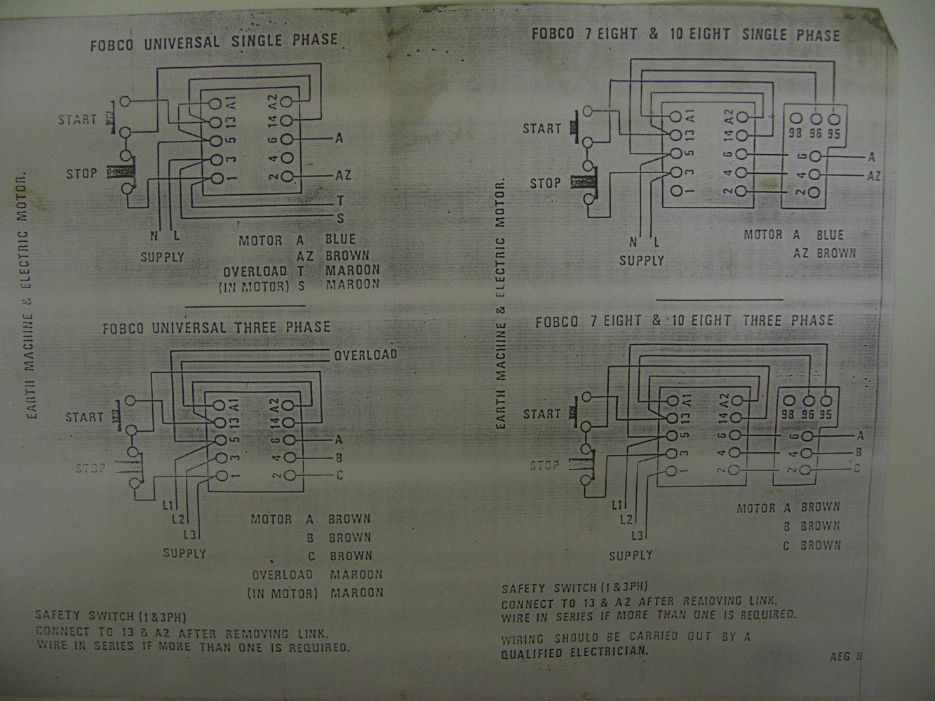

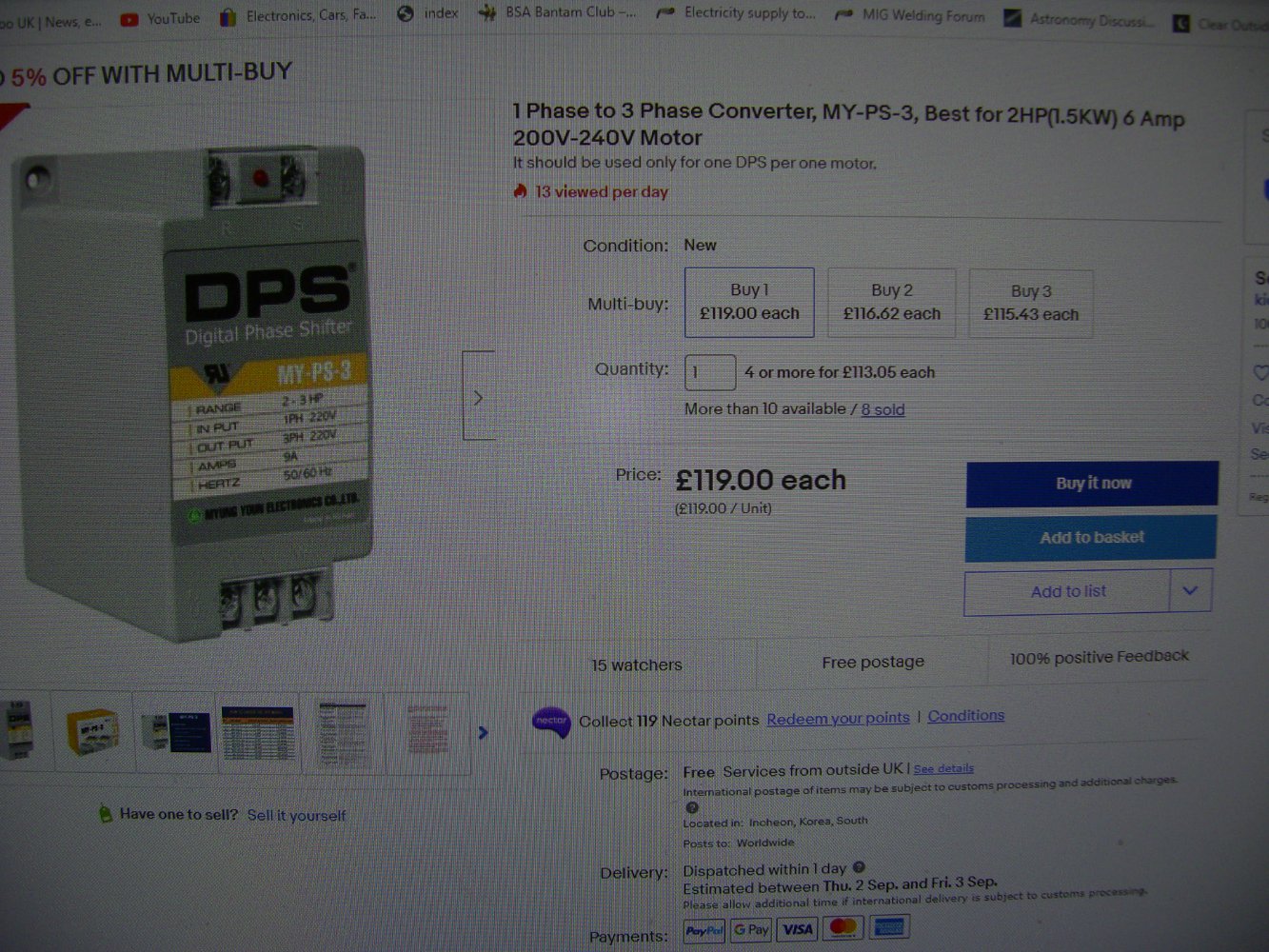

The plan isnt to restore the drill i just want it so i can use it. I dont have 3 phase electric, i did get a quote to get it ran to my bungalow with me digging the trench and they wanted £30k! So instead i got my main fuse uprated to 100 amps as it only had a 60 amp fitted.
So my plan was to fit a VFD, i found this one which i thought might do the job but what do you guys think?

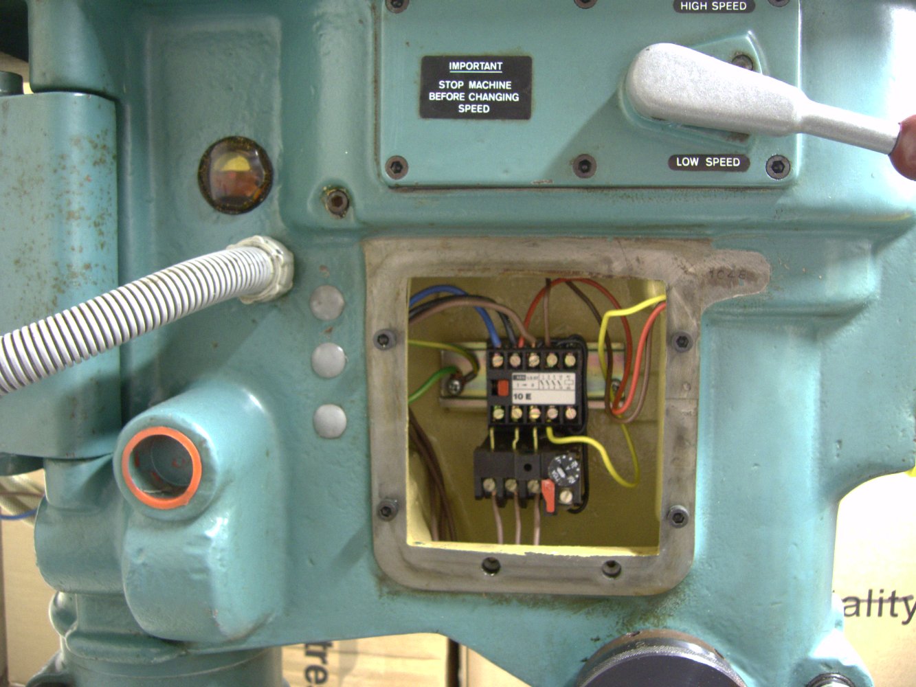

This is where im at now.
Cleaned it up a bit. I removed the gear selector plate to clean the gearbox out and check it over. Everything looks good in there but it didnt have much oil left in it. I have cleaned and sealed the selector plate with RTV as it had been leaking. I have got a container of ISO 68 to refill it when the RTV has gone off.
20260219_192247 by Bean Beano, on Flickr
I also need to get hold of a chuck key for it. I think it has a Jacobs No36 on it if i remember right.
I still have work to do finishing off my garage and getting a proper electric supply ran to it. But i can do bits on the drill in my spare time.
Any pointers or advice would be much appreciated
