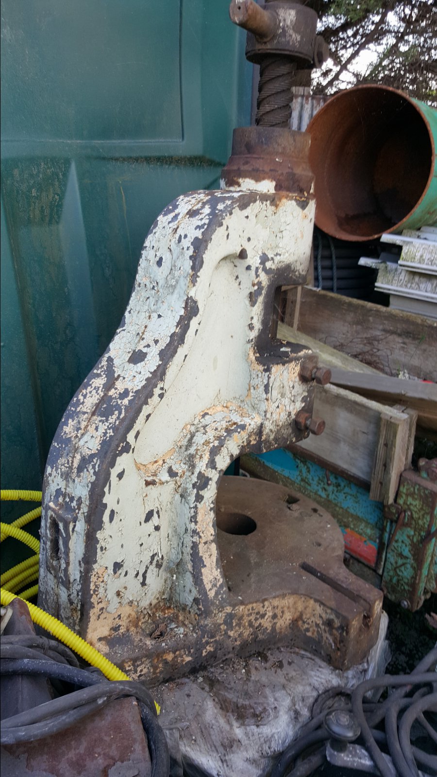

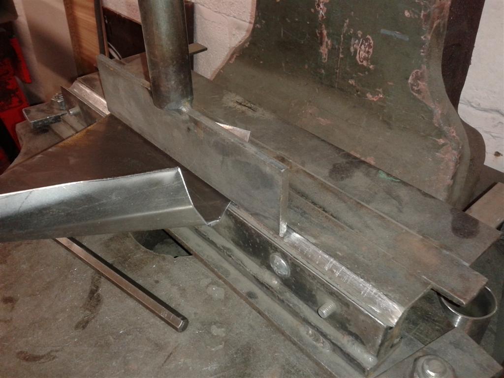

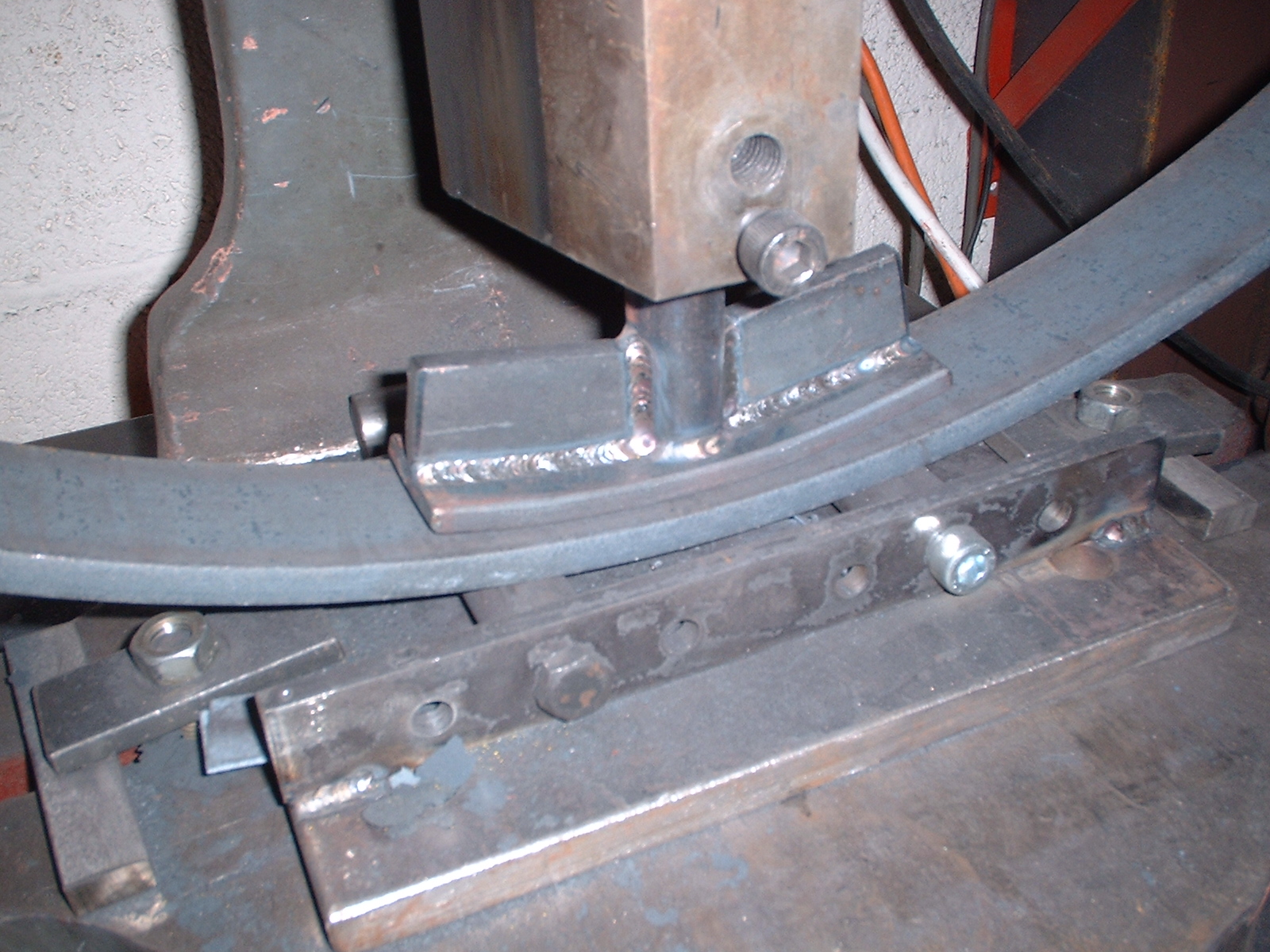

Right..I see..I have finally got my self a big fly press..been after one for ages...so will be getting ideas for tooling ect. Hopefully picking it up Monday...I have a holder which takes a selection of V section forms, gang them up for the length you want. Standard V channel underneath. Got a picture of it here but this isn't how I typically use it
For me absolutely the best feature is punching holes in sheet. Super clean, super easy.
I should do a thing on it I suppose, I have a mountain of Flypress tooling, including some very unusual bits and bobs. If you look carefully at the first pic, you can see where I was playing with a dome tool.
I will do yes...I am picking it up next week...she a big lump.I am sorting out a ball weight for Tiggy, you need balls?
