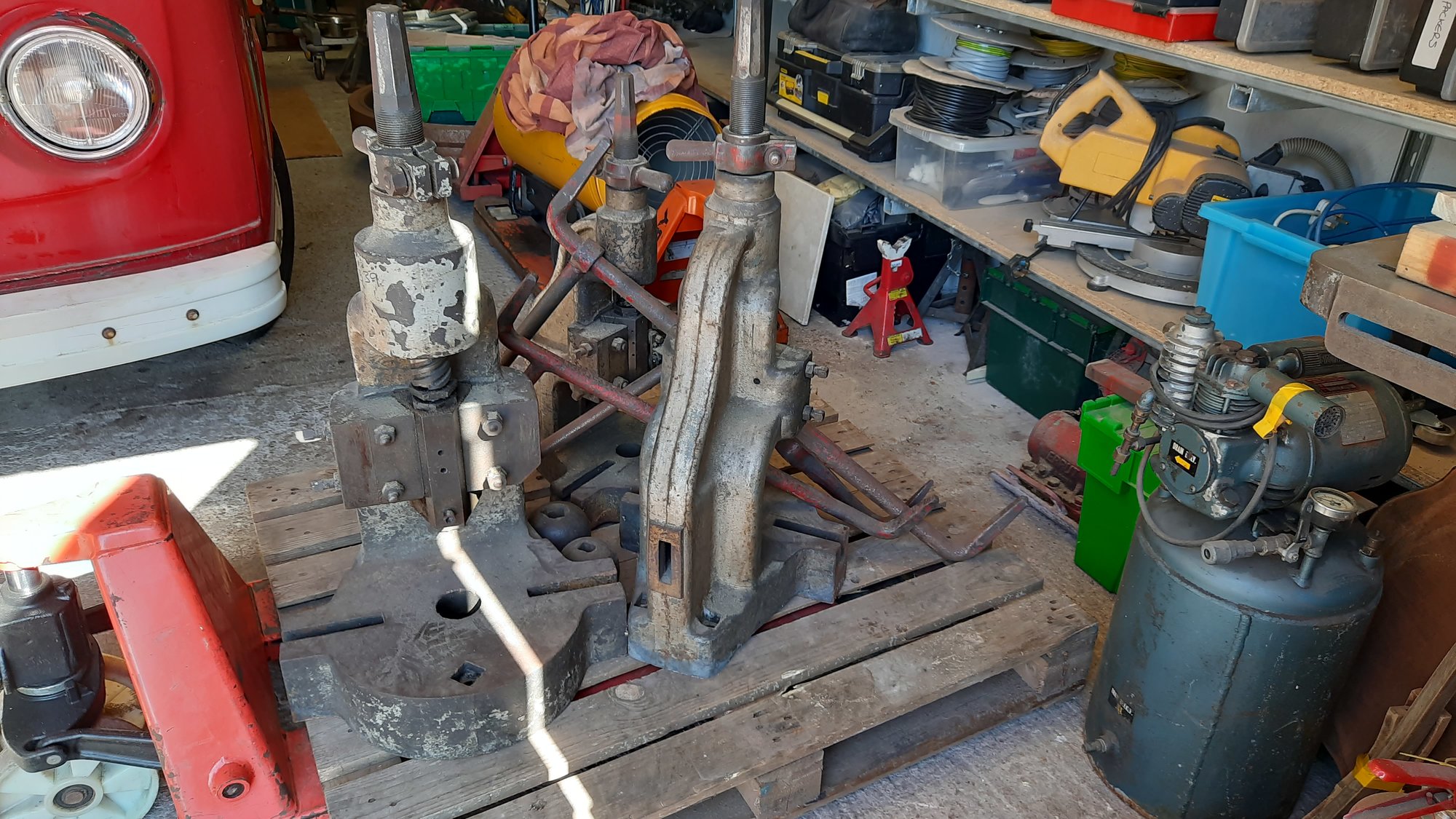

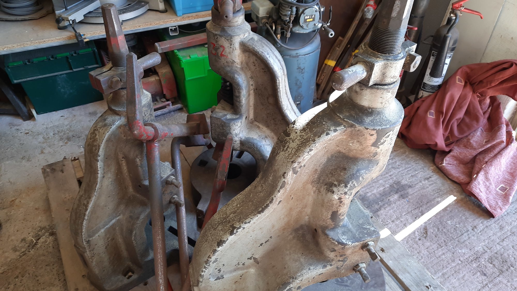

How do you determine the size of a fly press i have 3 with no numbers on, They just have the makers name which is Sweeney and Brocksidge.
Sometimes size can be determined by the diameter of the main screwHow do you determine the size of a fly press i have 3 with no numbers on, They just have the makers name which is Sweeney and Brocksidge.
Will post pictures soonMy seat of the pants guess would be 4-6 ton rating. The white one looks like a deep back, bit like my Norton 6DB. Shown here for reference.
