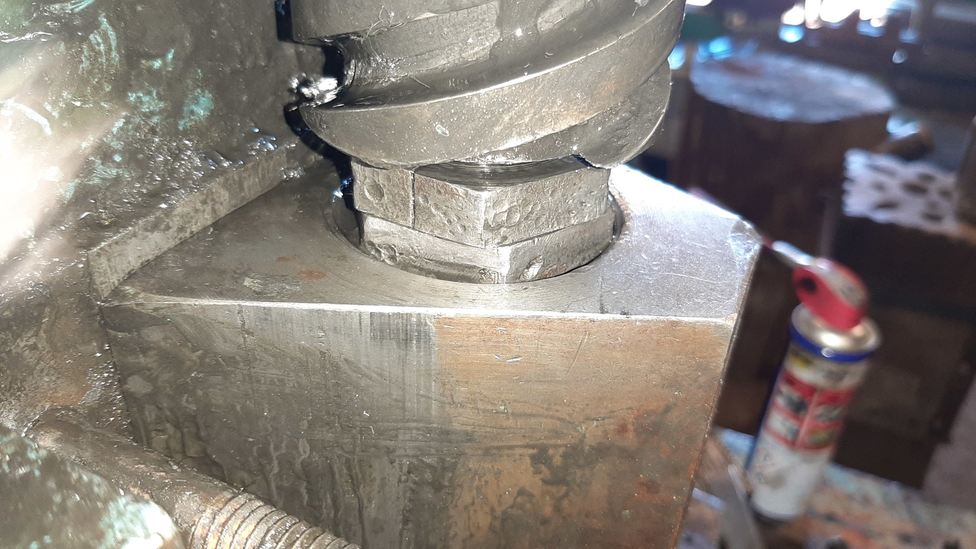

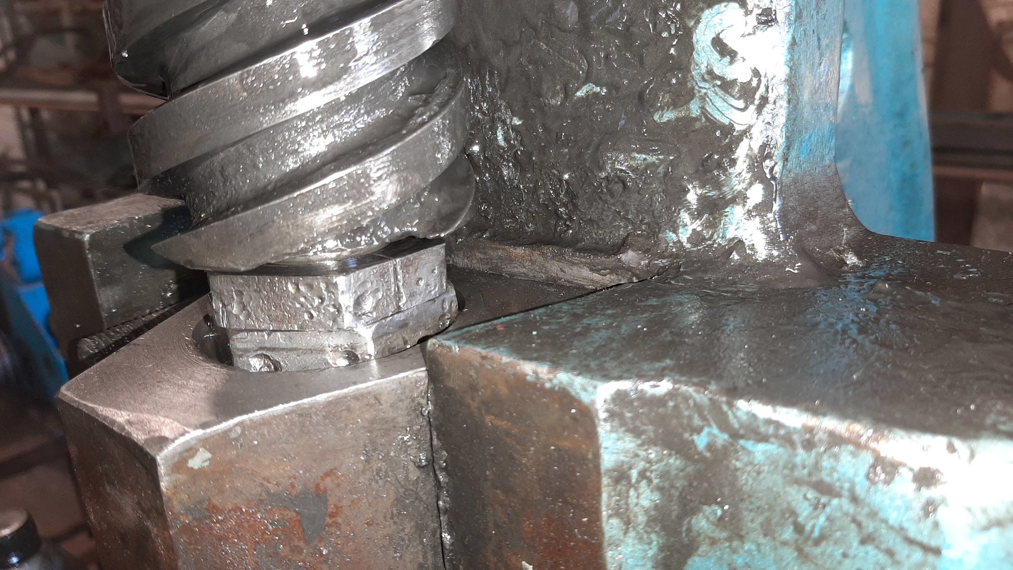

I bought a FJ Edwards No.8 fly press the other day which has quite a bit of backlash in it which I'd like to correct.
The top nut is the split collar and the bottom nut is the lock nut. I can get a little bit of movement into the split collar but only the tiniest amount of movement into the lock nut.
The lock nut is also a little recessed into the top of the ram, so I'm generally a little stumped for how to loosen it up.
I found a great little video on YouTube by a fella who restores them explaining that the top nut is the cast split collar and folks often break them thinking that they need to swing on that one to undo things when it's actually the bottom nut that you need to undo.
Does anyone else own a fly press by this manufacturer? Is your lock nut also recessed? Anyone with any pearls of wisdom as to how I can undo the lock nut?
I have posted pics below, then a link to a video I uploaded to YouTube, then the video I found of the guy who does the tutorial. Any help would be appreciated.
Cheers
